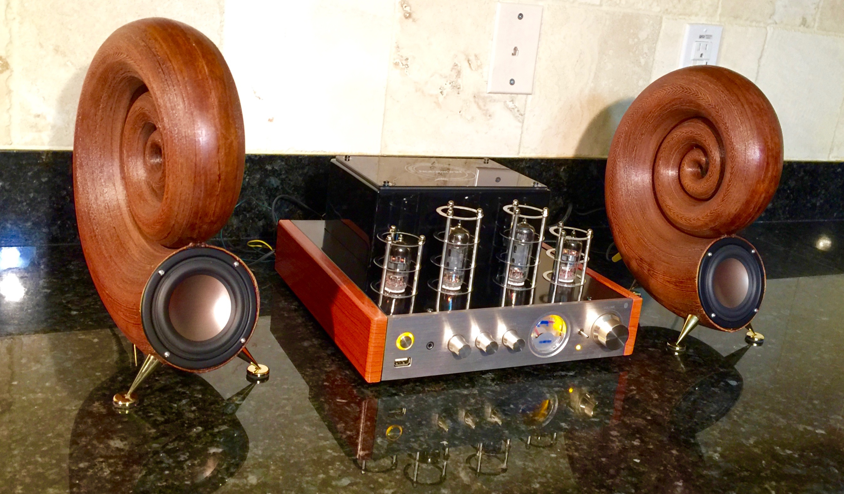

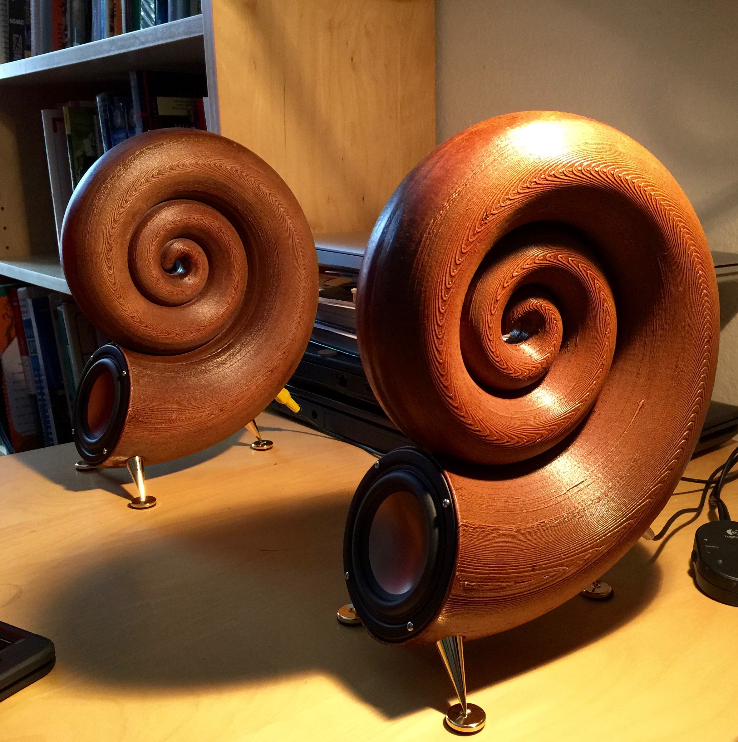

This is how they look once finished ... they sound as great as they look
Re: Akemake Spirula Speakers
And, if you pair them with a good, old, nice bulb-amp, then you got yourself an epic set!
