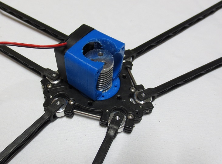

I have another last-minute dilemma. Right now I have a bunch of 30mm and 40mm fans to use with this hotend. Both of them work, and both are significantly quieter (and less 'vibratey') than the smaller 25mm fans used on other hotends. Both fit onto printed mounts on the heat sink of the hotend.
I can supply both types of fans and mounts for the first batch of hotends I sell, but I only have one printer and printing those three parts at a good quality level takes over 3 hours, which may limit me in daily sales. Do you guys have any suggestions for which one I should go with?
I'm leaning towards 40mm since it has better air flow.

Here's what the 40mm fan looks like on it;
It looks kind of bulky on the Rostock V1 effector plate, but it fits. The blue circular adapter part fits right into the rostock effector plate, then the fan shroud fits over it all. Nothing is loose and nothing rattles. The nice thing about printing this with trimmer line is that you can actually bend the entire fan shroud almost inside-out without breaking it. Plus it won't melt or distort from heat! I was messing with retraction settings when I printed the fan shroud so it has some blobs on it.

Generic Default wrote:Here's what the 40mm fan looks like on it;
I wonder if you could make it so it has a 40mm fan mount on one side, and a 30mm mount on the other?

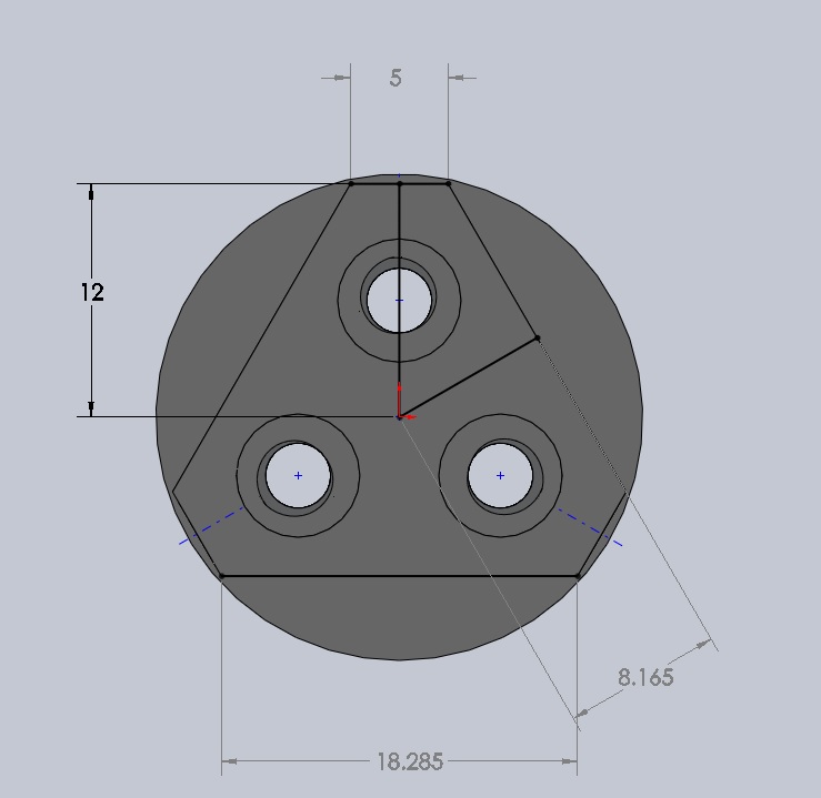

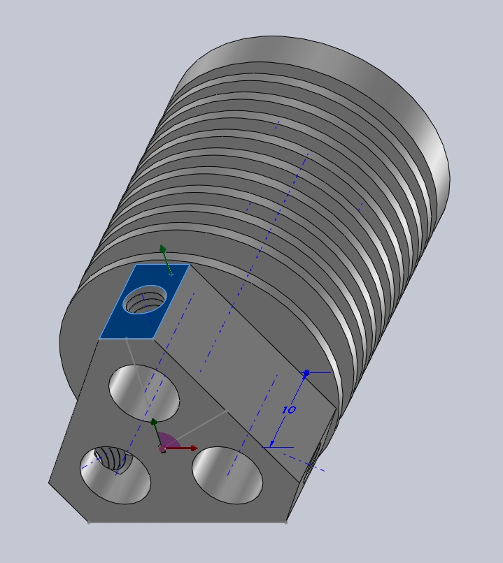

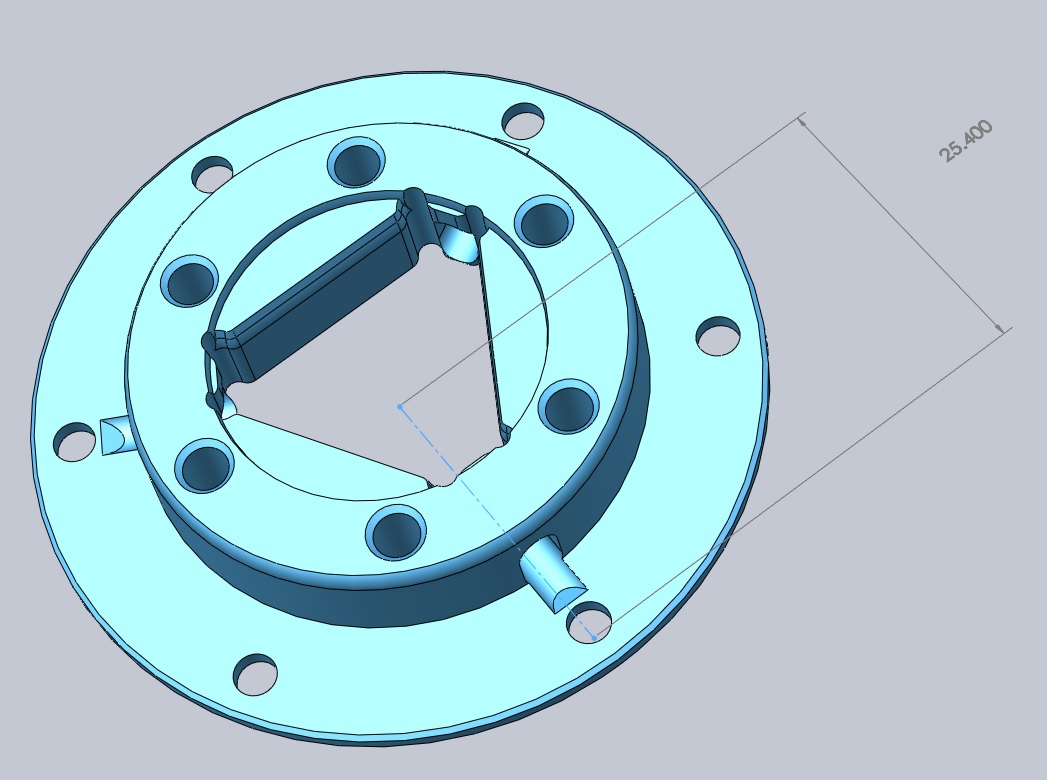

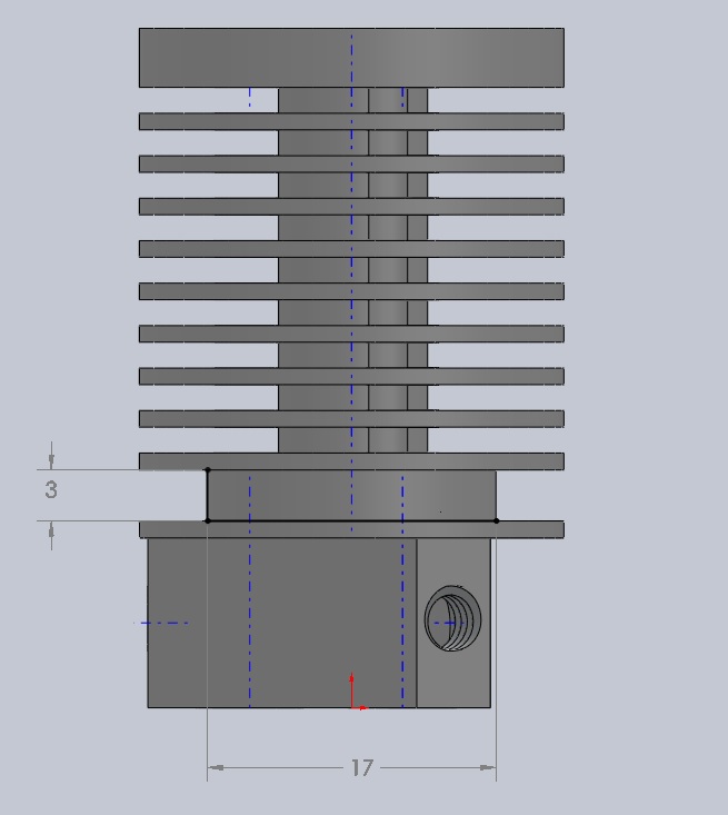

I'll post the mounting dimensions so anyone can make their own effector for the Tri hotend. I'm shipping the Tri hotend with a mounting adapter for the SeeMeCNC Rostock plate, but people with different or modified printers need to know this stuff to design their own mounts.
There are two mounting parts of the hotend. The preferred one is the triangular part at the bottom, since it is ultra rigid and easy to press fit without fasteners.
The second one is a groove mount above the triangular part. Both are shown below.

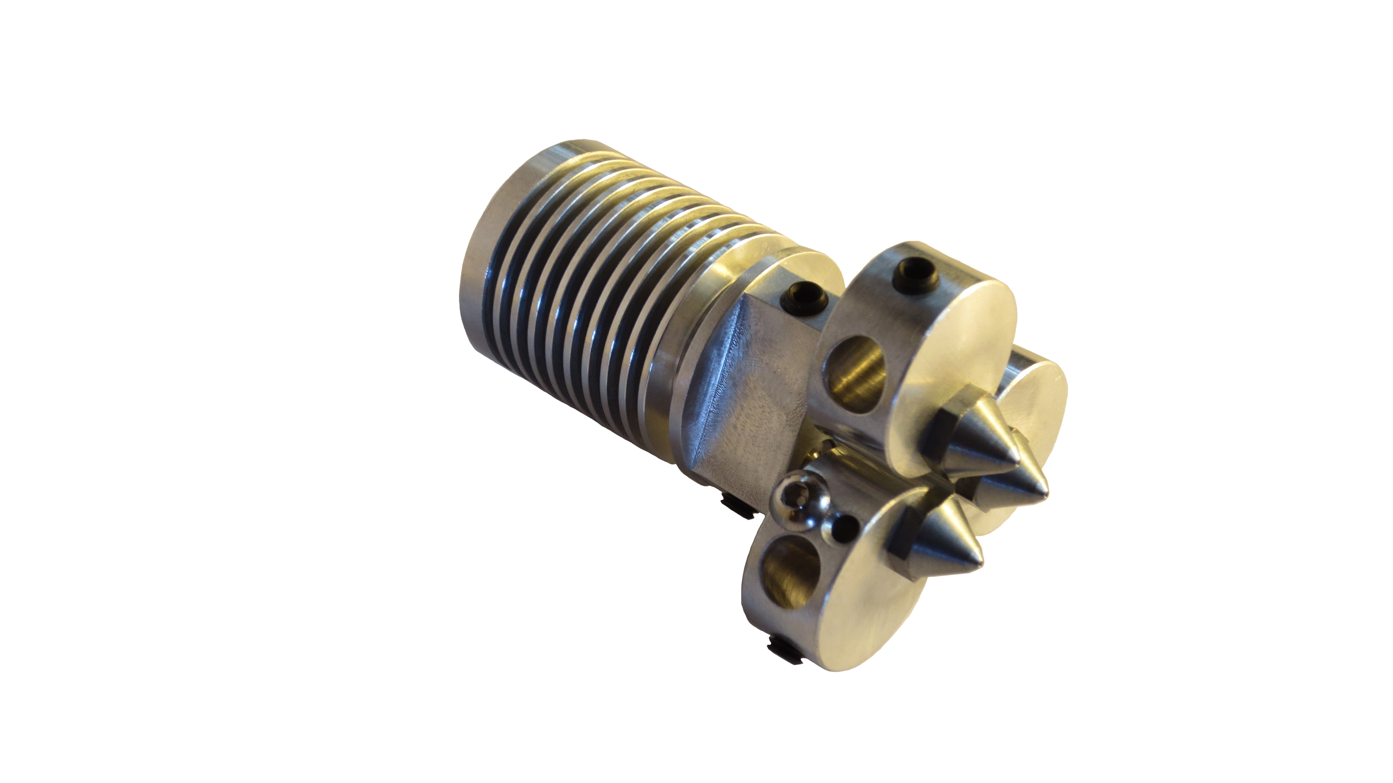

I'll let you guys speculate about the picture below. This is my permanent solution that will (hopefully) end all jamming problems with metal hotends for the future of 3d printing.
I will say that I filed for a patent on a few things related to this hotend, and just hotend technology in general. Some of you may remember a thread I started a few months ago about patents and open source stuff; I wanted to avoid IP earlier this year. The combination of aggressive patent trolls in the US and rampant [Chinese] copying of recent U.S developed 3d printer related stuff has convinced me to get patents on the things I invent. So while I'll go the traditional route with patents, I still intend to make my stuff open source for reprappers and makers in general.
Stuff is coming together and I'll give more details once I have some free time. For tonight this is all you get!
PS- I hope you like the results of my seven dollar product photoshoot! More pictures in the next few days.
