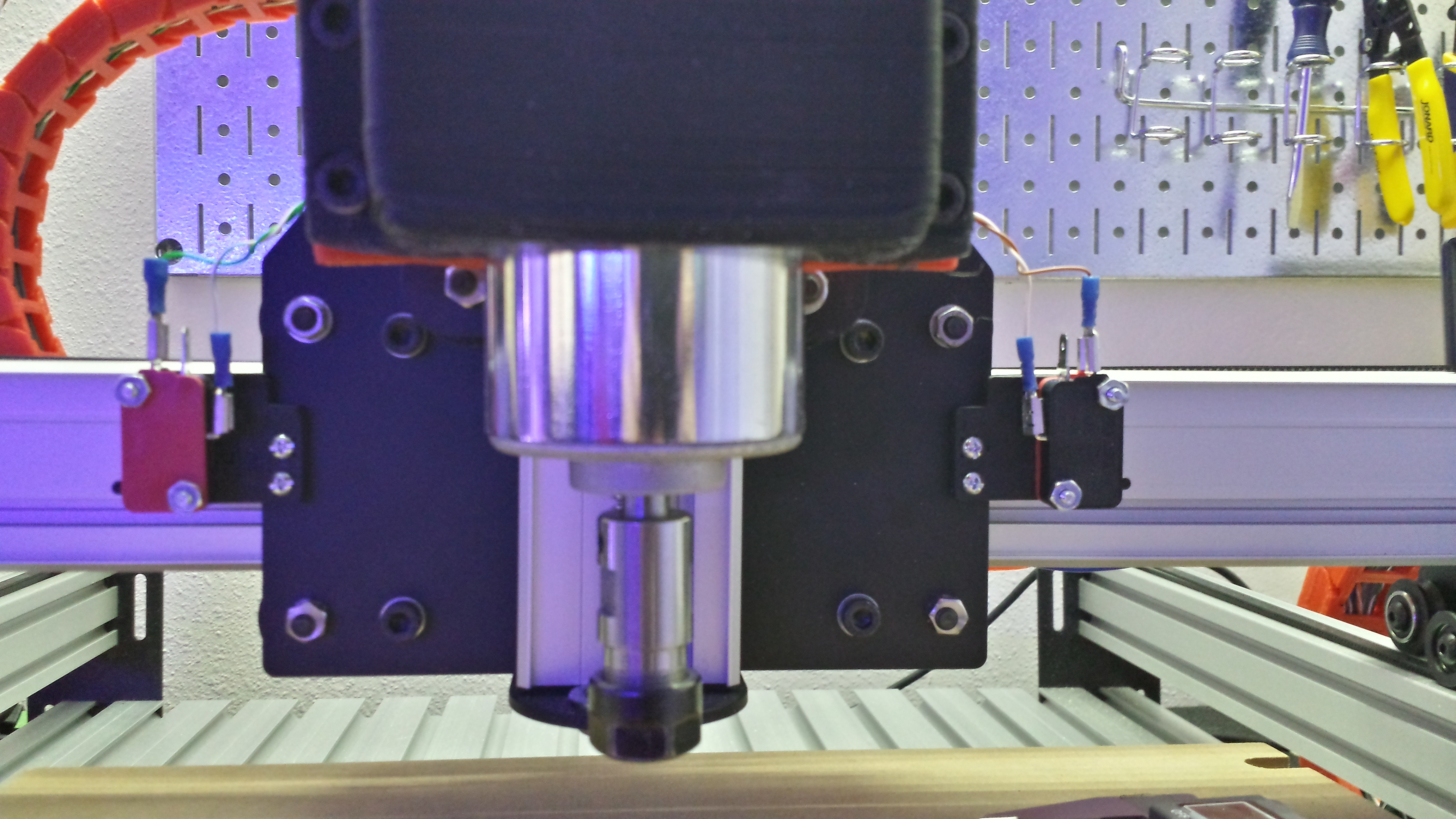

Could you provide a short tutorial on how you mounted the endstops? That has me baffled on that type of mill.

Sure!
I am using a Tinyg board https://www.synthetos.com/project/tinyg/ for my controller so it did come with built in connections and firmware for the switches. I currently have home and limit switches on the X and Y axis. I used the Max to print up four mounts to hold the switches. Most people mount their switches on the outside frame. I wanted mine on the gantry instead. Mostly that was to keep all my wires in one small part of the mill and not on all the corners with wires all over the place. I have not mounted the Z axis yet but plan to shortly. Doing so would mean taking apart the mill as I have an upgraded Z axis screw which is held both top and bottom (stock Shapeoko is open on the bottom end). I plan to mill all of these out of aluminum and anodize them when i have some time in the next week or so. Until then I only have the X and Y set up.
The Shapeoko gantry motor plates have a few extra slots cut in them and i used those spots to attach the switches. A few small #4 screws holds the thin mounting plates to the gantry plates and the swtiches then are held by 2 more #4 bolts. I have the mounting plates sized so the switch triggers just before the gantry wheels reach their end stop. The Tinyg has all the connections and firmware for this so it was then just a matter of running the wires (24g cat 5 cable pairs) through the cable chain and back to the TinyG controller. Once I told the Tinyg I had the switches set up, it just took it from there. Now if I issue a G28.2 X0 Y0 command to the Tinyg, the CNC mill homes out and is set for the next job.
I do have mine set a bit different though. I have mine home to top right instead of bottm left. I did this so I could have a clear work area by homing the mill. So I have space to place object being milled and also the mill is homed. I then send a short Gcode command to send it to front left and start my mill job. Works great for me so far.
Also already the limit switches have paid off.. Was up to late and sent a X axis command when it should have been a Y axis command.. It ran to the limit switch and shut down. not harm no foul. Love it! I used these switches also as they were on another CNC forum and worked great and are CHEAP! http://www.amazon.com/gp/product/B00DN7 ... UTF8&psc=1

This is the Y motor mount on the left side of the mill. My end switches are here as my right mount has all my terminal blocks mounted already and is crowded
This is the X Axis mount setup. Pretty much the same as the Y.
All of the switches are placed so that the mount or end plate at their end of travel triggers the switch. I found this to work fine so far. Some mount adjustments to them. So far mine work great as they are set at the travel limit of the mill.

travelphotog, thanks for the text and the pictures. Great stuff and I appreciate it.
