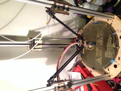

I bought the sensors and board from http://tridprinting.com. The sensors are also available from Digi-Key. I made the aluminum pieces on my lathe.

Which dimensions are you referring to? Also after taking a good look at your setup, how is the bed attached to the base? Looks like you have it set up so 3 of the corners of the bed screw into the top part of the FSR mounts and then 3 screws go into the bottom part of the FSR mounts through the top panel of the base? Is your bed actually securely mounted or?

Nylocke wrote:Which dimensions are you referring to? Also after taking a good look at your setup, how is the bed attached to the base? Looks like you have it set up so 3 of the corners of the bed screw into the top part of the FSR mounts and then 3 screws go into the bottom part of the FSR mounts through the top panel of the base? Is your bed actually securely mounted or?
Things like PRINTER_RADIUS and DELTA_DIAGONAL_ROD make a big difference. The software needs to know the nozzle position correctly (aka z-probe) to be able to calculate the plane of the bed.
Have you looked at the datasheet for the FSR sensors? The bottom is a pressure sensitive adhesive. On the top I use double sided tape (high temperature rated meant for heatsinks). I don't know what you mean by "securely mounted", I guess that's up to your interpretation. But it is not possible to hard bolt the bed down with the FSR sensors, that's the whole point of the pieces I made...

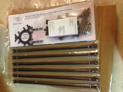

They came early :DDDDDD

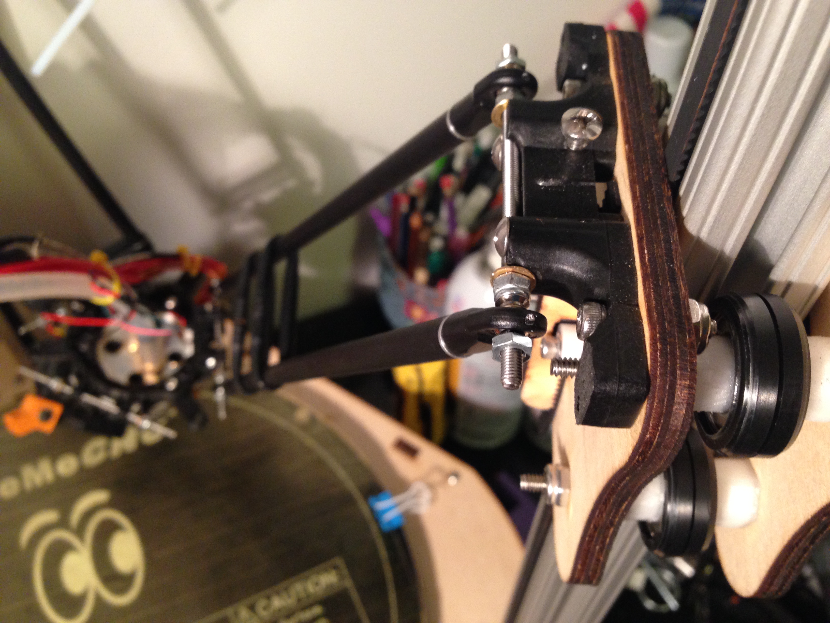

It took me 4 hours to do the upgrade, but a whole night, 60 pictures, and an aching back (I'm too young for an aching back :/) later its finished!
Finished!
Finished!

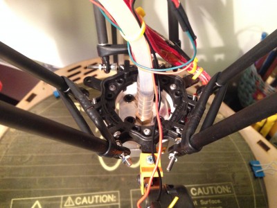

Close up on the Effector

Psst! Dude! Your effector platform is upside down.
Just sayin'. :D

Post by Nylocke »
That's intentional, the Kraken mounts better that way :P
