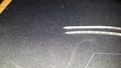

I took your photo and attempted to scale it to the E3D drawing and then superimposed the images. If I were to hazard a guess, I would say that your Bowden tube is not completely seated into the top of the heat break.

				by Tinyhead
				That plug is coming from much farther inside the hot end.  Feels like it's near the heat break.

				mhackney wrote:Make sure there aren't any burs.
I tried to be very methodical with the finish of the drilling.  Used a magnifying eye piece to make sure I didn't end up with any burs as I know they can be a huge problem.
I used this (
http://www.thingiverse.com/thing:197152) and tossed on my 40mm high CFM fan instead of the stock one.  I also wrapped the heater block in kapton tape in order to try and keep the heat closed in for the tip in case 626Pilot is onto something.
I went from my plug (top filament) to the one on the bottom after the changes.
			-  One on the bottom is after the changes
I tried moving the filament in and out, stopping, going slow...  I couldn't get it to jam at all.  I'm going to try a print and see how it goes.

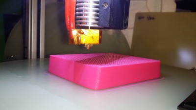

Length: 1.6mm, speed 20mm/s.  This is something I'm going to be toying with once I get a print with lots of retracts.  I just wanted to see if I could keep the hot end extruding for now.
I came downstairs to my printer this morning to this:
			-  Printing in the air
BUT!!!  Then I look up to the top and see this crap.
I didn't have time to restart the print this morning, but I have high hopes!  It was putting down amazing lines and had already run longer than I've ever got it with the E3D.  Again though, on this print, there probably wasn't a single retract except from the loops to the print.  Still, when I was playing with it manually, it was working like a dream.
