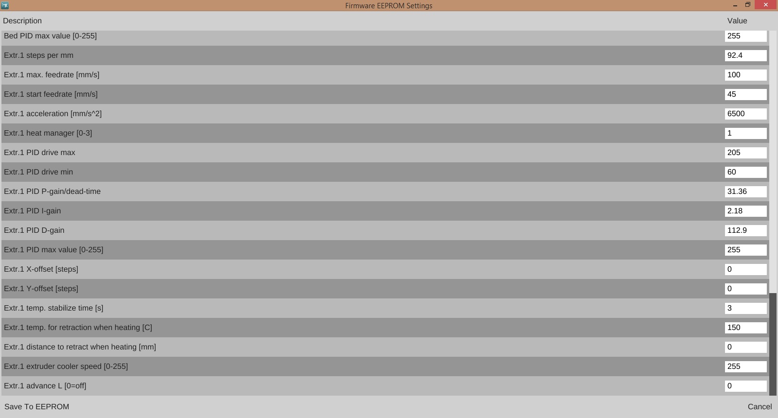

Nylocke wrote:Is the output on the RAMBO actually supplying the heater with power? What are your heating settings (PID Max, P, I, D, Max PWM power, etc)?
max temp was changed from 247 to 290, min defect was -10, max defect was 300
pwm was 255
any other numbers you want me to screen shot in matter control?

All the other heating variables, the max temps don't matter. Drive Max, PID Max, etc

The configuration file is irrelevant when talking about these values. They are overridden by EEPROM. Can you post a screenshot of your EEPROM settings.

My mistake, also I accidentally uploaded the config file from the outdated firmware earlier so I deleted it to avoid confusion, this screencap here should have all the settings from the new upload:

Those settings all look fine. Is the connector on the RAMBo actually delivering 12V to the hotend?

Extr.1? Unless Mattercontrol is changing the labeling, Extr.1 is for a second extruder. Extr.0 is for the primary extruder.

Mac The Knife wrote:Extr.1? Unless Mattercontrol is changing the labeling, Extr.1 is for a second extruder. Extr.0 is for the primary extruder.
Ok, so could that be the reason? I am using the latest version for what it's worth.
Nylocke wrote:Those settings all look fine. Is the connector on the RAMBo actually delivering 12V to the hotend?
No idea, how do I check that?

Do you have a multimeter? Turn it on volt mode and touch them to the pos and neg

It reads 11 or -11 depending on the orientation of the black and red

11 exactly? Thats a bit low, but it shouldn't make too much of a difference. Have you checked the connection to make sure you have good continuity to the heater cartridge? What is the resistance of the heater cartridge? It should measure around 3.6 ohms if my math is correct (40 watt cartridge @ 12V, W=V*I, W/V=I, 40/12=3.33333A, V=I*R, V/I=R, 12V/3.33333A=3.6ohms).

It's a 25 watt cartridge, but after all of that hullabaloo it was damn sloppy connection to it that led to all this, I just had a convo with JJ and touched my thermistor to my heater cartridge and told the printer to heat up and did....of all the reason for it to fail, that was why :/
