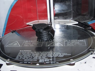

ok so i have a new hot end, leveled the printer and restarted printing. now i am back to an old problem that i still cannot understand. the attached picture tells the tale, i was printing a small owl as a simple can i print test and at 71% it skipped about 1/4" over. i was not there so my question is what could cause this because this happens to me all the time and i would love some ideas as to what it could be.
thanks
IMBoring25
Posts: 616
Re: printer leveling
Post by IMBoring25 »
There are several possibilities for that if you don't see it happen. Either one or more motors skipped or something skipped mechanically.
Motor currents could be too low and not driving enough or too high and leading to overheating. Something could be binding in the mechanism. Cogs or belts could be slipping. It's also possible the nozzle is hitting the print, either due to curling or a blob of ooze, and causing the motors to skip steps.

well back to problems again, it works its level but anything over 1" tall it skips and the print goes to hell so i have checked the everything i can think of and no idea so my only idea is the belts are too worn has anyone had this happen??
Posts: 1561
Post by Xenocrates »
I recall Mike had an issue sorta like this, which he solved by flipping the belts over. Wasn't much visible wear IIRC, just slightly rounded teeth and softening profiles on them.

finally found a solution on accident. i was working on turning the parts from my rostock to a 3d printed reprap and i discovered that one of the 20 gear teeth provided by see me is actually an 18 gear tooth. this was in all likely hood the entire problem with my rostock, cannot level the bed and make anything work with the wrong number of teeth on your belt gear. once i changed it out the reprap worked so i may have to go back and revisit the rostock this weekend, see if that may fix its problem, for now i am back to two printers working even if one is a kludge, food for thought, somebody else may have gotten a bad gear for their stepper on the way
Posts: 1561
gaexcalibur wrote:finally found a solution on accident. i was working on turning the parts from my rostock to a 3d printed reprap and i discovered that one of the 20 gear teeth provided by see me is actually an 18 gear tooth. this was in all likely hood the entire problem with my rostock, cannot level the bed and make anything work with the wrong number of teeth on your belt gear. once i changed it out the reprap worked so i may have to go back and revisit the rostock this weekend, see if that may fix its problem, for now i am back to two printers working even if one is a kludge, food for thought, somebody else may have gotten a bad gear for their stepper on the way
