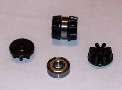

The idler bearings now have new injection molder spacers.
- updated idlers
They snap into the bearings and use the same screws as the original metal spacers

I just took delivery of a kit today and I received the metal spacers. Perhaps I got the last of the metal ones?
