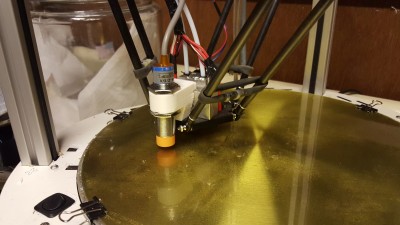

so I have a bit of a problem
I assembled my z probe and checked that it is working.
I downloaded the latest ver of the app, hit advenced and choose Zprobe.
I calibrated the hot end to the bed on a paper and got 397.78 mm.
my z probe is about 30 mm below the hot end.
do I have to change any thing eles?
I hit A.I. calibrate.
T head move done and untill if presses the probe the it moves up and on the fasr way down it hit the glass.
whay am I doing wrong?
thanks

try to change the z start height to something like 25 if its very decalibrated so it starts from higher to check the probe heightduvdev wrote:so I have a bit of a problem

ok got my fsr working. I run thru the first set of calibrations. it runs thru and touches all the points and runs back to the top. on the second time it crashes into the bed. I have 325 mm arms...
this is the console:

looks like its trying to set Z to 40 mm above bed, but its crashing. I have20 T pulleys. I wrote my Zheight to eeprom with the LCD screen.

Well I got my inductive proximity switch ($4 from amazon
 ) installed and working as a Z probe, and I think I have the calibration working... sorta....
As far as i can tell, the probe is functioning properly, plus it can ride along during prints since it is ~1.5mm above the nozzles
I think i got it to calibrate decently, within whatever default tolerances. And my prints seemed to improve quality as far as smoothness and such.
Couple questions:
First things first, I need to redesign my sensor mount and/or platform since when it is extremely left or right the arms will hit the mount if i have the "build diameter" in opendact set where it realistically should be, currently i am using 150mm as my diameter. Does the build diameter box just tell the magic program what diameter circle to probe points on? such that obviously spreading the points out further will give a more accurate calibration to scale the movements off of. Or am I basically just making it look like its doing fancy stuff for science and not really accomplishing what I hope? haha.
My probe switches approximately 1.4mm from the nozzle, (i.e. when the probe is triggered, the nozzle is at 1.4mm above zero.) can I adjust this with a probe offset? I tried simply putting 1.4 or -1.4 in the probe offset in the firmware or in the program advanced settings, but I'm not sure if by putting the -1.4 the firmware and/or program was like ERR-RORE. ERR-RORE. DOES NOT COMPUTE. and at one point set the arm length and horizontal radius to 0 and just kinda gave me the finger until I reset the eeprom values to 325 and so on. Currently I just put all the probe height offsets to zero and let its do its thing, and then set my z-height with a feeler gauge since it thinks zero is 3+mm in the air.
Is this making sense or am I reinventing a dead horse mid-stream?
It seems like I'm close to having it working all hunky dory but I'm just not sure if what I'm guessing at what settings impact what effects the outcomes the way i think they do.
So, when i open the program, i enter build diameter, arm length, com port, connect.
open advanced, change to z probe, zero out probe height and fsr plate offset,
then i hit set variables - do i need to do this? like its an "apply settings" sort of button?
then i hit calibrate, and it homes off the top endstops, and travels down at probing speed (5 mm/s) until it touches once, and all the way back up, then the second and so on times, it rapid travels to my "z-probe start height"
does the same thing if i hit calibrate, or A.I. or H.A.I. doesn't seem to make much of a difference.
Since my sensor is approx 50mm (y-) away from the nozzles, i put that offset it so that the point circle is centered on the plate. this causes it to move to point, then compensate for my nozzle 1 offset, and then the 50mm probe offset, (at least this is what I'm guessing its doing) not a big deal, I'm just curious if it's like, oh no I definately have 3 offsets that are conflicting and fighting each other.
I would attach the console text but I don't want to post a mile long of it if its totally useless if I'm doing something way wrong, but if you guy's have any pointers for me I would be very grateful!

i had problems getting the calibartion to work using a probe with an offset it just didnt calculate correctly maybe i did something wrong aswell:OCaptainMerica wrote:Well I got my inductive proximity switch ($4 from amazon) installed and working as a Z probe, and I think I have the calibration working... sorta....

Damn, cant get it to work... -.-
-clean eeprom
-flash repetier
-build diameter: 280 diagonal rod:269
-z-minimum type: z-probe
-pause time com: 1500
-rest default
-test zprobe = working
-hit calibrate
it goes down until the probe touches the bed, then it goes up again and stops right before the end-stops

I was able to get mine to calibrate quite nicely, i lowered the accuracy tolerance for the height map to .04 i think i started with, just to see if i could get it calibrated successfully at all, and it did. so i went to .035 or so, and did it again. But just going for it with the default .025 (i think it is?) it seemed to chase its tail and end up in BFE. But I think this may be a large part due to my print bed being a PEI sheet directly on the aluminum heat spreader, on top of the heater. so the actual flatness of my bed may be off, and i may not have my prox switch set correctly.
I struggled for a while and kept having to manually change firmware back to defaults for arm length, horizontal radius, etc. as it seemed to want to place ridiculous numbers in there before giving up or erroring out. i.e. 500+ mm arms, while i have 325mm TL CF arms.
I just changed to .9 steppers with 16T pulleys so i will have to do it again once I'm up and running, just need to figure out what i missed in the firmware for steps per mm calculation.
I seemed to have best luck with my inductive sensor with only the Y offset, i left the z height offsets at zero and manually set my height after, otherwise i think it was compensating (or trying to?) for the height offset in the math and was generating some 1.21 gigameter offsets.
I will hopefully be at it again tonight so I will post any updates.

So wait, quick question, I have an inductive prox sensor on my platform that "switches" when it "probes" the bed, I have been using the "z-probe" setting. I have the sensor wired in as a "Z_min endstop" and still have all my upper travel endstops in place and unmodified. Should I be doing something different? like, by telling it to use z-probe vs FSR, while still being equipped with endstops, is this contributing to adverse side effects?Other than that all you will have to do is use the FSR setting for the z minimum type
- RollieRowland
 - Posts: 226
 - Joined: Fri Jul 17, 2015 5:30 pm
 - Location: U.S.
Re: OpenDACT(Delta Automatic Calibration Tool) - For Repetie
Well if I were to assume the issue is coming from the probing choice, then it would most likely be that the Z-Probe method has an error - which I am fairly sure it does. You can use the FSR setting, but you will most likely have to modify the FSR offset to find your specific offset - i.e. the distance from the bed that it triggers. Or just calibrate with the default and set your zheight manually after the calibration has finished.CaptainMerica wrote:So wait, quick question, I have an inductive prox sensor on my platform that "switches" when it "probes" the bed, I have been using the "z-probe" setting. I have the sensor wired in as a "Z_min endstop" and still have all my upper travel endstops in place and unmodified. Should I be doing something different? like, by telling it to use z-probe vs FSR, while still being equipped with endstops, is this contributing to adverse side effects?Other than that all you will have to do is use the FSR setting for the z minimum type
				CaptainMerica
 - Posts: 64
 - Joined: Tue Sep 01, 2015 10:23 am
What I did was brought the platform down to the bed, and adjusted the sensor so that it trips when the nozzle touches, such that the sensor is theoretically zero with the nozzle. So you think I should try the FSR option when I get home from work?
						- RollieRowland
 - Posts: 226
 - Location: U.S.
Yes, try the FSR option and let me know what you find out.CaptainMerica wrote:What I did was brought the platform down to the bed, and adjusted the sensor so that it trips when the nozzle touches, such that the sensor is theoretically zero with the nozzle. So you think I should try the FSR option when I get home from work?
