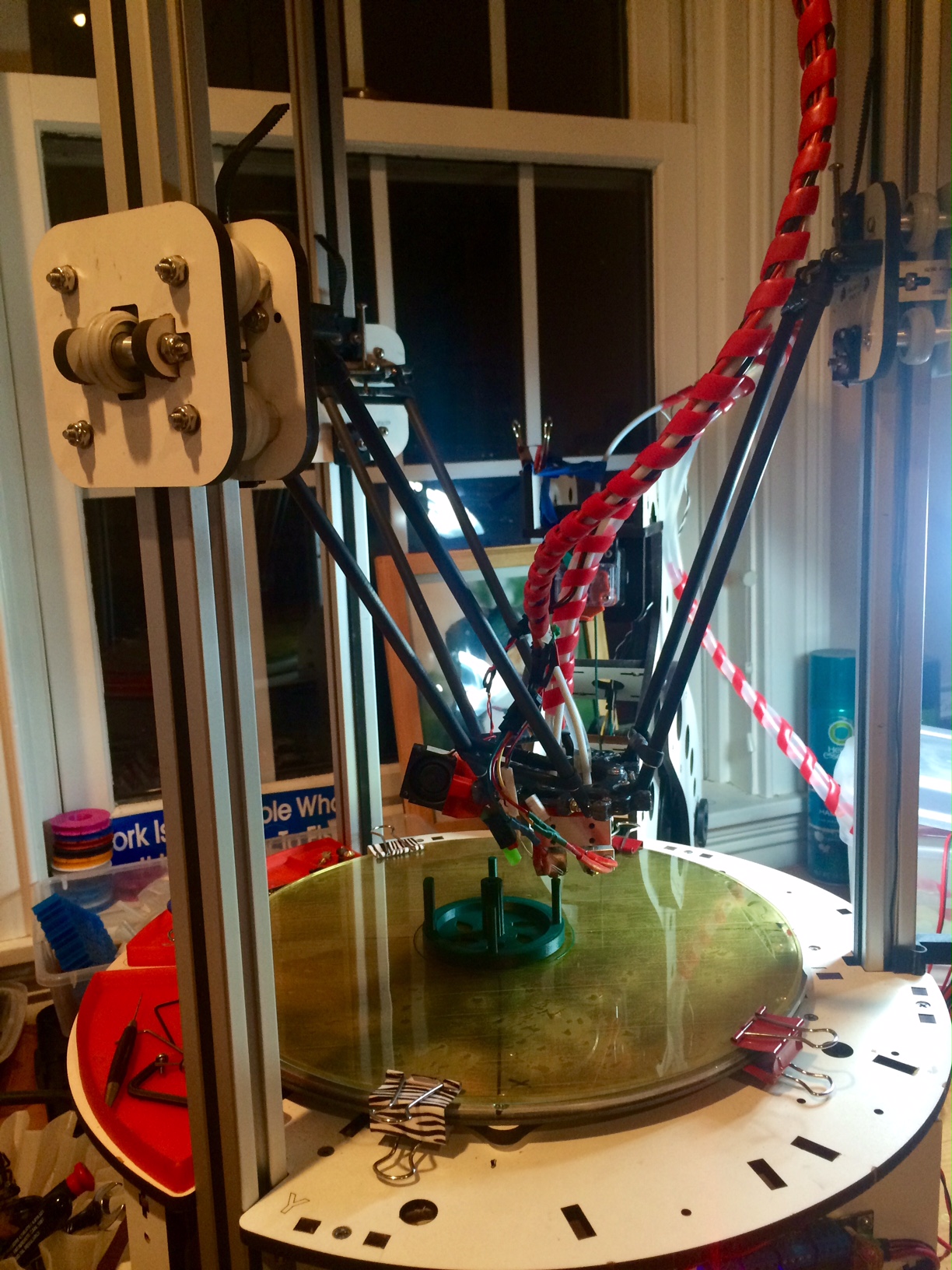

Re: PEI print bed surface experiments
I took this photo a few minutes ago for a gent on another thread. But I realized you can see the PEI surface quite clearly (click the photo to see the high res version).
