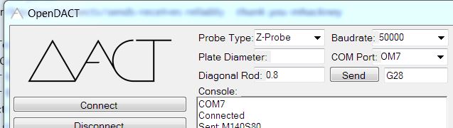

by terabyte
I would appreciate if someone can confirm defaults.
So, to get it working properly, I need to enter starting parameters: DiagonalRod = 290.8 and PlateDiameter 280? I know that 290.8 is the correct value, but I am not sure about plate diameter is it 280 or is it 310, or is it the diameter where I want the calibration to do the tests? The problem is that I cannot see the default to begin with
The screenshot shows that the fields are "empty" but the numbers are just so far to the left that the first three numbers are invisible. I have Win7Pro US/English, no problems obviously with other apps.
Although I am sure I will have more questions, the last one for now, why does it need to change steps/mm? I am sorry if it has been asked before, but it is not so easy to find or understand for a newb:). My understanding is that it only affects scaling.
Thanks.
Re: OpenDACT(Delta Automatic Calibration Tool) - For Repetie
Posted: Sun Feb 07, 2016 2:41 am
by magicmushroom666
Diameter is just the circle of cal points used. I go for a safe 200mm which I think is the default too.
Posted: Sun Feb 07, 2016 5:15 am
by terabyte
Thanks magicmushroom666,
that makes a lot of sense, but I just wasn't sure. After checking my bed with digital indicator, I know that that there are some second order deviations up and down. So, unless I am printing something really big, it would make sense to calibrate for a smaller radius, although I have calibrated today at 288mm just fine, but area close to the center was not perfect.
