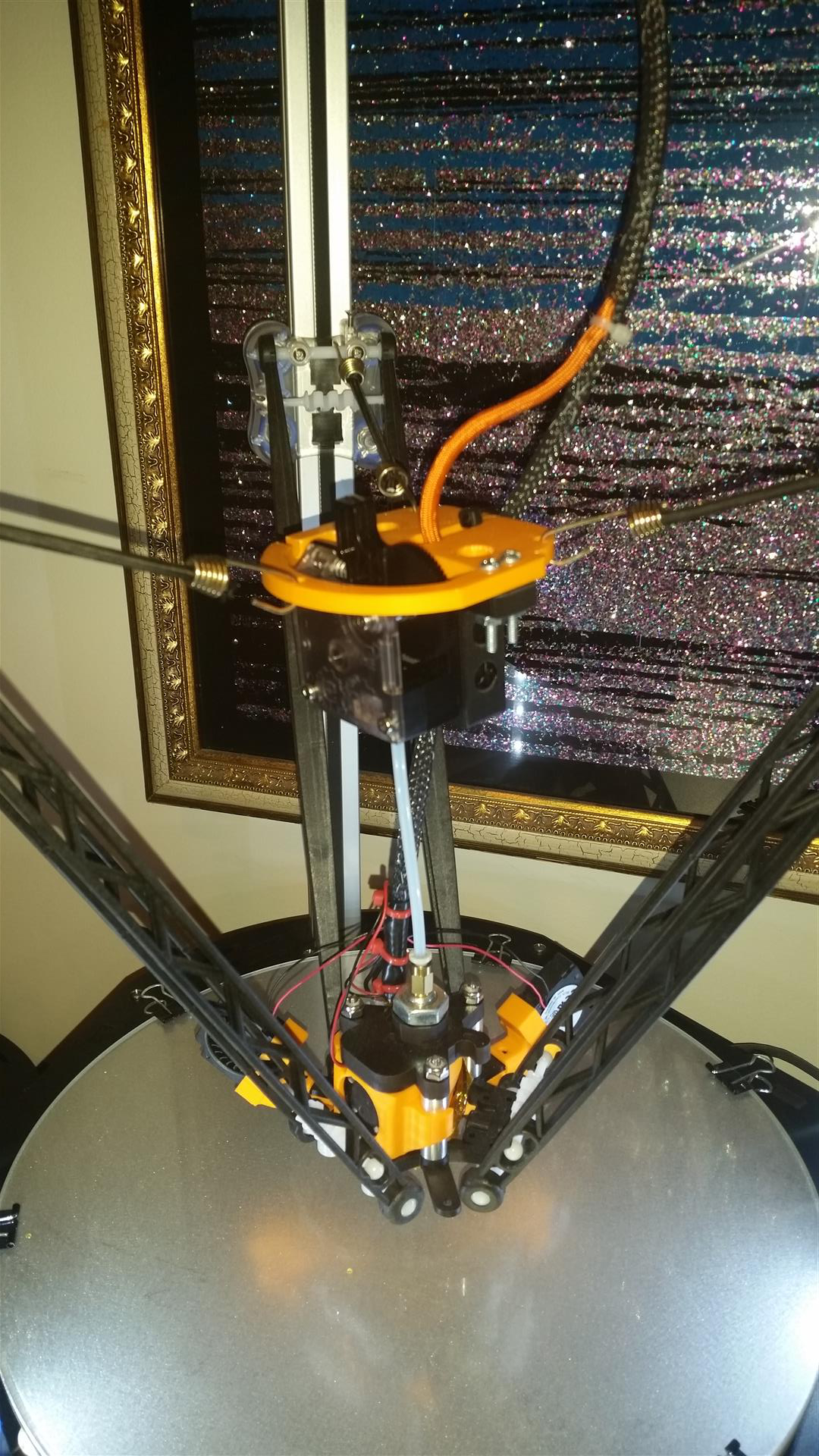

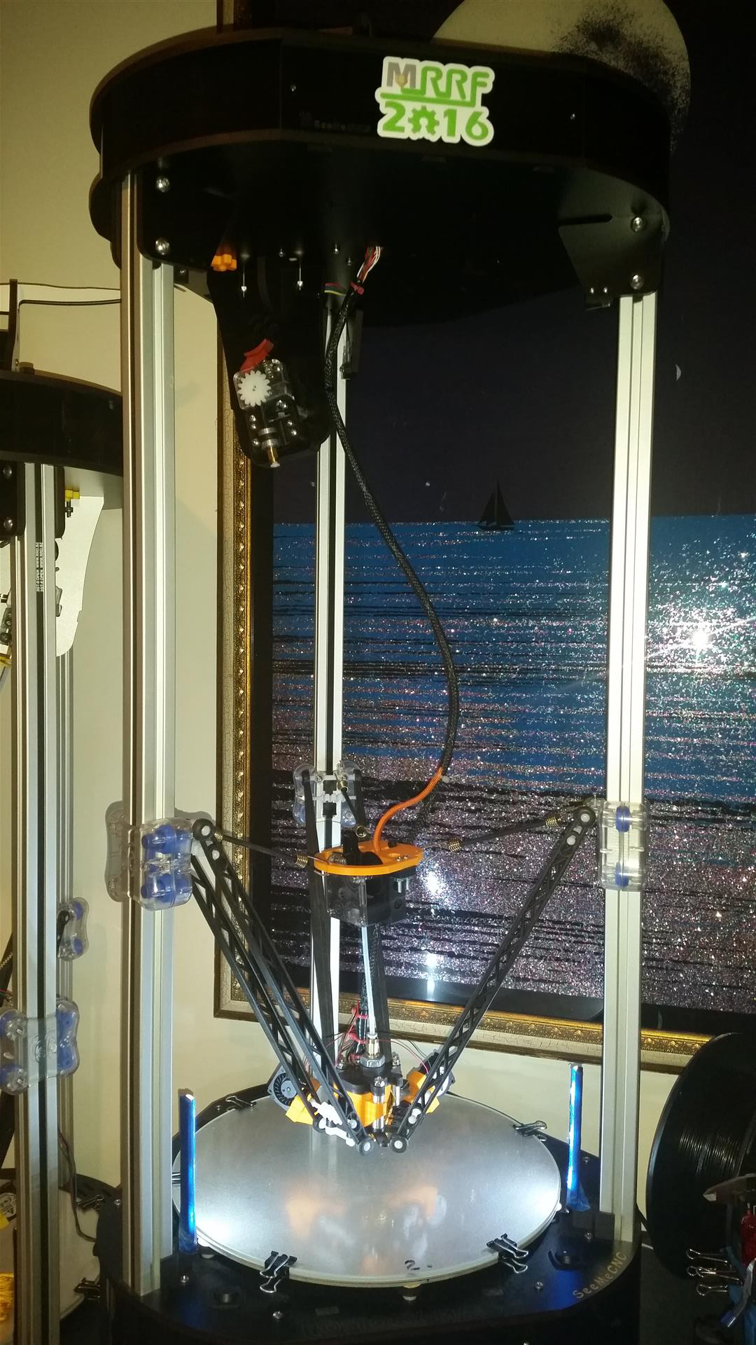

Here are some images of the Air-Struded Titan with a 20cm Stepper.  Will post more data after some calibration and test prints.
Thanks to all for the continued assistance!
