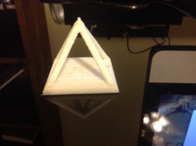

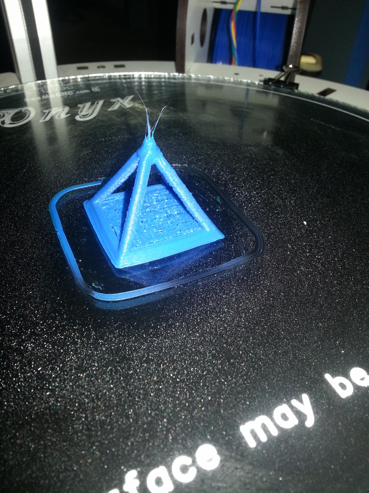

Hi, this is my First Functional Print on Rostock Max (using ABS plastic)
[img]http://www.miditec.com.mx/files/DSCN0977.JPG[/img]
[img]http://www.miditec.com.mx/files/DSCN0979.JPG[/img]
[img]http://www.miditec.com.mx/files/DSCN0980.JPG[/img]
and I would like to someone help me with the values of the delta, because when I print something I get it smaller.(i make some modification on that) and the lines are'nt lines, they are a litle bit curby
I modify the EPROM and the configuration file, and here the configuration file
http://www.miditec.com.mx/files/Configuration.h
I'm using the Repetier firmware 0.82.2 on the Rambo board 1.1b and Repetier-Host 0.85b
Help pleace, sorry for the big images

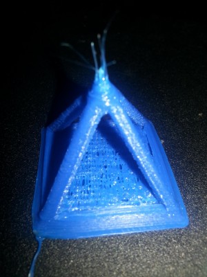

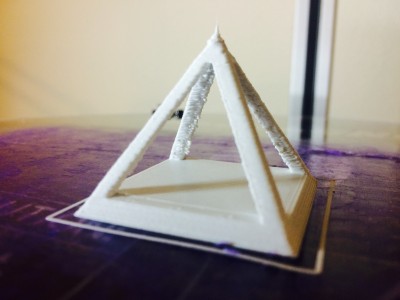

Just tried this today to see if my new/hybrid stock hotend + EZ struder would print this. Results are fairly good. 230c ABS

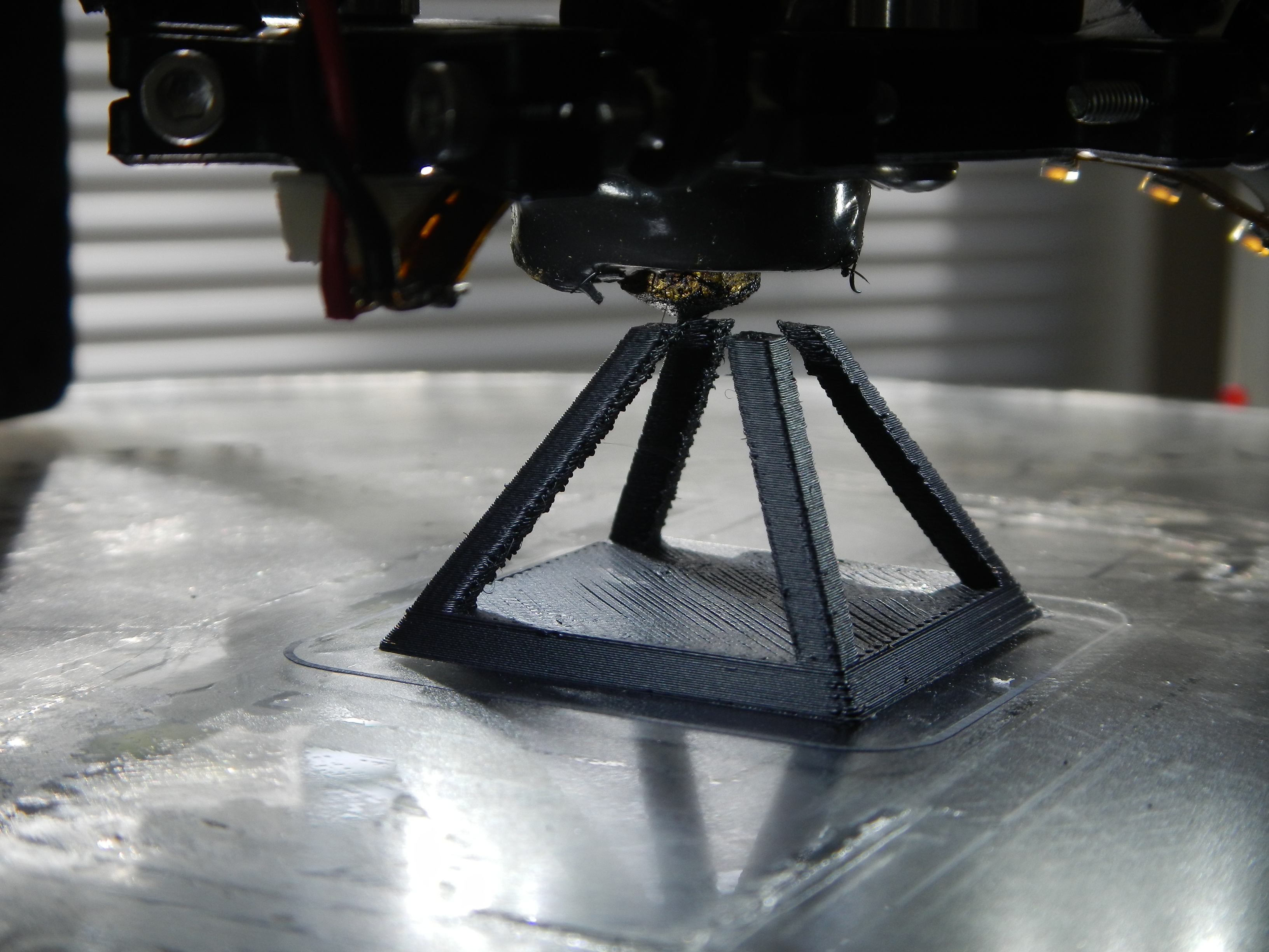

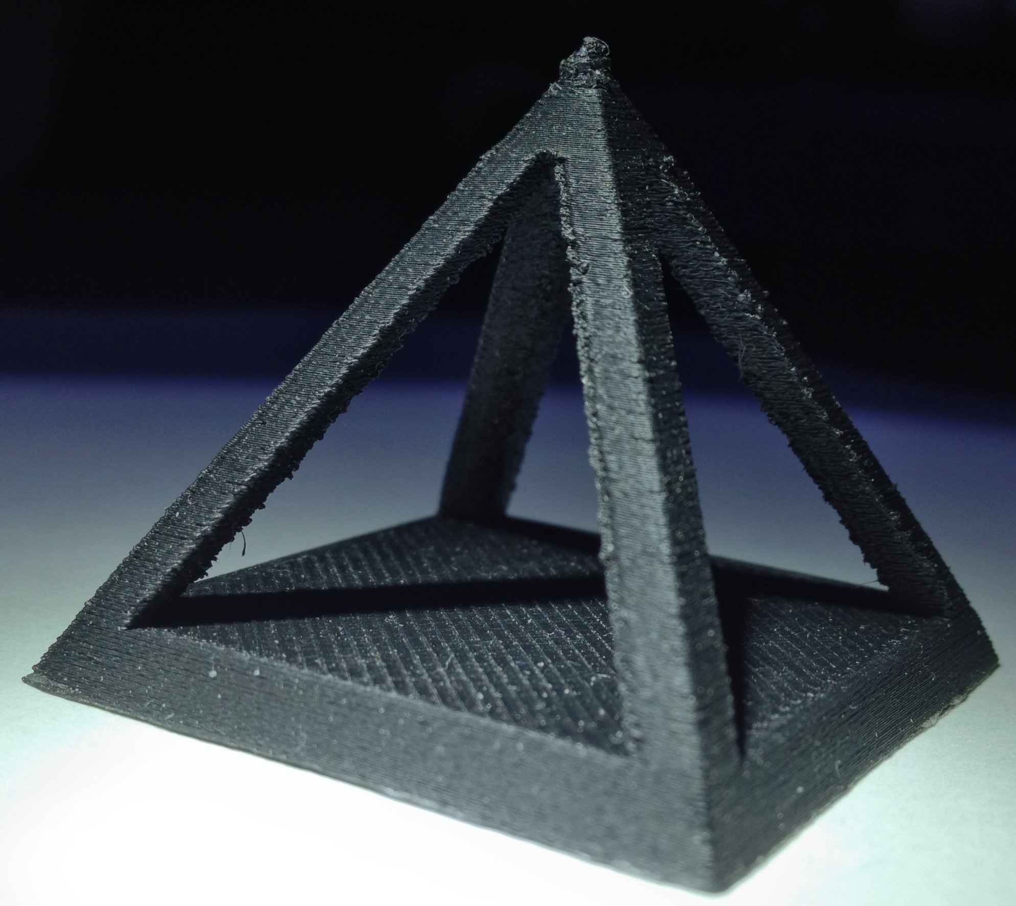

My first submission with my new mods... Printed in black 1.75mm ABS!
KISSlicer
230*C
.15mm layers
single perimeter loop
hollow
1mm z-lifts
6/6 suck/prime
9mm wipe
30mm/s
Still having some issues with filament slippage (using EZstruder) as can be seen in the base of the pyramid, but turned out ok overall.
120mm part cooling fan, which I know is insanely large but I wanted to try cooling and it definitely makes a big difference. Long ago I swapped out the original small power supply (because my LEDs were flickering) with a 750W power supply. Resolved the LED flickering, and now I have ample supply for more extruders as well! Long story short I pulled the 120mm fan from the old power supply and used it as a part cooler fan.
Another thing I think helped was the addition of the carbon fiber arms with ball joints, I used to have infill (and other) issues with the original ones.

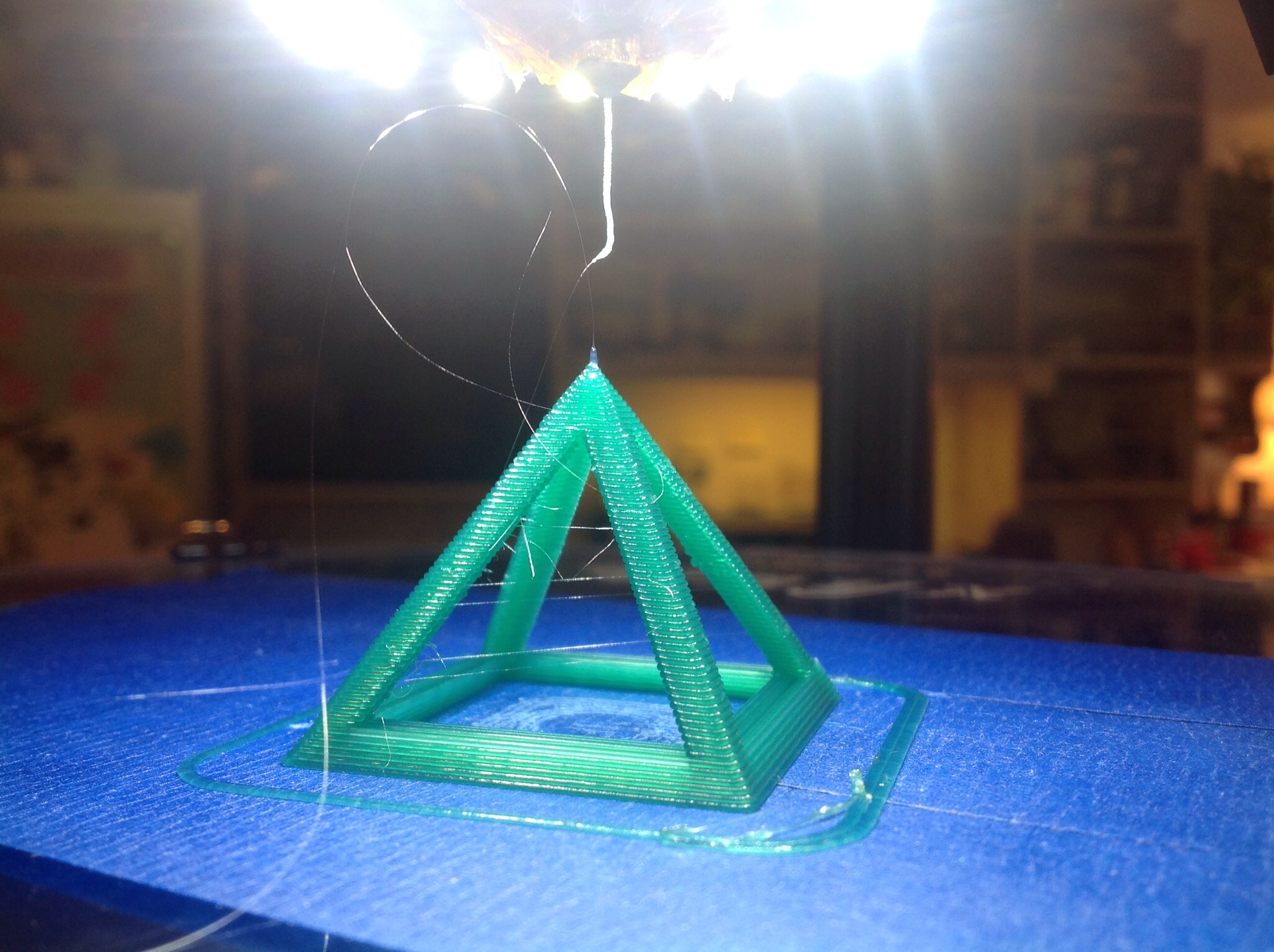

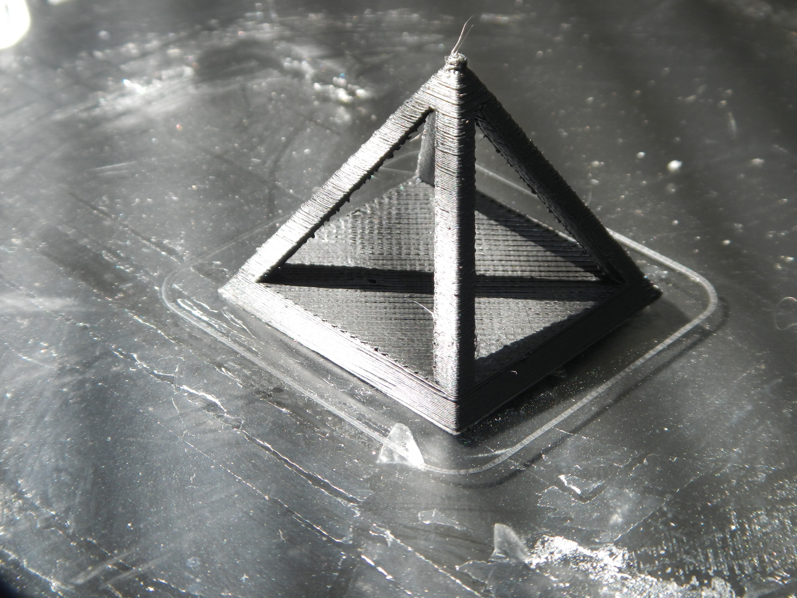

First attempt at the pyramid, would appreciate suggestions on how to improve it.
Using Repetier v0.90b Slic3r 0.9.10b, hotbed 100C and hotend 230C. With 1.75mm ABS (210-250C, bilbycnc.com.au).
Fill density - 0.2
Pattern - rectilinear
Top/Bottom Pattern - rectilinear
Extrusion Multiplier - 0.9
Currently no fans.
I think the next attempt I'll drop the hotend by 5 degrees.

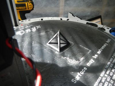

Black abs
Kiss
.1 layers
Kiss
.1 layers

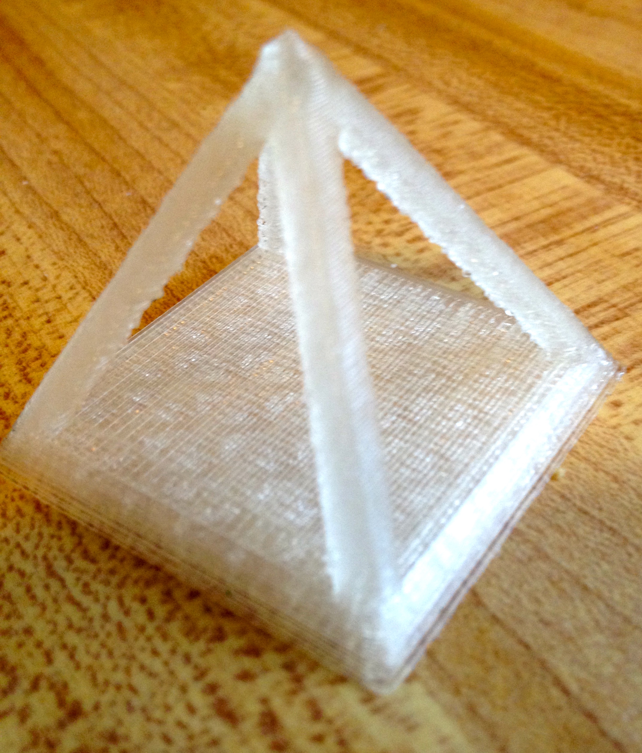

so here is mine... im actually really dissapointed... the close up does make it look worse, but i had a little stringing, and the blob on top...
the outside edges look REALLY good, but the inside are a little off.
wondering where to touch up... i think i need to work on the retraction piece of things.
edit : it did not peel up and deform the bottom right corner, its just sitting awkwardly on a piece of paper
