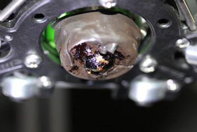

Char on the Nozzle
Posted: Tue Jul 09, 2013 2:35 am
by kbob
My nozzle has a lot of charred ABS on it. Is this normal? Some of it is flaking off and getting stuck in my prints.
If you clean your nozzle, how?

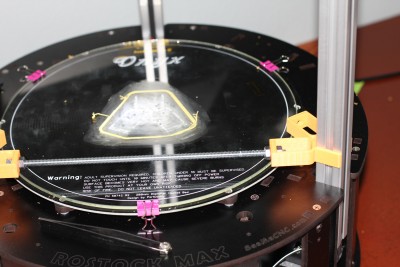

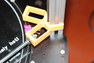

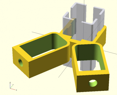

Tower Alignment Jig
Posted: Tue Jul 09, 2013 3:53 am
by kbob
I've been designing a jig to align the MAX's towers. I posted an OpenSCAD drawing of a draft version several days ago.
Here is the fifth iteration. It clamps onto the extrusion (lightly). It has a hole for a 1/4-20 threaded rod. With nuts on both ends, I should (in theory) be able to precisely adjust the distance between any two towers.
One brace/jig/clamp.
Here it is attached to two towers.
What were The Two Towers, anyway?  Minas Tirith and Barad-dûr?
Here's a closeup. There is a little tab that fits into the extrusion slot for alignment. You can see the two nuts that position it on the rod. The rod is pointed straight at the centerline of the extrusion.

The plan is to make a delta of these at the bottom, just above the table, and another delta at the top. Loosen the screws clamping the towers to the T-slot nuts, then carefully adjust the rods until the towers are exactly PRINTER_RADIUS (198.25 mm) from the center. Then I'll tighten the T-slot screws and remove these braces.
That is the plan. We know what happens to plans that contact the enemy.

Re: Char on the Nozzle
Posted: Tue Jul 09, 2013 8:30 am
by Eaglezsoar
kbob wrote:My nozzle has a lot of charred ABS on it. Is this normal? Some of it is flaking off and getting stuck in my prints.
I would use a small brass wire brush and lightly use it to clean the nozzle area. The softness of the brass should not damage the nozzle.
http://www.amazon.com/Forney-70489-Plas ... rass+brush
Posted: Tue Jul 09, 2013 9:37 am
by geneb
Acetone will also clean the nozzle quite well. Paper towel does wonders when wetted with acetone.
Posted: Tue Jul 09, 2013 7:08 pm
by doctorgonzo
Acetone, aaah acetone, how I do love thee. Aside from alcohol, my second favorite liquid. Water comes in a close third.

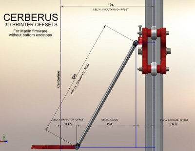

I mentioned a couple of days ago that some of the measurements on my Rostock MAX don't match the values in RepetierMAX's Configuration.h. I've spent several hours measuring, remeasuring, and calculating, and I have some numbers. Here is my report.

And here's the canonical diagram. Marlin's DELTA_EFFECTOR_OFFSET is Repetier's END_EFFECTOR_HORIZONTAL_OFFSET, and Marlin's DELTA_SMOOTH_ROD_OFFSET is our PRINTER_RADIUS.

The Measurements
I measured DELTA_DIAGONAL_ROD at 270.029 mm, +0.104 mm, -0.335 mm. One of my arms was ~0.4 mm shorter than the others. If you discard that arm, the other five are all within 0.1 mm of one another.
END_EFFECTOR_HORIZONTAL_OFFSET came to 31.638 mm, ± about 0.1 mm.
CARRiAGE_HORIZONTAL_OFFSET is 37.970 mm ± 0.1 mm.
PRINTER_RADIUS I measured just above the bed and also just below the top. The average of all measurements came to 200.823 mm. The minimum was 200.741, and the max was 200.972, a difference of 0.231 mm. (These measurements should be accurate to about ±0.04 mm.) I have not yet used my alignment jig to square the towers up, but I will, and PRINTER_RADIUS will change slightly.
Using these numbers, DELTA_RADIUS is calculated at 131.216.
The two numbers that are actually used by Repetier firmware are DELTA_RADIUS and DELTA_DIAGONAL_ROD. DELTA_RADIUS is off by ~0.97 mm. DELTA_DIAGONAL_ROD is off by 1.03 mm.
My best calibration efforts without changing the firmware constants left me with the hot end about 0.2 mm lower in the center of the bed than at the edges. I honestly don't know whether the errors I measured would account for that -- I find it hard to reason about how changes in rod length and printer radius affect the delta warp.

Following up on myself... Early this morning I wrote up all the facts, but didn't summarize.
Conclusion
The dimensions in the firmware are all wrong. Not drastically wrong, but they're all a little bit off.
  • Delta arm length: off by 1.0 mm.
  • Effector offset: off by 1.4 mm.
  • Carriage offset: off by 3.0 mm.
  • Printer radius: off by 2.6 mm.
That bugs me -- it indicates that SeeMeCNC was just hacking at it until it appeared to work. Either that or there are deeper reasons not to use the actual dimensions that I don't understand yet. Or maybe some sizes changed between the kickstarter generation and my May, 2013 kit. But still. How can they all be off by that much? Bad data for one or two dimensions would be understandable. Not good, but understandable.
And there is good news. The good news is that the errors all more or less cancel each other out. Delta radius, which is derived from the last three, is only 1.0 mm. That's 0.7% undersize. And the delta arm length is also undersize by 0.3%. So the overall misalignment is, uh, something smallish less than half a percent. (I am not going to do the trig right now.)

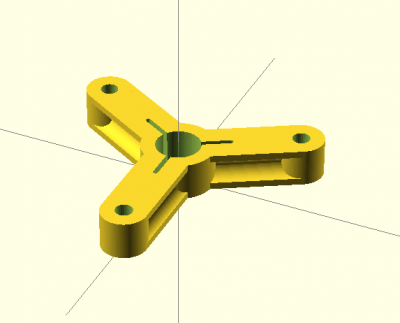

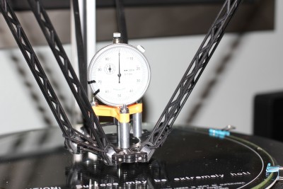

My Dial Indicator Mount
Posted: Thu Jul 25, 2013 4:26 am
by kbob
I have a cheap dial indicator. I got it at Horr'ble Fright last year for another project. http://www.harborfreight.com/1-inch-tra ... r-623.html
I designed this nifty little mount for it. I designed and printed it back in June, but didn't get a photo of it on the printer until tonight.
OpenSCAD FTW
OpenSCAD FTW
Here's the real thing.
Not a render.
Not a render.
I made the central hole a little undersized. The three slots around it let the hole stretch to make a nice friction fit around the indicator's shaft. I'm starting to figure out how to design for ABS.
You can also see the hair scrunchies that tension the delta arms. There are three more up by the CheapSkates.
Here is the OpenSCAD source file.
Dial Indicator Mount.scad
Dial Indicator Mount - OpenSCAD
(1.65 KiB) Downloaded 1022 times
My printer is back together now. I aligned the towers using the alignment jigs, I've changed the printer dimensions in the firmware, and yes, I've used this dial indicator to see how well it's aligned. I haven't had a chance to print anything yet.
More on that later; right now I just want to tell you that using a dial indicator to adjust the limit switches is about 20 times faster than sliding a piece of paper under the nozzle.

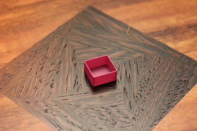

I'm Back!
Posted: Thu Aug 08, 2013 5:35 am
by kbob
Did you miss me?
On July 17th, I took the delta arms off my printer. That started an odyssey of calibration, rebuilding, repairing, and upgrading that finally ended this morning at 12:15 AM when I successfully printed a calibration cube.
Here is the cube that I printed. It measures 20.00 mm across.
(Desk inlay not included.)
I typed in about four pages of text describing the ordeal in great detail. I edited it for two hours, then SeeMeCNC's web site threw the whole thing on the floor because I attached an oversized image. Bah. I'll repost parts of it someday. It's late now.
