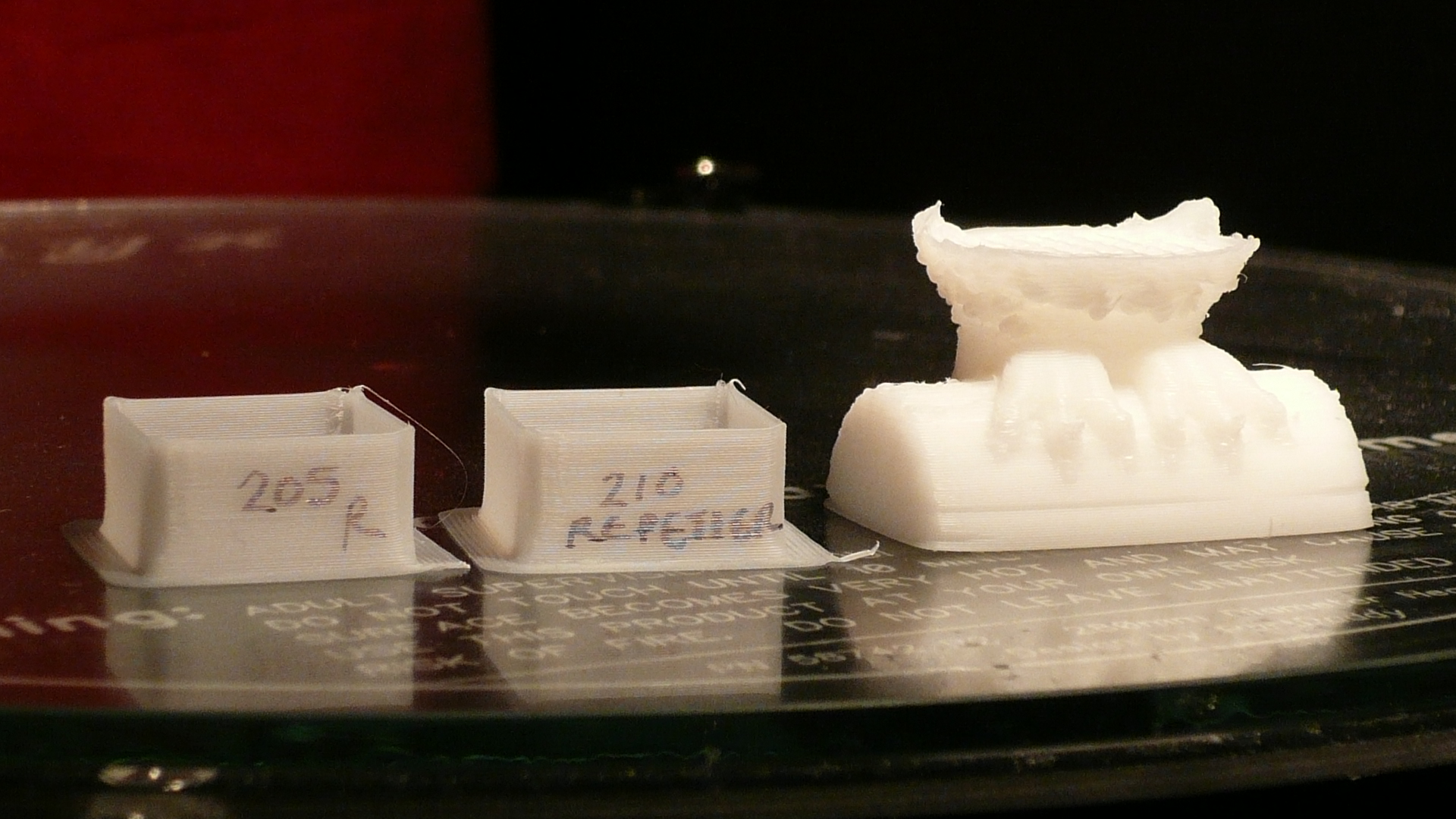

Progress thanks to Gene.

Corners look slightly better, but the raised, blobby corner issue is still there.
The nozzle grates over the raised blobs of corners or tight curves.
this compounds into artefacts that spread upwards into the print.
Thanks to everyone for help getting Repetier firmware running!
So what of these Jerk settings?
I can find documatation for repetier host, but not much documentation for the firmware...

What speed are you printing at?

Those cubes were 5mm per second as before. I'm working on site with a client, so I can't hang out today. I'll probably do some spread tests of temperature, then maybe test the enigmatic jerk settings

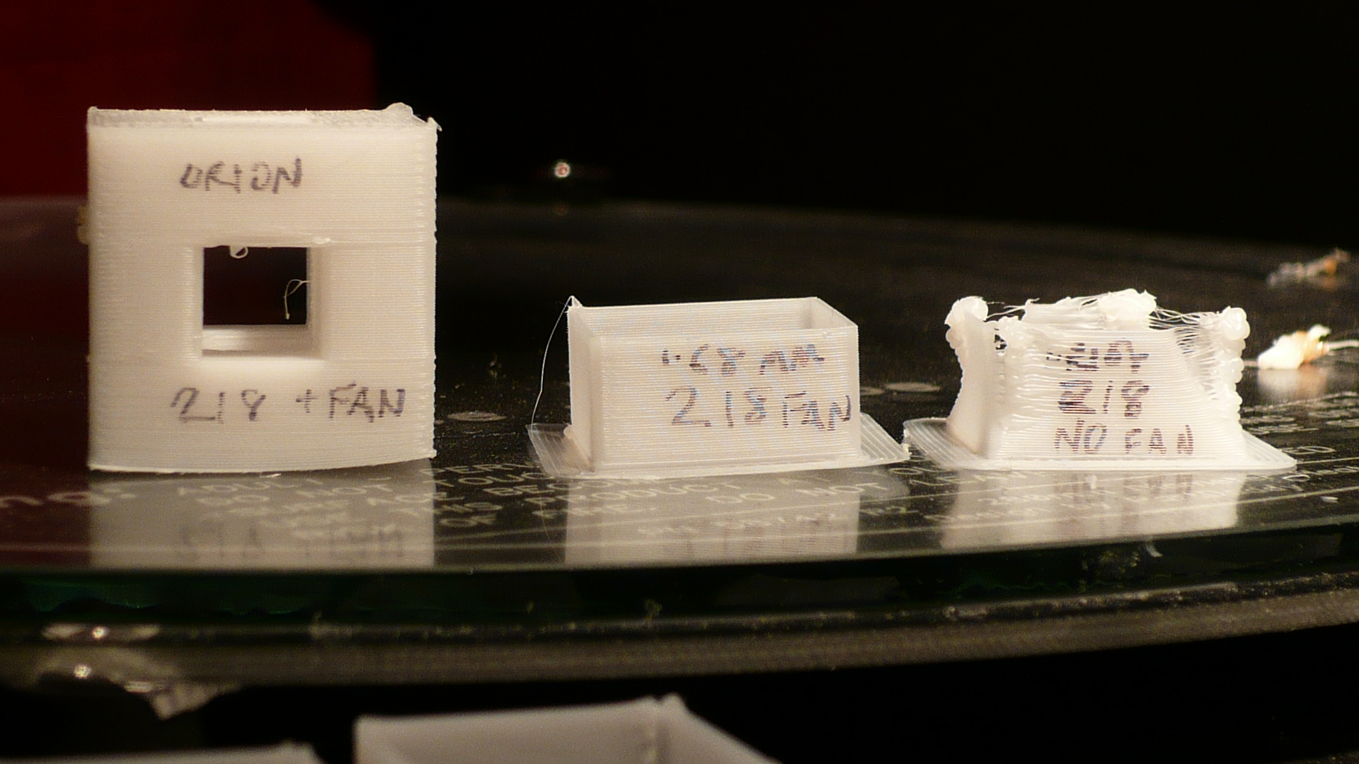

http://download.seemecnc.com/orion/quickstart/#/23
This is a vast improvement.
For a successful print I find that the print cooling fan MUST be on...
Without it I get the usual mush.
It's interesting to see that the "official" Orion ABS settings use a print cooling fan.
I have been told many times to never use a print cooling fan for ABS - but it still seems to be essential to me.
And maybe it is OK if SeemeCNC are issuing settings that use a cooling fan for ABS?
Thanks again to everyone. I'm seeing progress..
