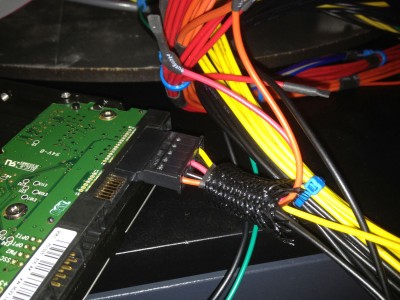

I've managed to get an old hard drive and connected it via the sata input:
with this Im covering the 5vdc and the 3vdc input right? (2 black, 1 yellow, 1 red, 1 orange)
The printer keeps shutting down when I try to run any command.
Im lost

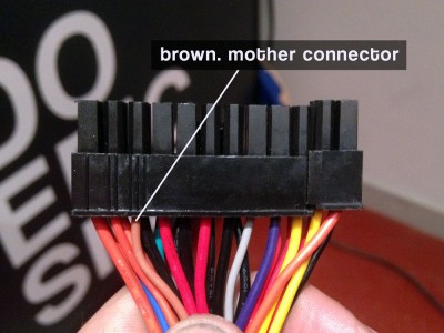

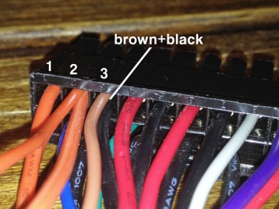

If it goes to the large ATX connector, which pin is it?
- Tincho85
- Posts: 659
Re: Heated bed cannot reach temp
It goes to the mother, if that's what you are asking. yup, i like to take picsnitewatchman wrote:If it goes to the large ATX connector, which pin is it?
EDIT1:
Did some google, it seems that the brown wire is "+3.3 V sense"
dunno what that means, the spanish article from wikipedia is very poor.
EDIT2:
source: http://reprap.org/wiki/PCPowerSupply
Voltage Sensing
The +3.3 VDC remote sensing wire (brown or orange) is connected directly to the orange +3.3 VDC at pin 11 of the power connector (pin 13 if a 2x12). The sense wire will usually be of a lighter gauge (22 AWG) than the power wires (16 or 18 AWG) and its purpose is to monitor the voltage at the connector in order to provide feedback for voltage compensation by the supply.
If your PS has two wires attached to the same pin on the motherboard power connector, orange +3.3 VDC and a brown sense wire on Pin 11 for example, then these two wires should be joined when you make your conversion. Some power supplies may also have sense wires running to the +5 VDC and +12 VDC connector pins. If there are multiple sense wires, then they will usually be of the same color as the primary supply wire, but of a lighter wire gauge. These sense wires will also terminate in a different location on the PS printed circuit board than the heavier supply lines. As with the +3.3 sense wire, these additional wires should also be connected to the corresponding supply lines. Failure to complete these connections may result in your power supply not latching into a Power_On mode when switched on.
-- Main.SimonMcAuliffe - 01 Jul 2006
So I need to connect the brown wire and the orange together??
Sorry if Im too annoying, but I dont want to blow this new PSU or the Rambo board.

Yes, I believe this to be true. The brown wire monitors the 3.3VDC output and provides feedback to the P/S to regulate the rail.
To be cautious I would connect the sense wire (brown) to a 3.3VDC wire (orange) with the 12VDC input wires unplugged from the Rambo and with the disk drive connected to SATA plug. If this seems to operate okay, TURN OFF the power supply and reconnect to the Rambo.
I will keep my fingers crossed that this solves the issue.

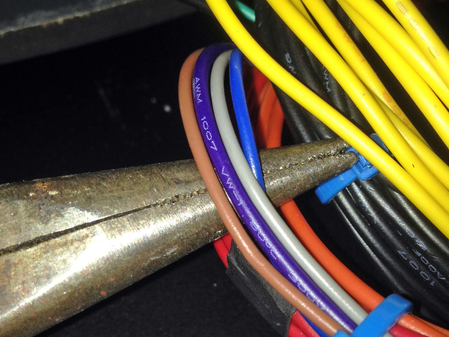

hi nite, I did what you said. When I join brown+orange it shuts down (fortunately it protected against shorts ^^)
But then I looked closely and find out that the brown wire was crimped together with a black one.
Then I turned on the PSU, joined brown+black and it didnt turn off!!!
So now, Im about to try it with the printer. Wish me luck
EDIT: nope.. same, it turns off.

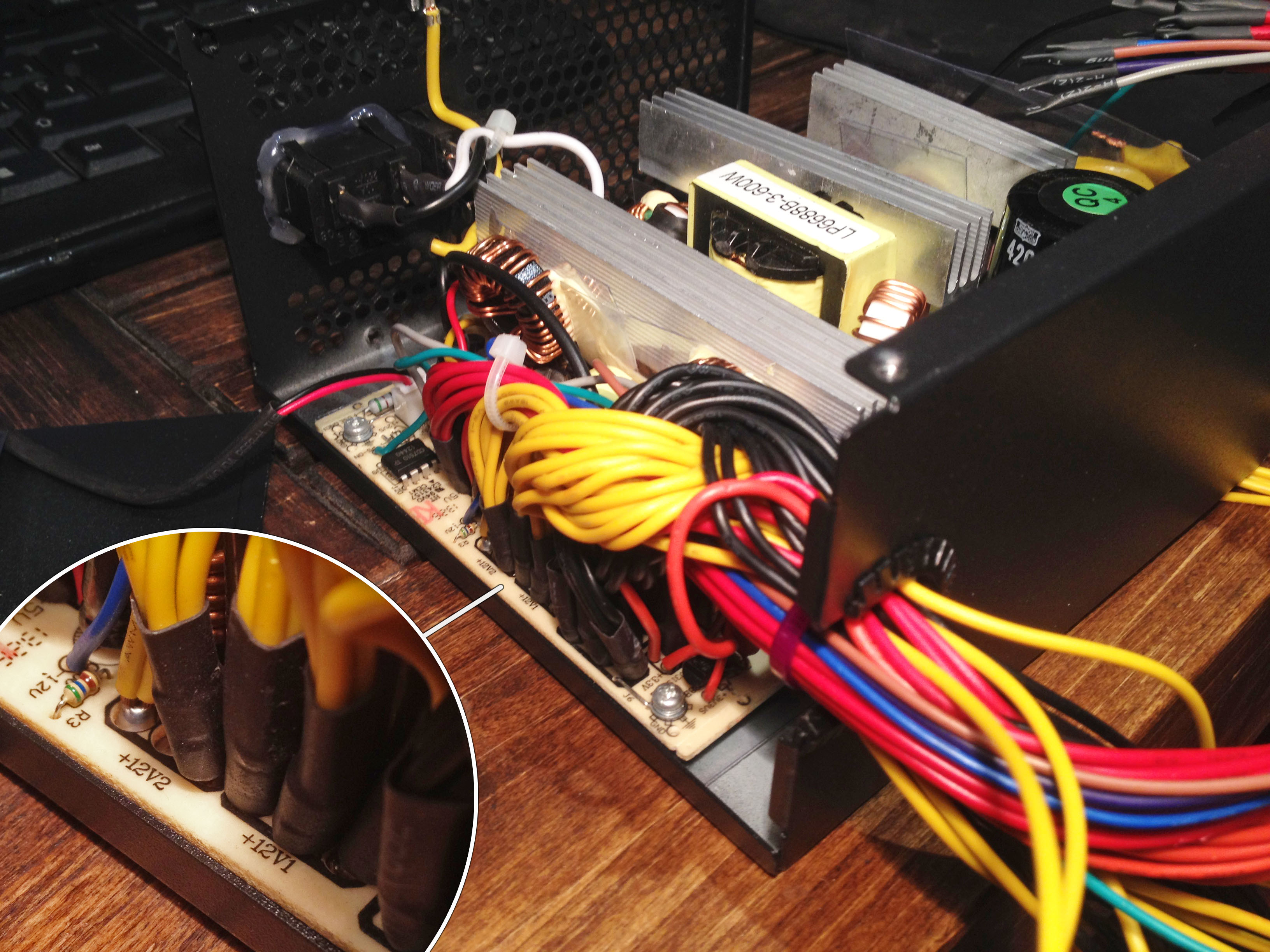

Not happy to announce that Ive been defeated by the Sentey PSU. I will send it to re wire all the plugs and then sell it...
Today Ive bought for $30 a generic 600w psu with 2 fans. It Looks awfull but works like charm.
Now its taking 2min less to get to 90ºc. I added an aluminum disc beneath the boro glass too.
