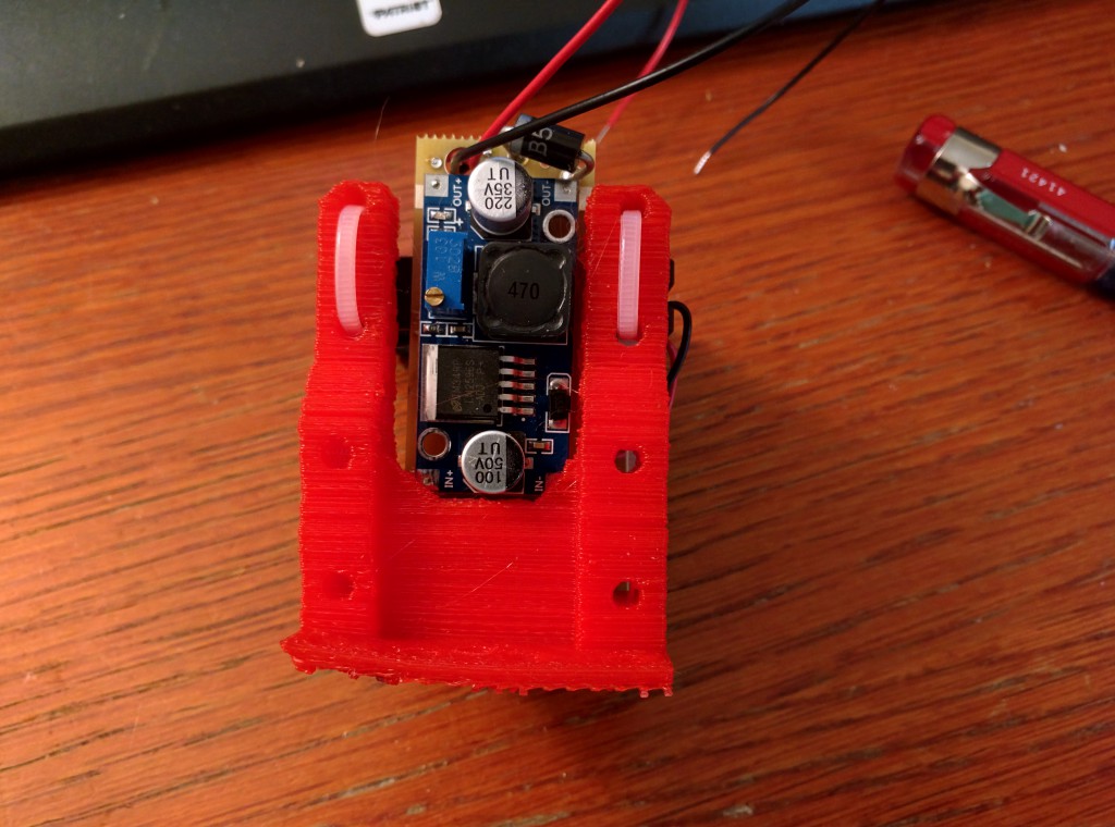

Received my L'Cheapo laser a few days ago and have had a chance to use it a few times. Shipping was lightning fast from 3D Supply Source.

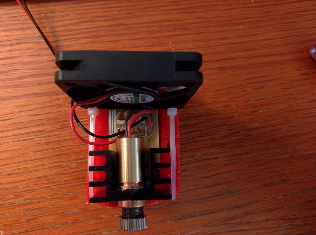

I was disappointed that for $200 it had through hole components. The laser itself is press fitted into a heatsink not designed for this purpose. You can see where a hastily drilled hole still has metal shavings coming out of it.
[img]https://mattlapaglia.com/wp-content/upl ... 24x760.jpg[/img]
The printed mount it came on is absolutely terrible. It looks like it was printed way too fast, one of the corners lifted off the bed during printing also.

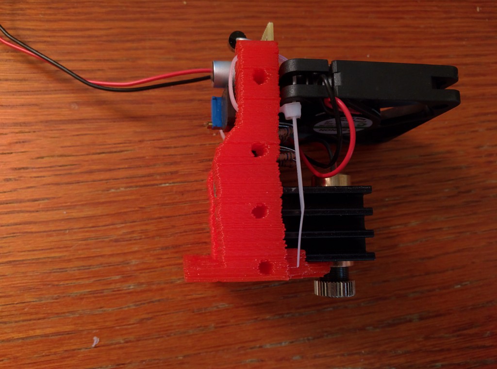

The whole thing is held together with zip ties...

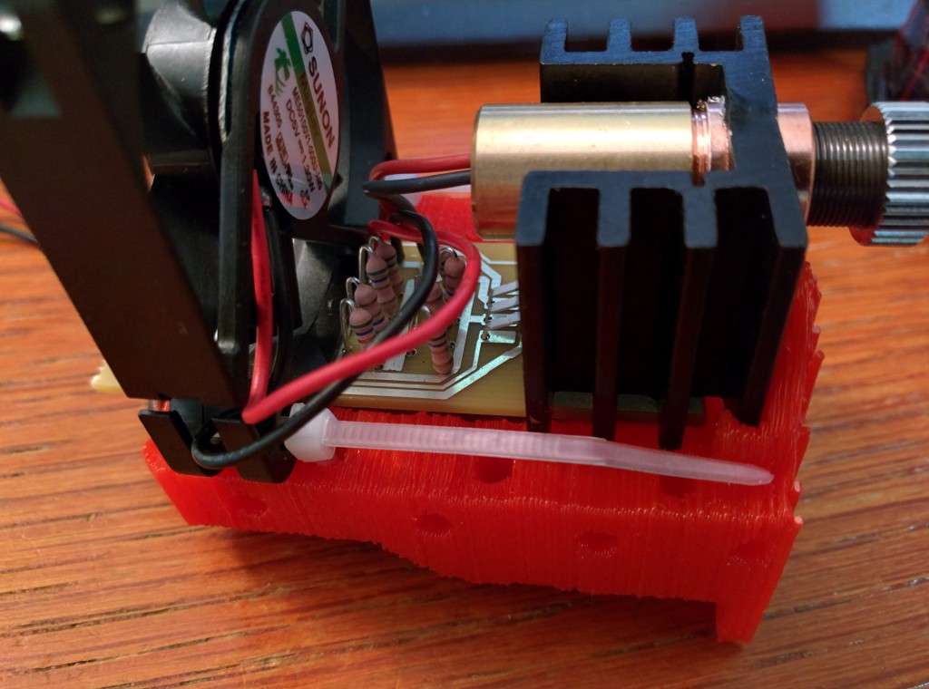

The laser focus ring wobbles inside of the laser casing. The silver ring can come off of the threads causing it to not rotate the actual focusing element. The fan cannot be controlled separately from the laser. When power is applied to the laser the fan comes on. It gets annoying to listen to the fan turning on and off during a print as the laser moves around the bed.

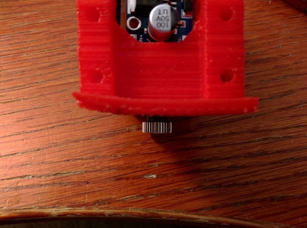

None of the mounting holes are usable. The portion of the printed part that the laser heat sink slides into was affected by the lifted print. The piece was cut with a knife to get the laser heat sink pushed into place.

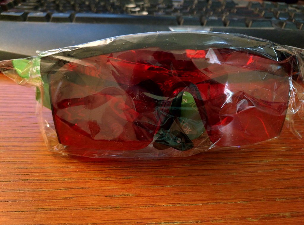

The laser comes with some cheap chinese goggles. The ear pieces are adjustable and they seem to do the job though, I haven't gone blind yet.
