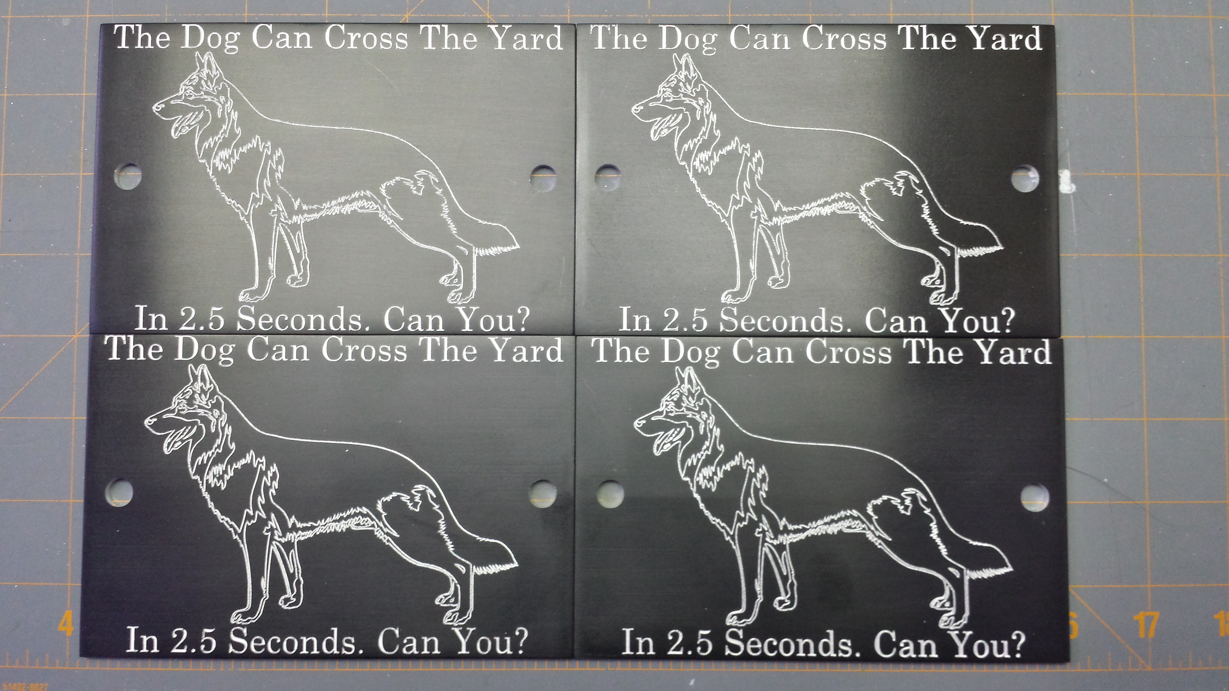

I have used the very same bits in metal and they work great.. Here is a shot of a sign I did for my folks and their new german shepherd
The dog was done as just a 1/4mm deep etch. the lettering is done at .5mm v carve with aspire 4 for this one.
All four signs were done with the same endmill and it was still sharp once finished. The blanks were cut from the stock sheet then prepped and anodized black. Then mounting hole were cut with a 1.6" endmill and the sign was engraved with the 30 degree .2mm engraving bit.

I use http://www.ebay.com/itm/381043625814?_t ... EBIDX%3AIT for my aluminum most of the time unless I need something smaller... Of course I tried another bit on the stock SEEMECNC mount I used in the tumbler shots and as you can see it was not near as good of bit.
I run the endmill above at about 100mm M taking a .1mm cut each time.. I tired the new endmill at 65mm M and tried to cut it at .25 and it chattered on me as the pics showed.

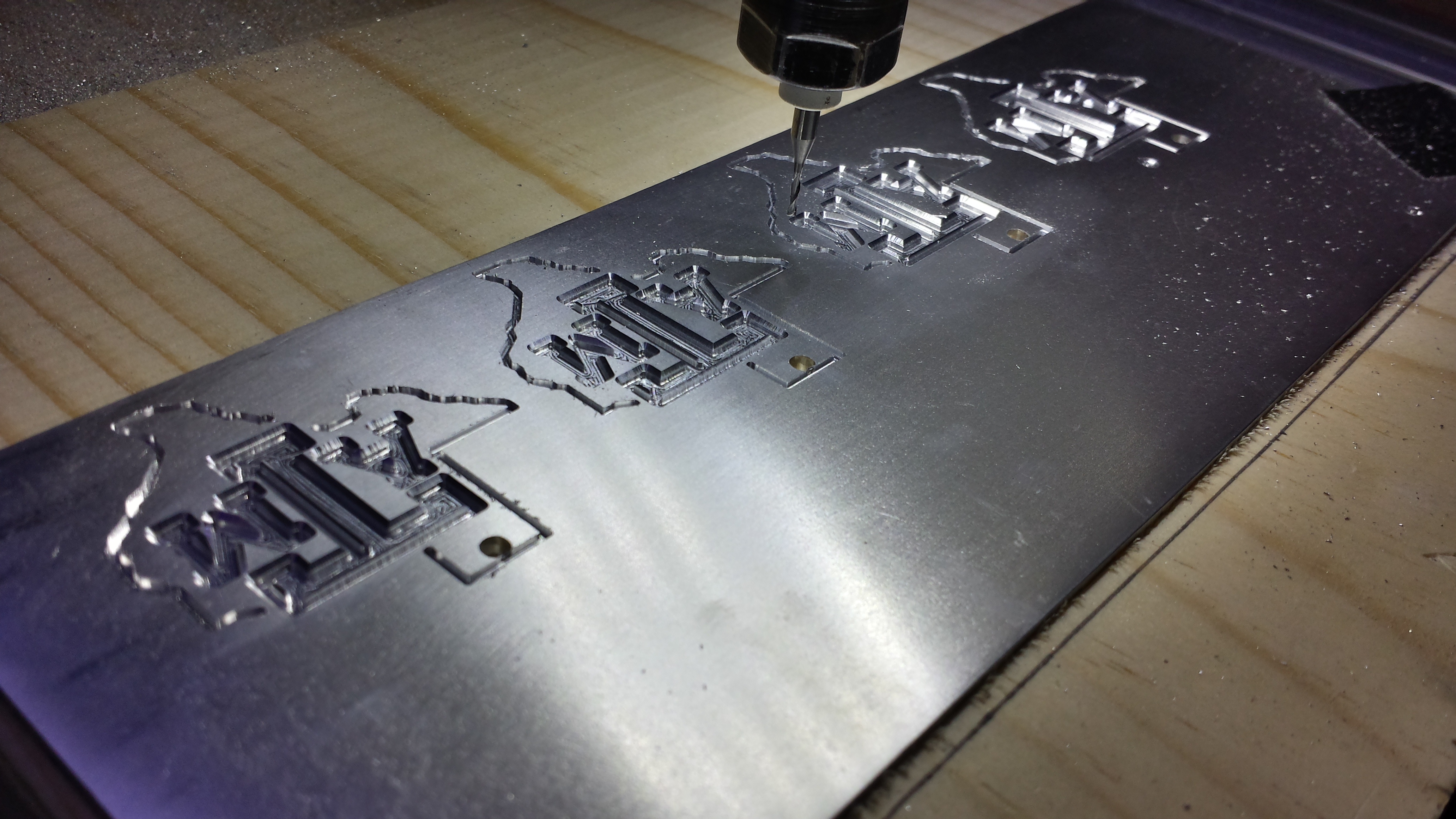

I did this with a .80mm endmill from drillbitsunlimited

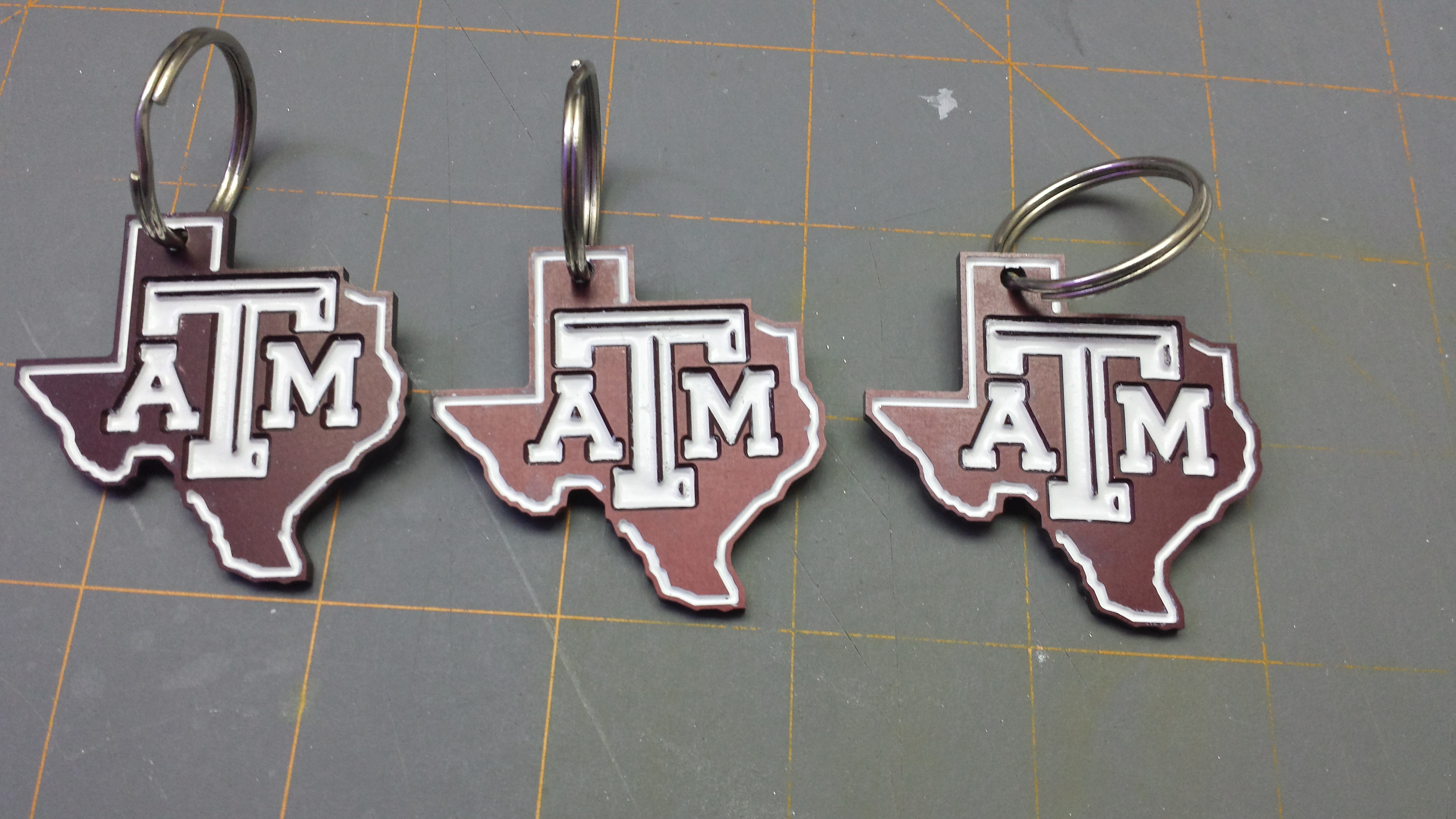

Then anodized it and filled in the mill work for a contrasting color. Custom blending the Aggie maroon anodizing dye was interesting to say the least. This was a one off gift and NOT SOLD so I THINK I am OK with not being hunted down by the Aggies!

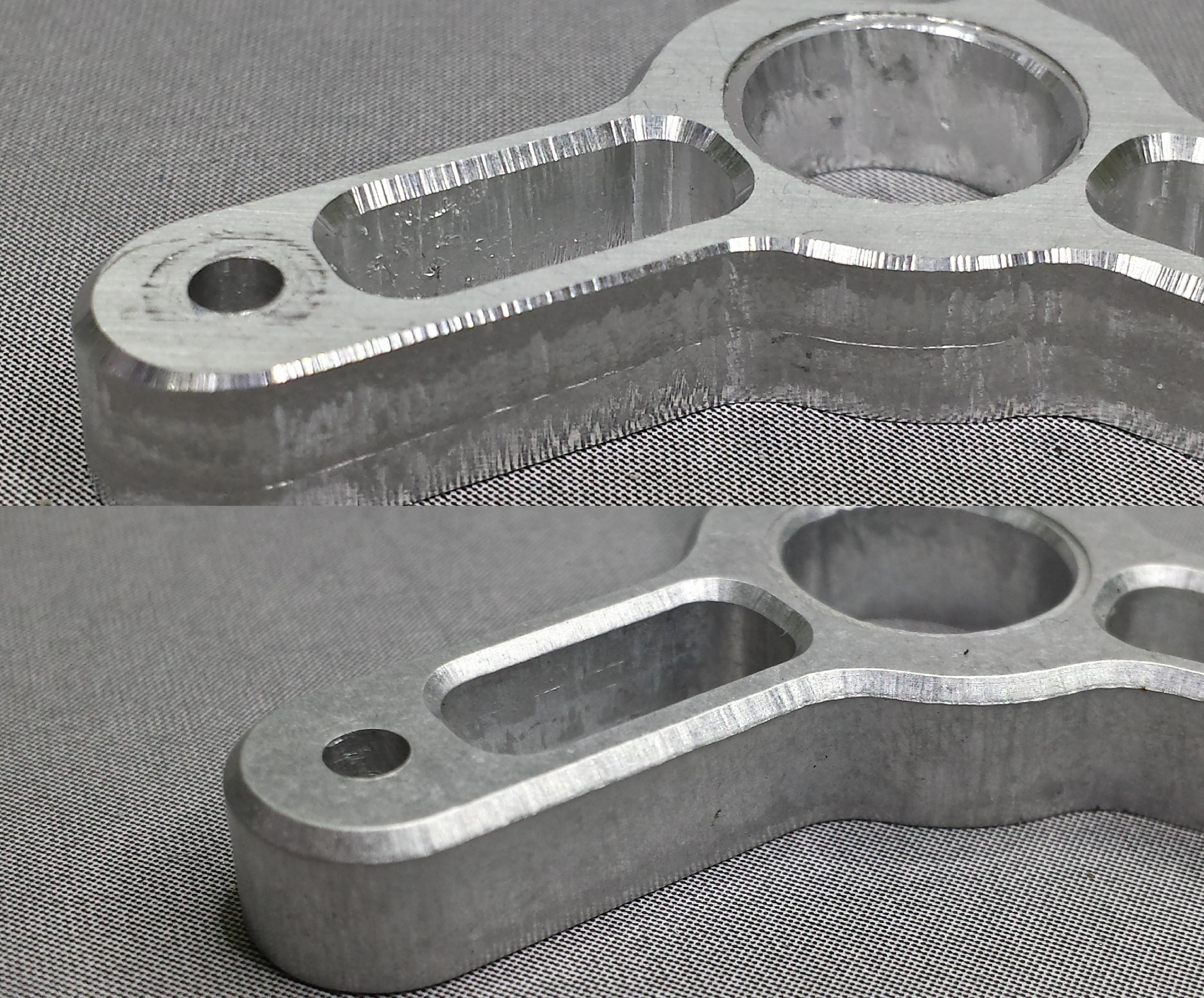

Thought I'd pipe in on a few things. Firstly, are you running the vibratory polisher dry? If so, try running water (very small trickle) through it. You will be amazed at how much faster and better the results will be and the media will last a lot longer. I have 3 of the bigger version of these polishers and they run 4+ hours 5 days a week for several years without fail. Good units.

I ran the first media (green triangles) wet and the second and third media (corn cob and walnut) dry. I will be picking up a second tumbler when i get home Monday as cleaning the wet media to switch to dry was just too much a hassle and at the unit cost it is easy enough to just have one for wet and one for dry. I can use the cyclone separator to remove the dry media and recover it when I switch types in the dry unit. But aside from washing the media with fresh water I plan to leave the wet one wet instead of trying to dry it for the other steps each time on a batch. I will post updated photos shots of how the tumbler did. I just had to fly out of town for the weekend before I could get them posted.

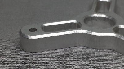

So I let the parts run for two more hours in the walnut media and then snapped a pic before I ran out the door to catch my flight. I will repost the before/after shot from before so it is easier to compare here.
This is before and after one wet and one dry stage. This piece was rush cut and the mill chattered so tooling marks were heavy to start
This is after one wet and two different dry media stages. About 6 hours total between the three.
I think a longer wet stage and maybe a tad longer walnut stage would give the part a very good finish with little to no hand work needed in the process. Moving forward this will be the finishing process of choice on the mounts.

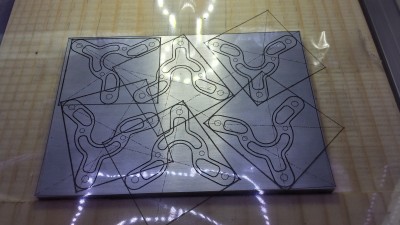

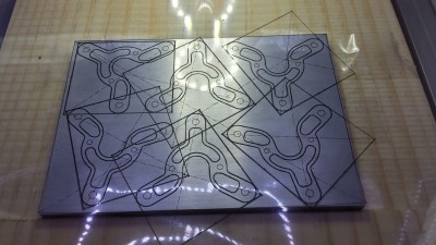

Today I am working on getting the BETA tester mounts milled and I hope, into the tumbler tonight. If all goes well I will anodize them sometime late tomorrow and try to get them in the mail by Thursday before I fly our for my weekend shoots. I spoke with E3d today over in the UK and I will be picking up a few V6 heatsinks without the brass bowden fitting inserted to see how well they anodize also. Once they are anodized I will press the fitting in place (I hope) I personally like the idea of anodizing my volcano a nice red or deep orange just for the kicks of it. It will be a week or more for that result though as shipping will take a bit since I did not choose the fastest option they had as there was no rush.
getting the BETA tester mounts ready to mill out of 6mm 6061

What would anodization do to heat dissipation of the aluminum? I very much like the idea, but wouldn't want to negatively affect the functionality. Perhaps there's a coating that could improve it! What does copper plating do to an aluminum heatsink?
If it works, I want a blue one! :)
Posted: Tue Jan 13, 2015 3:20 pm
by travelphotog
Jimustanguitar wrote:What would anodization do to heat dissipation of the aluminum? I very much like the idea, but wouldn't want to negatively affect the functionality. Perhaps there's a coating that could improve it! What does copper plating do to an aluminum heatsink?
It should not do much if anything to it. I will be running test to see how hot it is VS the stock one on the same print. I have done it on heatsinks for custom reef led lighting and it works fine. I will be leaving the center hole blocked while anodizing to keep the inside raw aluminum. I should know more in a week or so. One down side to being able to anodize on a whim is deciding what color you want your own stuff to be!
Being that it would be such a super thin layer of copper, it would not really do much in the way of helping to cool anything off. A solid copper heatsink would do far more cooling but not so much so as to offset the cost of material and workmanship to make it.
It is looking more and more like I will be sending you guys the BETA testers next week sadly. The cycle times are adding up fast on the mill with the slower cutting rates and slowed down finishing passes to get a nice finish. Also not sure the M3 screws will make it by Thursday Am when I fly out. But if anything it will be Tuesday of next week i think. I will PM everyone tomorrow night and we will go from there.
