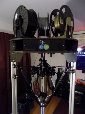

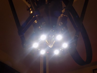

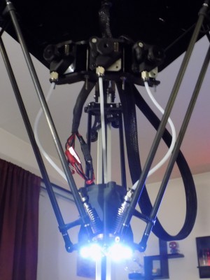

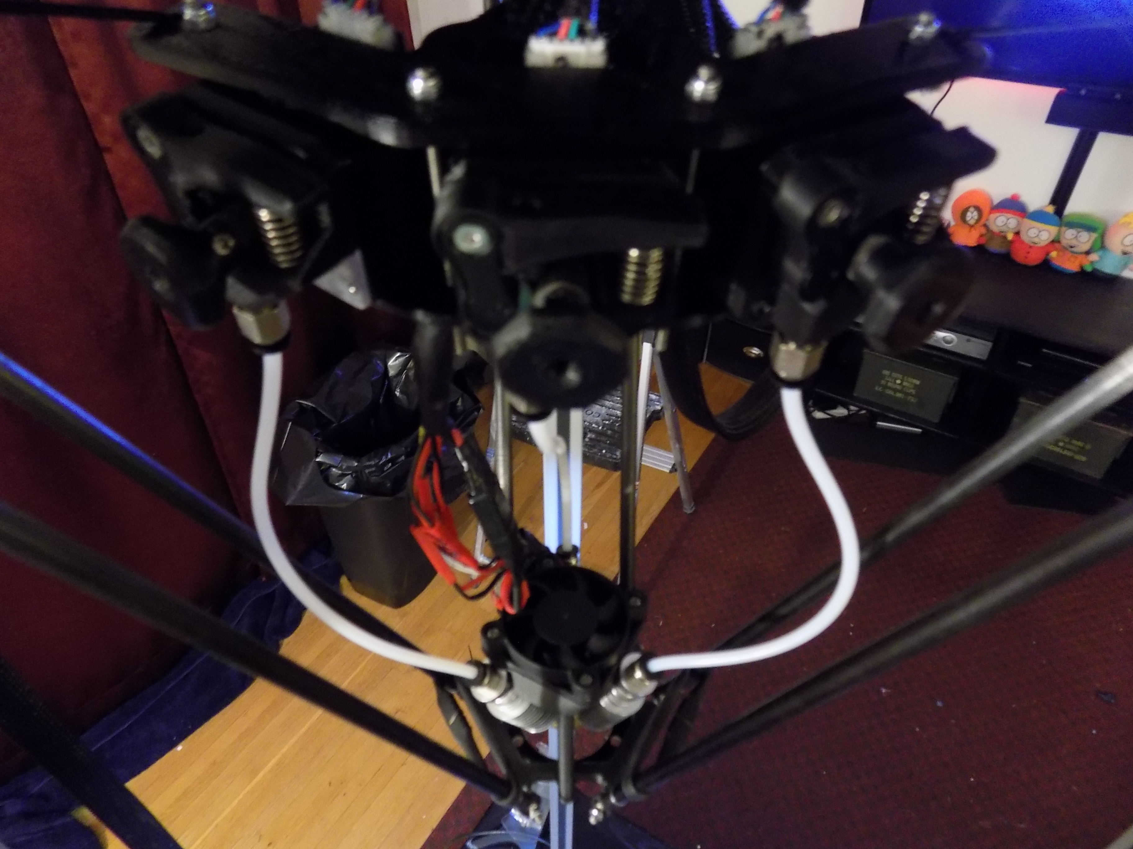

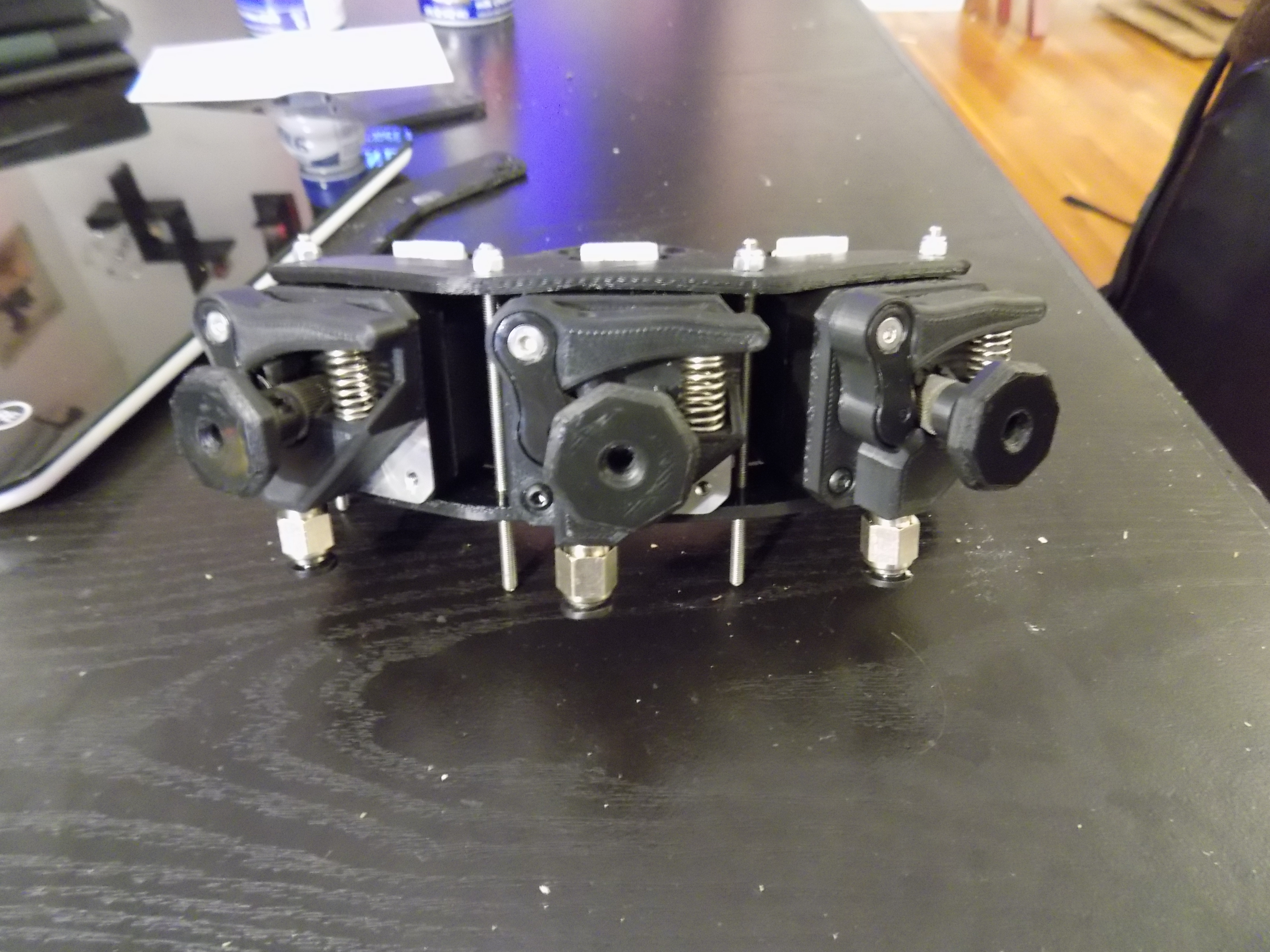

My setup now... I completely changed what I did in terms of setup since making the video I posted above... I bought a little stepper expansion board from reprap.me... I bought it to play around with it - not expecting it to work - however, when I hooked it up to the Rambo and played with the firmware, it ended up working out for me... So there's that...
Right now I'm designing my own EZ(er)-Struder (I really don't like the EzStruder it's not really that ez, it's bulky, heavy, hard to feed, and the filament likes to get hung up in the assembly... I really think my redesign is 100x better, IMO)... and new 'Flyin Struder' to support the three stepper motors that drive the filament into the Diamond... I have some pretty heavy nema 17s in the (240 grams each) so 240 x 3 = 720 grams... In total, my assembly weighs 850 grams which is way too much weight on the effector, belts, and motor... I'm waiting on some new motors I ordered that weigh only 180 grams yet still have ~2100 gram/cm of holding torque (pretty strong)... With the lighter motors and weight reduction in my assembly, I'm hoping to get the total weight down to about 600 grams in total... This will work since the stock extruder motor with the printer is relatively heavy (~400 grams w/ezstruder - each)... I had a decent single extrusion system with a "flyin struder" that worked well and in total that was about 500 grams... So adding 100 grams for two more motors seems like a good trade-off to me...
But everything is working for me, I'm just trying to figure out how the setup should work now... I'm also dealing with all the extra wiring that comes with adding these extra motors and how to route that up to the top of the machine... If I get around to it, I would also like to change the thermistor to the PT100 coupler sensor for more accurate readings and the potential of reaching 400C...
Overall, I'm about 1-2 days away from having this 100% set-up and printing...
Here are a few pictures....

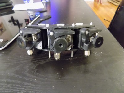

http://reprap.org/wiki/Diamond_Hotend#B ... his_designJJPowelly wrote: Right now, my biggest issue has nothing to do with motors or extrusion... My biggest issue is heating the hotend... I'm currently maxing out at around 170C in the hotend... I've nailed it down to two things, either my cooling fan is working too well, or I'm not getting enough heat to the hotend... I really don't believe I'll be able to run two heat cartridges to the hotend, so I may end up having to resist the fan or put a potentiometer on it somewhere to control its speed. I should have it figured out in the next couple of days...
In your pictures, I see no sign of the thermal isolation sheet between the hot end and the cold ends. It also prevents any fan airflow from hitting the hot end, which is probably its most important functon in this case, and why it's cut larger than the hot end itself.
If that's not the whole of the problem, measure the resistance of the heater cartridge and do the math (P = V**2/R) to make sure you're getting the wattage you expect. You could have a defective one with an internal short.

I figured out what it was... I'm using XT60 connectors on the heater cartridge so I can do quick disconnects of the entire diamond assembly without having to take it apart... Well, one of my solder points into the XT60 connector was quite literally hanging on by a thread... I re-soldered and it is working perfectly now... It's always something stupid....

I actually cut a little piece of cork and used that as insulation... That fabric was extremely annoying how it just frays out so easily, I got tired of it quickly and decided to come up with my own alternative... I had some extra cork pads laying around from when I used them to dampen the vibration in my x,y,z motors... So I cut it up to insulate the nozzle.Eric wrote: In your pictures, I see no sign of the thermal isolation sheet between the hot end and the cold ends. It also prevents any fan airflow from hitting the hot end, which is probably its most important functon in this case, and why it's cut larger than the hot end itself.

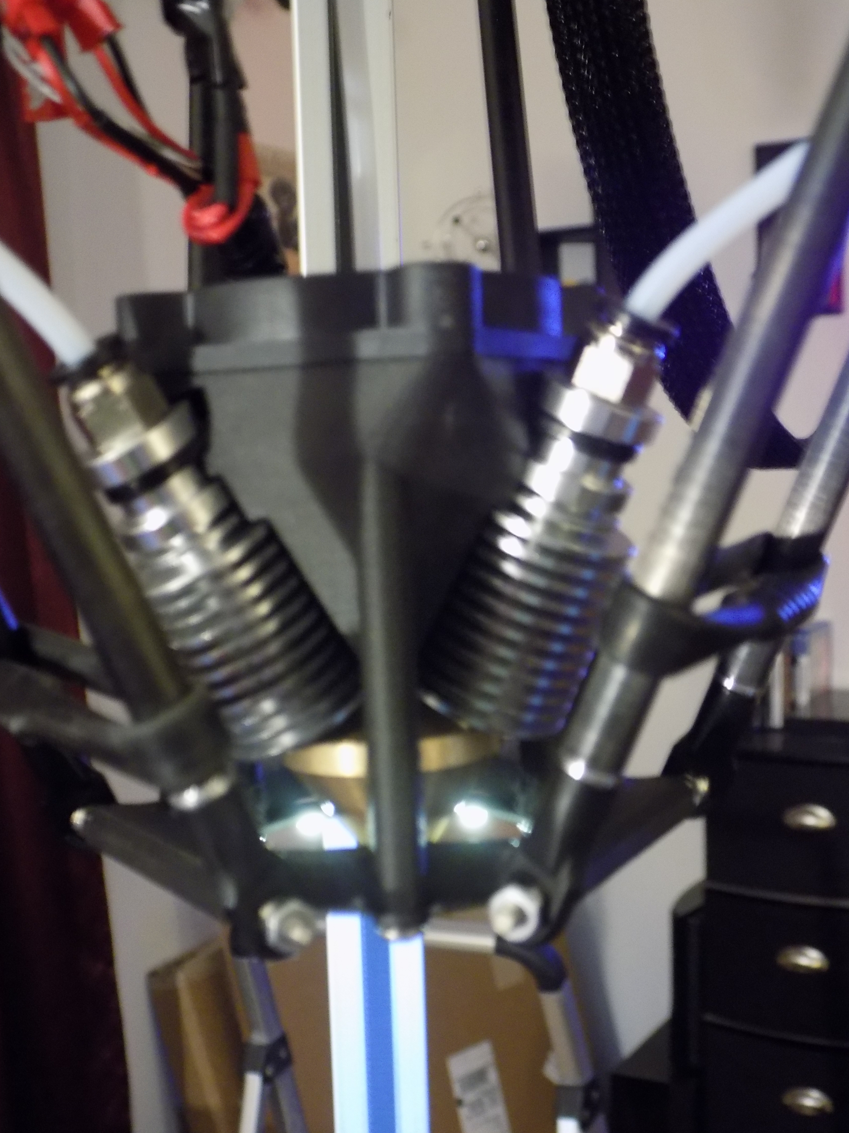

Got a Diamond in the mail this week. Now I need a mount. I got three of the E3D V6 Lite heatsinks. Eegads are they heavy. I might have to replace them with aluminum and maybe a close fitting water cooling jacket. Anyone running 3 Lites on a Diamond on a Max?
Re: Interesting new Diamond hotend 3x filament
Get the chinese copy and chop the heatsinks to your liking.

Yes, that's what I'm running, and yes the entire assembly is on the heavy side.mhackney wrote:Got a Diamond in the mail this week. Now I need a mount. I got three of the E3D V6 Lite heatsinks. Eegads are they heavy. I might have to replace them with aluminum and maybe a close fitting water cooling jacket. Anyone running 3 Lites on a Diamond on a Max?

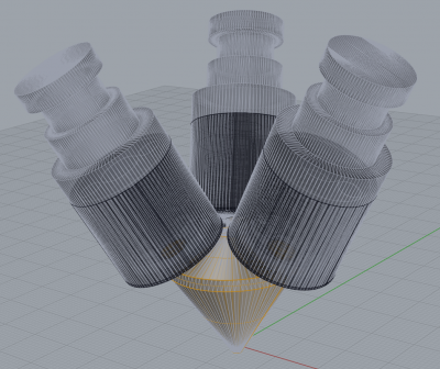

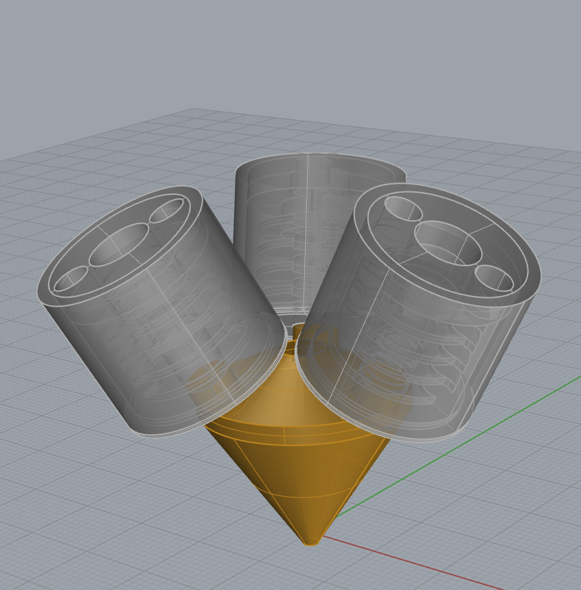

I've decided to go with 3 water cooled jackets for the Diamond setup to keep things compact. Here's a drawing.
Here's a comparison with 3 E3D heat breaks:
This will be quite a bit smaller and lighter. I'll use the press in fittings like E3D uses on their hot ends. I'll press fit the 4mm OD aluminum tubing into the top for the hose connections. Short lengths of plastic tubing will connect each jacket with one serving as the inlet and one the outlet.
I'm thinking about mounting options now. I like the 3 post designs that a few folks have printed. I could use something like that which snaps over the jackets like a big C with the opening facing up and to the middle. The entire assembly could be snapped in and out easily.

They should have called it the EZierStruder. It really is way easier than the gigantic monstrosity they were shipping before. It took me half an hour to assemble that thing.JJPowelly wrote:I really don't like the EzStruder it's not really that ez, it's bulky, heavy, hard to feed, and the filament likes to get hung up in the assembly
Maybe this year they'll revisit the EZStruder design and make it less annoying, and more compatible with flex filament. They should really think about going with a geared extruder. They skip FAR less, and anyone who wants to run a Cyclops is gonna have zero luck with a non-geared NEMA17.
My new design has been pretty solid so far... Only problem I have is that I put too much tension on the springs and it grips a little too tight causing the filament to get ground down by the gear... I made a few adjustments in the plunger and found the sweet spot for tension though... The hardware used in my mod is the same hardware as an mk9.
