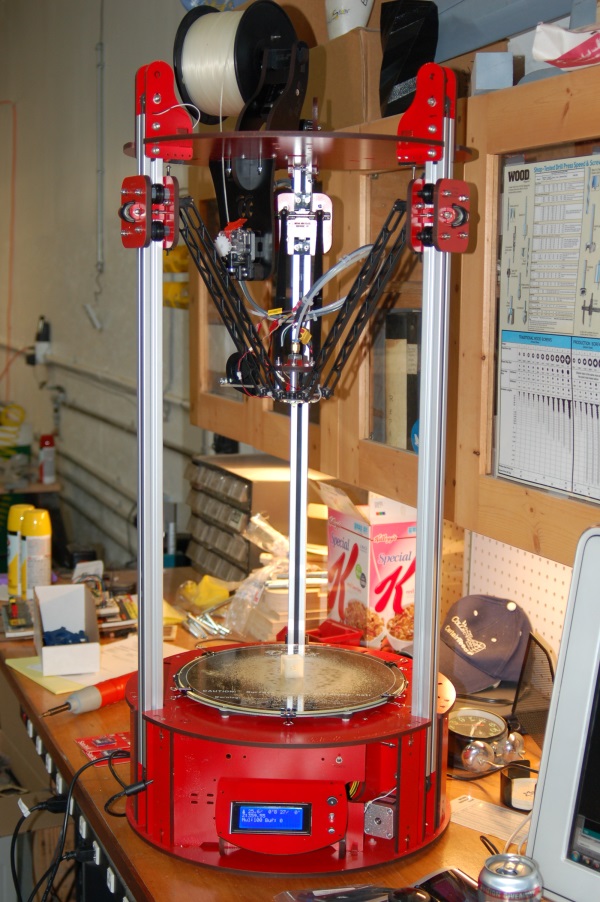

MHackney, I see in your photo in post #1 that you've got some kind of crimp-on connector on your power & heated bed wires - what is it and where can it be had?
tnx!
							tnx!
