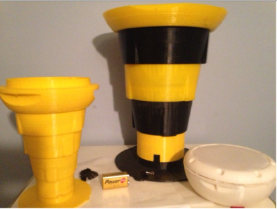

				I've been asking help pretty frequently on this form and you guys have been really generous with it.
And now, I'm about to ask for more. But first, I thought I'd share what it's all about, in case one or two of you guys would find it interesting, and a reason
why it's worth your time.
My whole reason for building the Rostock was to print a full-scale prototype of something I invented - a patent-pending telescoping musical drum, with a
maximum 10.73" diameter, comprised of 7 rings. Pictures at bottom.
The idea is to print a full scale prototype to test for functionality, and pursue crowd funding. The final product will be made of colored and/or uncolored transparent copolyester and should look pretty freakin' cool.

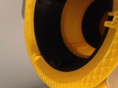

Unfortunately, printing at the edge has been and remains a huge challenge - I've yet to succeed with the last and widest components.
I was thinking OpenDACT would be the answer, but was not able to get it working, and must
give up on it till I can get access to another windows computer.
Meantime, I'd like to go back to the HTML tool. But so far I have not been able to get a tight enough calibration with it.
My questions are,
1) would it be feasible to reconfigure the probe algorithm to take measurements all the way out near the white line?
2) If so, would those measurments be useful to the HTML tool in its current form?
3) If not, would it be feasible to rejigger the HTML tool to work with them?
If you think this project looks cool and you'd like to help me get over this many-months-long hurdle, I'd greatly appreciate your continued input.
			-  This shows 1) my initial 56% scale prototype, printed on a uPrint - that's the collapsed white one,
2) another 56% scales i did on my Rostock in Black and Yellow, and 3) The only 100% scale work I've succeed with so far. Note the top is incomplete.
			-  Zoom-in on where the best 100% scale print I've gotten so far failed.
			-  An early transparent render

Although I haven't tried it myself yet, I would suggest trying heuristic calibration by 626Pilot
http://forum.seemecnc.com/viewtopic.php?f=82&t=7640 Looks very promising.
Good luck with your project. The idea looks great! As for the HTML tool, I would just using manual calibration tab without connecting to the printer through OpenDACT. Use the g-code posted here and edit it to your liking. You may have to do some math to figure out absolute coordinates for a specified diameter. Take measurements with a dial/digital indicator or a caliper. It does take longer, but it is safer.

I don't see your print failure being caused by a calibration error.  I see the failure being caused by the large diameter it's trying to print.   SeeMe's new arms I believe are longer?  Trick Laser does offer their arms in a longer version.

Thanks Mac The Knife. I was initially plagued by that problem, but resolved it long ago with TR's 325mm CF arms. So now I think it's back to calibration.
Just spent about 4 hours trying to dial in Delta Radius but prints around the edge are still useless, and auto leveling also doesn't work - I have an email in to MC's support about that.
I'm trying to figure out how I can use the FRN's I installed to auto-calibrate. Was never able to get OpenDACT to respond to the FRN's signals, and 626Pilot's script requires a Smoothieboard I believe - anyone know any other auto leveling options that can work with FRN's?

				by U.S. Water Rockets
				I've upgraded my printer to the new SeeMeCNC Ball socket arms and have multiple effectors for different hot ends. So, my question now is whether you guys think that the calibration of the bed would hold true when I swap out effector platforms, or do you think variations in the platforms will throw off the calibration?
If the calibration holds true, then I would consider making a 3rd effector platform that is only for the dial gauge and that way I can get it totally centered on the platform.
What do you guys think?
