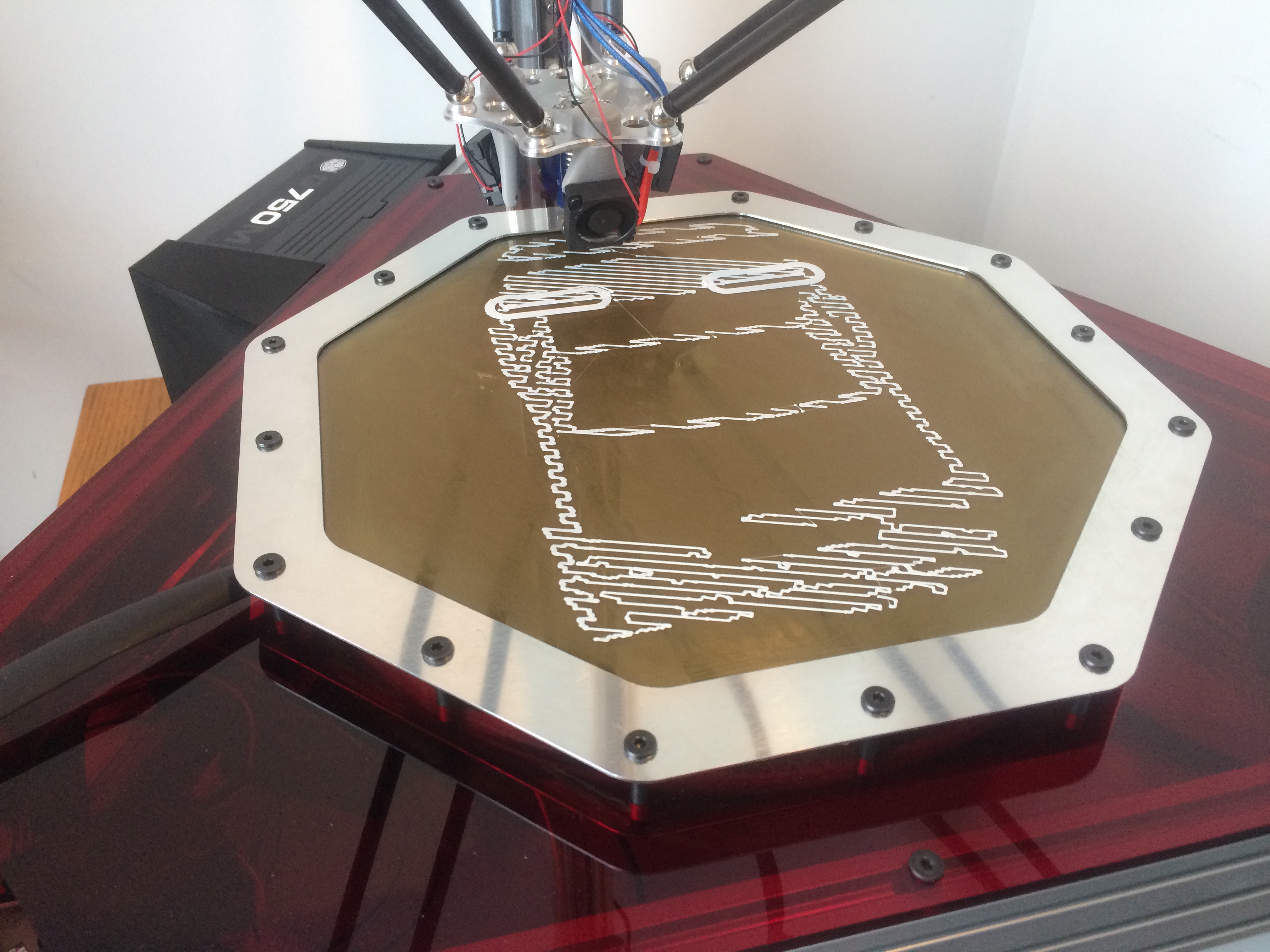

This is why I only use the 1/8" thick sheets and only advise people to use that thickness. The thickness allows the sheet to be held down with only friction, with binder clips on the edges or the like. There is no need for adhesive, the sheet stays flat because of the clamps and the thickness of the sheet.
Re: PEI print bed surface experiments
Posted: Thu Oct 15, 2015 3:06 pm
by mhackney
bot, my first sheet was 1/8" and expected it to behave as you described. I found that it did not lay flat and needed to be adhered. That's what led me down the path of trying silicone and other adhesives, ultimately ending up at the 3M tape (you can read all about these trials and tribulations in my PEI thread and build thread). I've installed .03" PEI on at least a dozen of my own and other's machines and I've had no problems with flatness, delimitation, etc on any of these. Perhaps the first sheet I receive had a natural bow in it from storage or manufacturing but it certainly did not lay flat.
Posted: Fri Oct 16, 2015 5:52 am
by bot
The sheets I receive all have bows in them. I simply flatten them down to the glass with friction. On my Rostock max I use binder clips around the perimeter, on my new printer I designed custom clamps to hold all around the edges. Maybe using an octagon instead of a circle allows the sheet to more easily be clamped flat. I've been printing for over a thousand hours with the PEI sheet, and I am never looking back, nor would I ever consider adhering the sheet to anything. The beauty of the 1/8" is in not adhering it.
