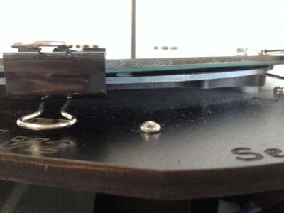

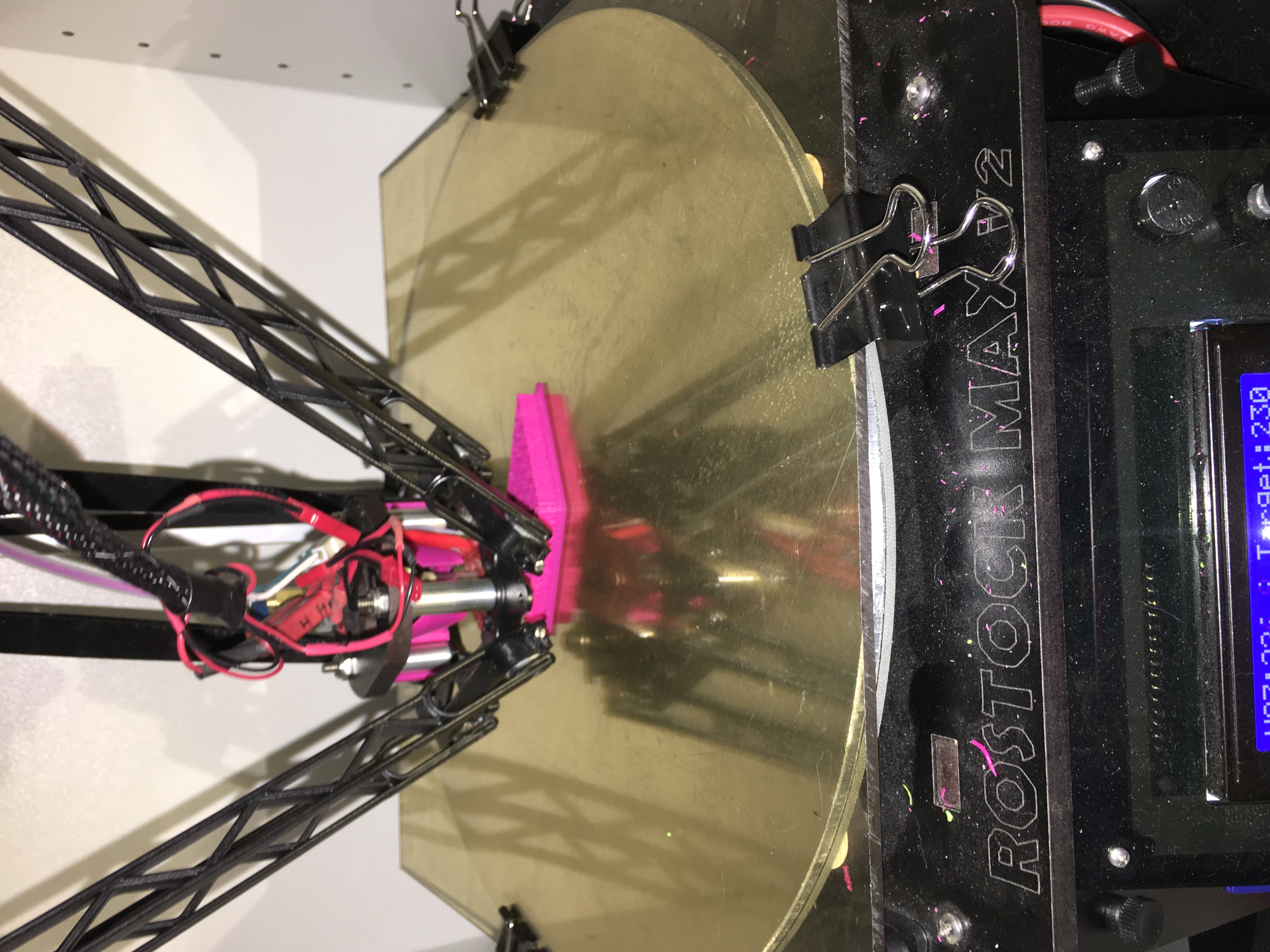

My 3mm arrived. I have clamped it on and it is printing nicely now. No adhesives!
I removed the glass plate and put pei directly on the AL.

I'm very interested in this option. Could you take some photos please? How flat was your sheet? I am concerned about bowing and having a hump somewhere (even .05mm would be a pain). I wonder if there is some light tack option to hold this stuff down.

None of my sheets are flat, at all, but when clamped down are flat enough (flatter than the toolpath, it seemsmhackney wrote:I'm very interested in this option. Could you take some photos please? How flat was your sheet? I am concerned about bowing and having a hump somewhere (even .05mm would be a pain). I wonder if there is some light tack option to hold this stuff down.

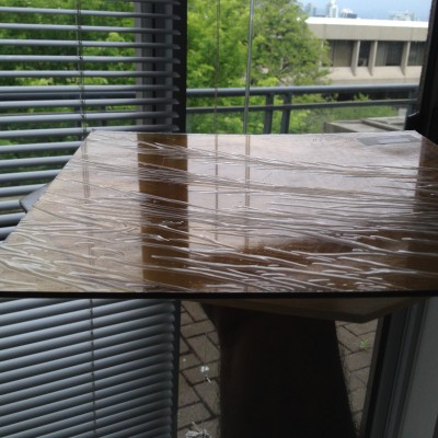

Not sure how informative that picture is going to be.
The part stuck on really well. Had to put the part in to the freezer to get it to release. I should probably dial down the bed temp.
Once the bed comes up to room temp i'll put it up against my window (flattest thing in my house) and report back.
						Re: PEI print bed surface experiments
The 3 mm pei is slightly bowed. When i put it flat against the window and apply pressure from the center the edge rises 1.5-2 mm (eyeball measurement).

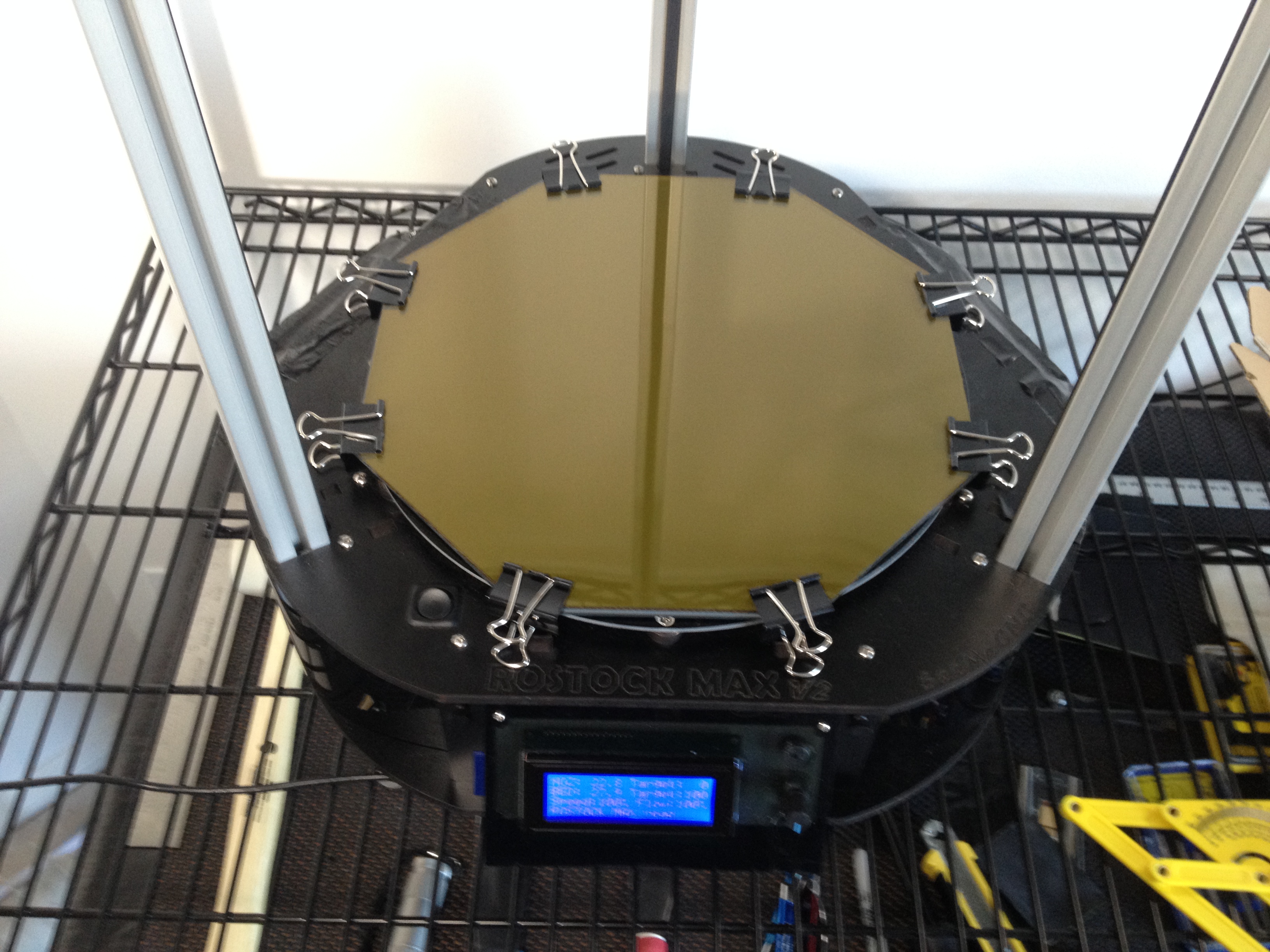

Currently i am not mashing my abs in to the pei, first layer is 0.3mm.
I am getting very good results with 50 deg C bed now.
It still sticks on a bit too hard. But i can unclip the pei, flex it a bit to remove the part.

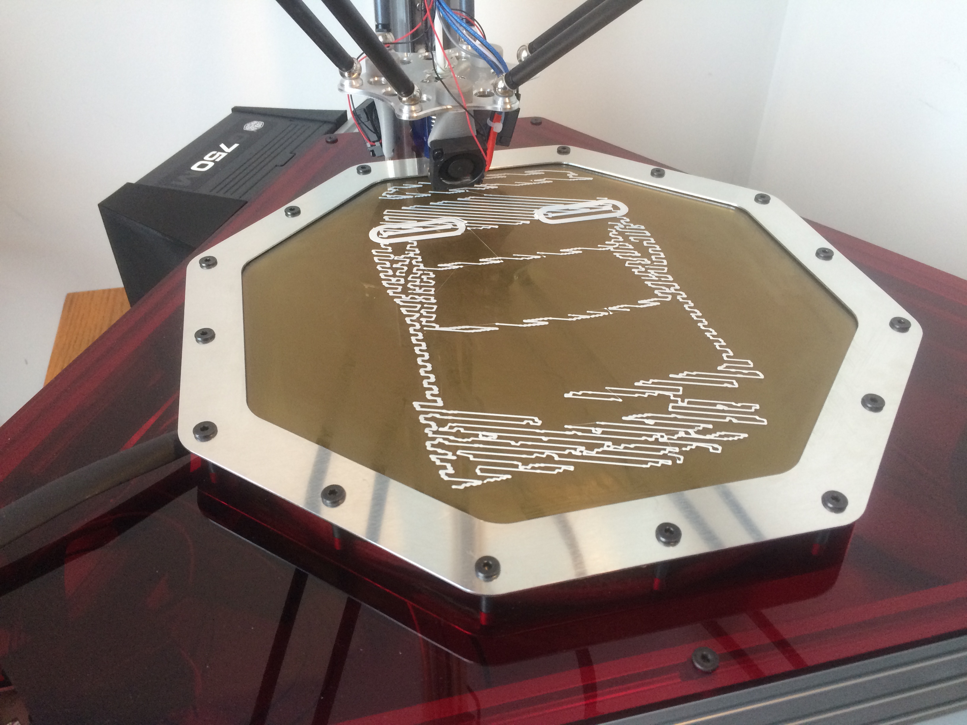

@teoman and @everyone - don't use acetone on PEI. This might be what's leading to some of the inconsistent results I've read. PEI can dissolve or craze and crack with acetone. I've observed the crazing myself. Much safer (and effective and SAFER to the human) is isopropyl alcohol - it removes finger oils, etc.
I print ABS on 95° PEI (amazon and McMaster) at the precise layer height (usually .20mm) with no problems with both adherence and ease of part removal.
