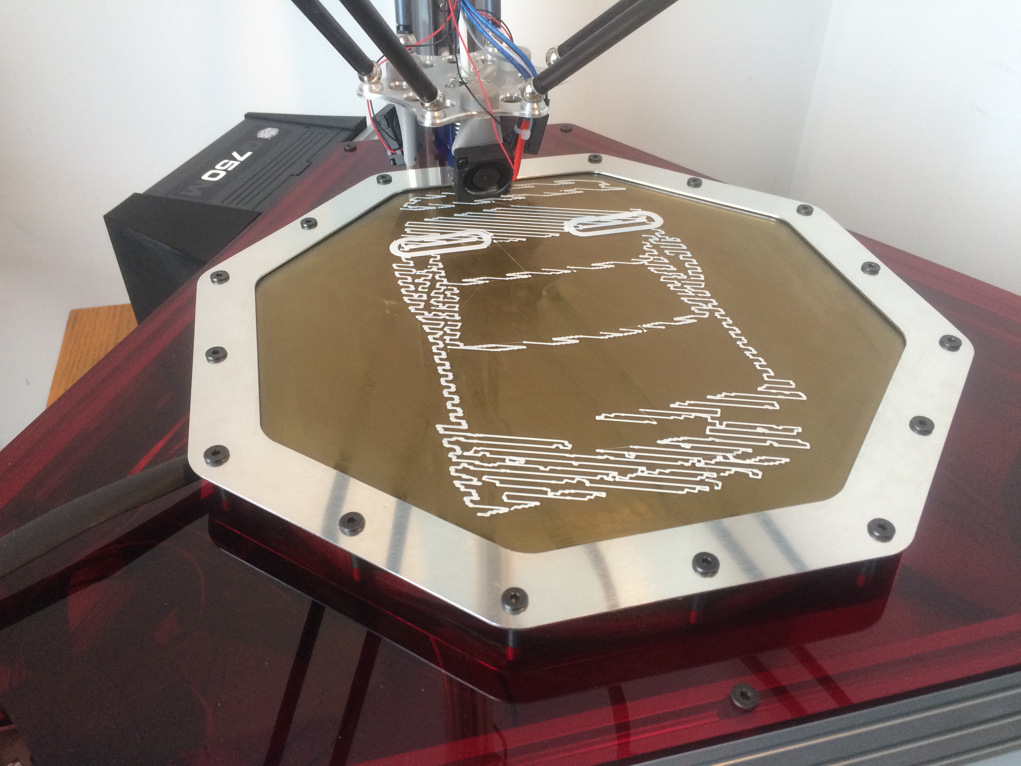

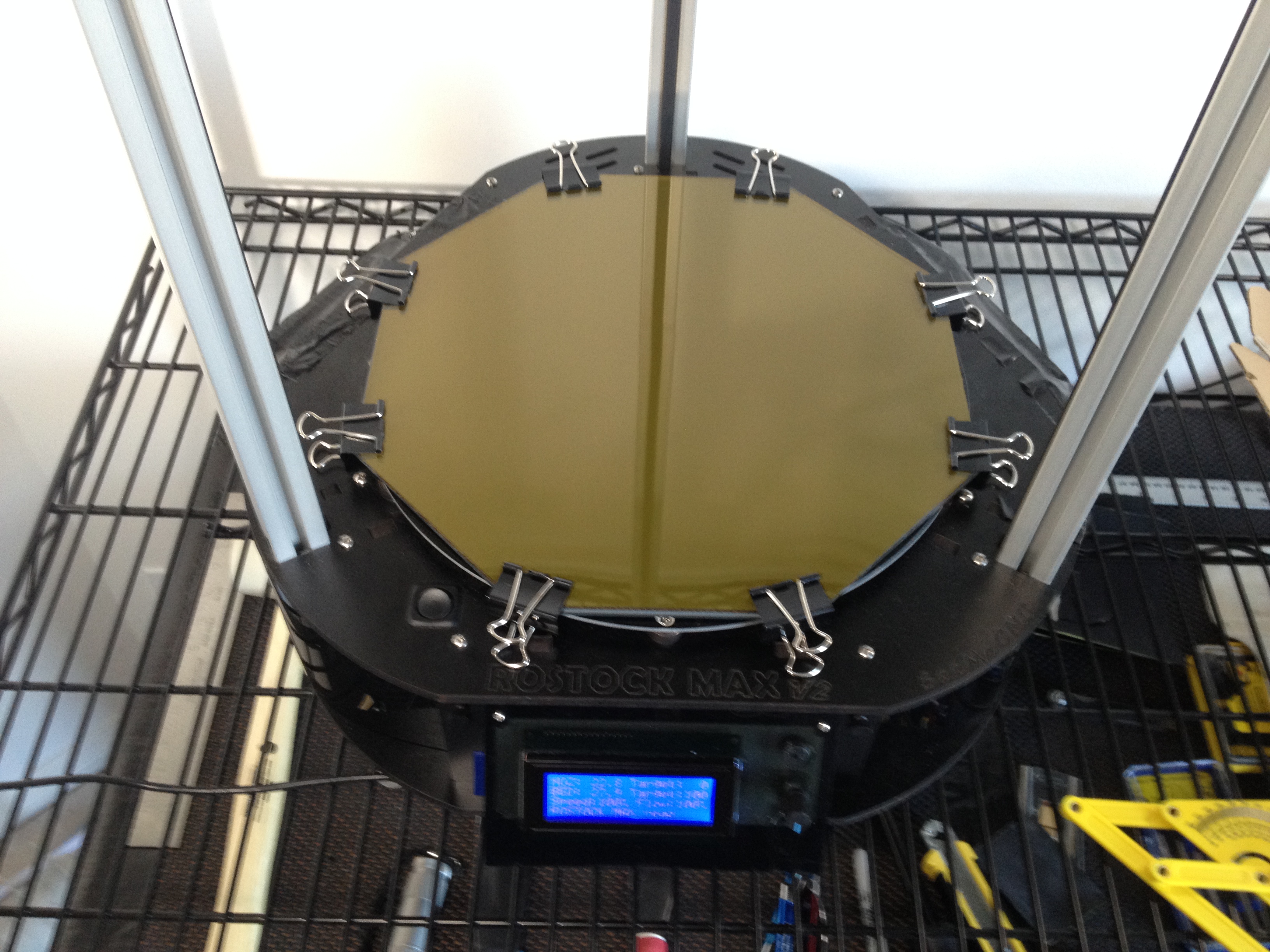

My 3mm arrived. I have clamped it on and it is printing nicely now. No adhesives!
I removed the glass plate and put pei directly on the AL.

I'm very interested in this option. Could you take some photos please? How flat was your sheet? I am concerned about bowing and having a hump somewhere (even .05mm would be a pain). I wonder if there is some light tack option to hold this stuff down.

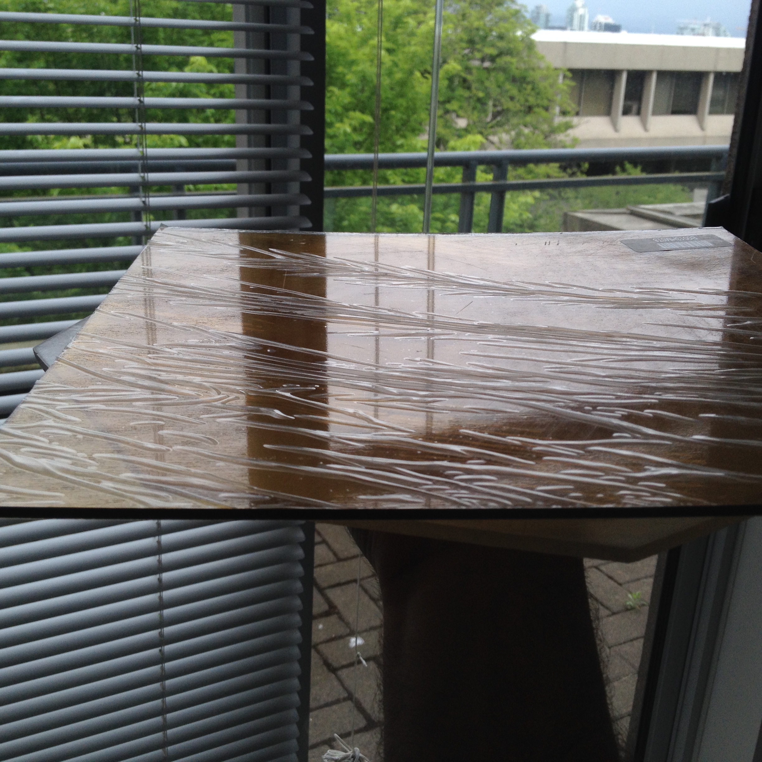

Not sure how informative that picture is going to be.
The part stuck on really well. Had to put the part in to the freezer to get it to release. I should probably dial down the bed temp.
Once the bed comes up to room temp i'll put it up against my window (flattest thing in my house) and report back.

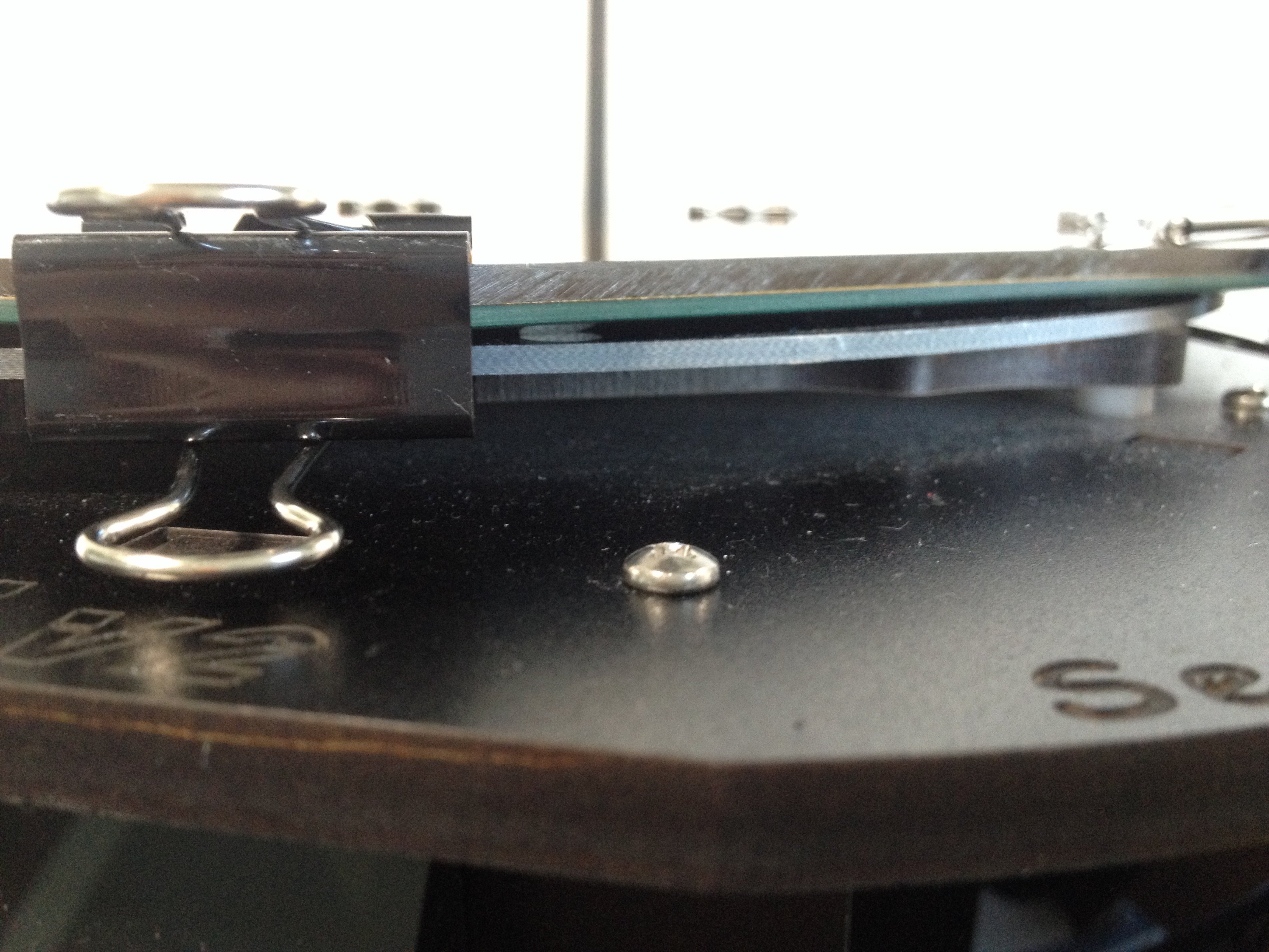

The 3 mm pei is slightly bowed. When i put it flat against the window and apply pressure from the center the edge rises 1.5-2 mm (eyeball measurement).
