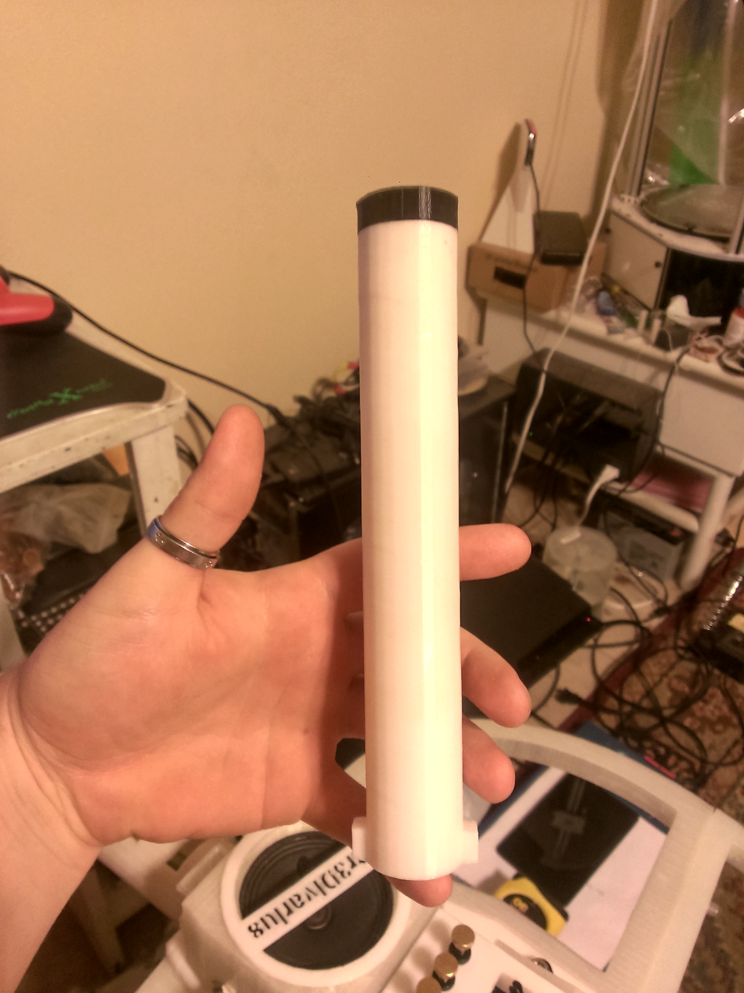

An endstop I designed for my 3D printed cello was made in the manner which bot just described.
I made a "dual extrusion" model where in two separate files could be combined in a graphics program and it would be the "final" desired object.
I made a 200mm tall Cylinder, and then made a 10 mm cylinder file which rested exactly 200mm up on the Z axis.
When all was said and done, I had a part with 200mm tall of white pla filament, and at the tip, I had a 10mm puck of Black Ninjaflex.
Both pieces were two separate gcodes. I had the first gcode set to print 200mm tall, retract filament, home, and remain heated up.
The second gcode was set to begin printing 200mm up from the bed, and by then the filament had been manually changed out with the ninjaflex.
pics or it didn't happen.
