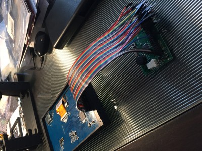

I have successfully updated the firmware for the PanelDue and calibrated the 7" touchscreen.
[img]http://www.perrydice.com/images/day2-panel.jpg[/img]
Now to create the extension cables like 3D-Print did here and here.
I just want to send a huge :D THANKS :!: to all the people that have preceded me in upgrading your printers and posted your knowledge on these forums. I couldn't attempt this without your guidance!
EDIT: I also updated the firmware over the network on the Duet and updated the DWC files. Very slick process. Thanks for your guidance mhackney!
