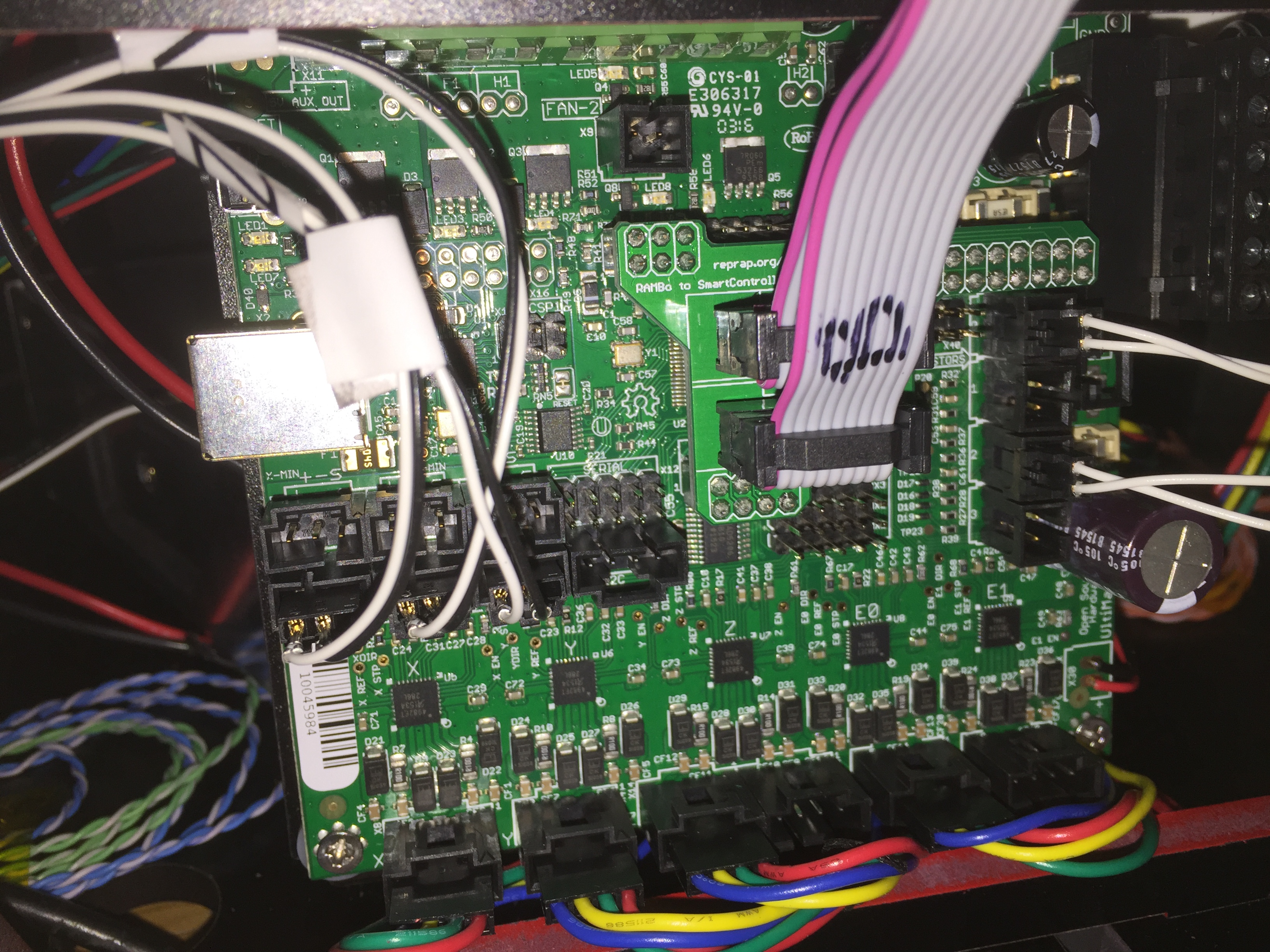

OK - First real bump in the road.
Want to say first that SeeMeCNC has been great about shipping out a part that broke during assembly. They're fantastic.
The problem: My LCD lights up blue, but doesn't show any block. I haven't uploaded the firmware or anything yet. I'm back looking at the RAMBo. Anyone have good troubleshooting tips? Should I go ahead and upload firmware?
Specifically -
Finished mechanical portion of the build.
Smoke Test passed with no smoke.
LCD blue. If I had to guess, the contrast is wrong. (Red PCB on the LCD.)
No blocks.
Thanks for any guidance.

Upload the firmware and THEN worry about the display if it's not showing up. :)

I was just re-checking my wiring and thought I'd upload pics in case anyone catches anything I didn't.
After firmware the LCD is "on" but there are no letters visible. Just a uniform blue.
Hmmm. I also rechecked my configuration.h file and its correct.
Ideas on where to go are slowing down... Guess I'll fiddle.
