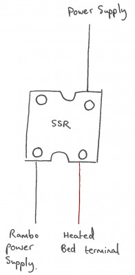

Thanks Xenocrates very helpful info, so I have attached a quick diagram of how I think it's supposed to be wired, let me know if I have understood you correctly?

[img]http://figures.oreilly.com/tagoreillyco ... 43-web.png[/img]
more like that. You need all 4 wires connected. Admittedly, the input is not 5Vs, but I stole that ready made. Red wire from rambo to the one labeled input 5V (3), and black wire to ground.
