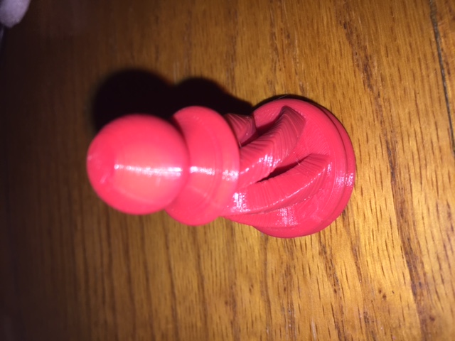

Belt Tension Issues: OK - so I took a perfectly good (OK - clearly not perfect) printer and tried to print BigBadBison's spiral chess set. The spiral legs had irregularity to them, and I thought - OK - some backlash causing wobble. I tightened them. The sound of the steppers wasn't quite a smooth, and a repeat of the pawn showed no improvement, so I backed off the tension. Then things when to heck in a handbasket.

[img]IMG_3583.JPG[/img]
How would you guys troubleshoot this irregularity? I've tried two different slicers. Now I'm recovering from my distaster, but once the thing is functioning again, what changes do you suggest for the irregular spirals?
