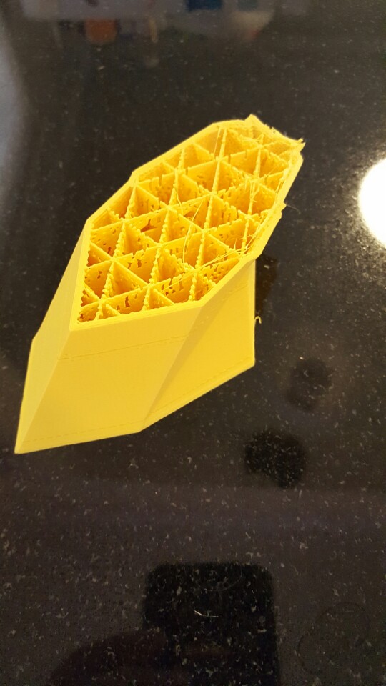

Hi all,
Recently I started to get some mysterious defects in print quality. Would like to get your insights and try them out to improve.
This print, I stopped in mid-print as the problems were too prominent.

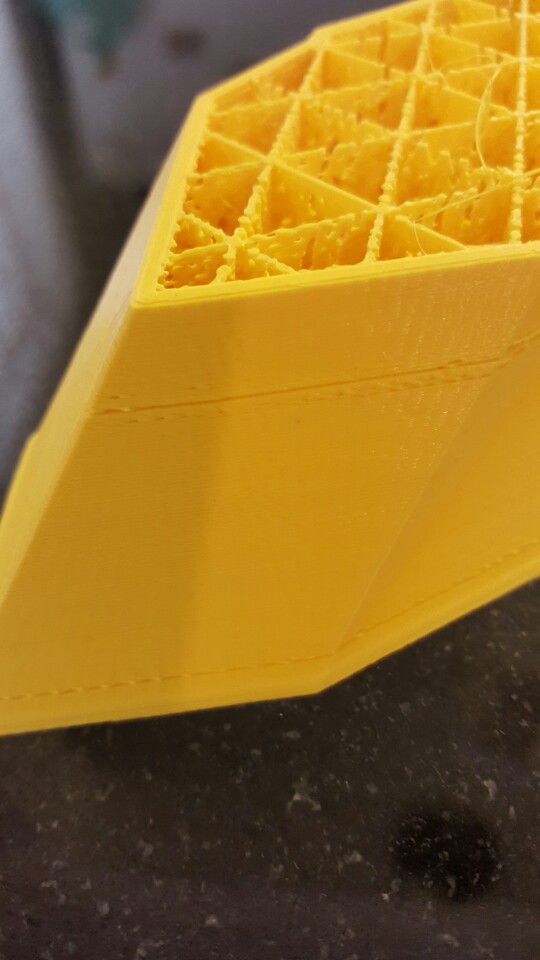

1. Randomly-appearing
skippy layers on the outer perimeter, which I cannot figure out as the inner perimeter and infill do not seem to skip the same layer.
2. The outer skin has these slight wiggly waves everywhere. It used to print just fine a while ago.
3. Swiss-cheese-like infill. I checked the extruder when the infill was printing to see if it stops and continues, but the white hand-turning-gear was slowly but continuously running so it's very hard to figure out what is causing it. The fact that outer/inner perimeter does not share this issue makes it difficult to assess.
It's really puzzling as some of these short-skip-within-the-layer thing is somewhat continuous between different layers.
------ added
I have Rostock V2 with E3D lite 6, 3 effector fans and stock EZextruder(calibrated).
The filament is Protoparadigm PLA yellow extruding at 200'C. Using Mattercontrol via USB(I tried SD card print and it did the same)
