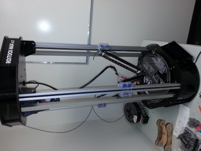

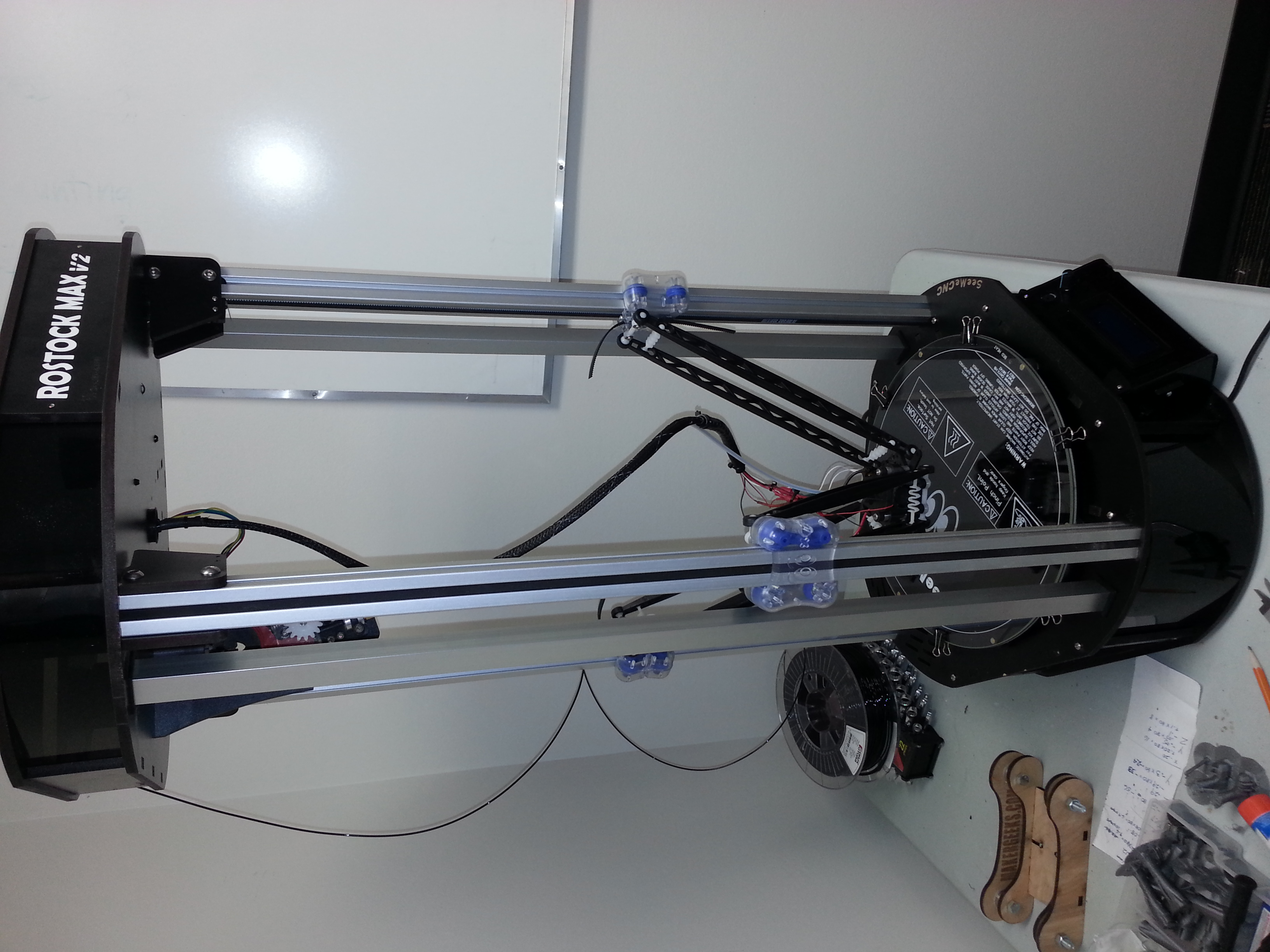

I've reached a point where I'm actively planning to add another extruder, fans and maybe some LED lights to the hot-end carriage. During the initial build I thought I would be clever and install extra wiring for this future upgrade but I found that it was impossible to get more than the minimum required wiring through the extruded aluminium towers.
I could just run the wiring up from the Rambo on the exterior loosely, or in a sheath, but this will look unsightly. I might try to install some kind of stiff plastic tubing as conduit but before I do I was wondering what have other people have done to add extra wiring and make it look "professional"?

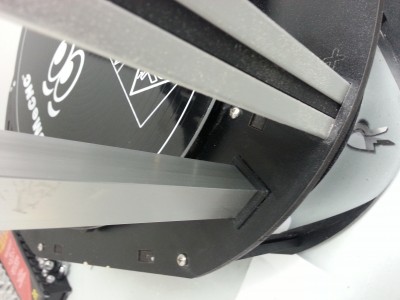

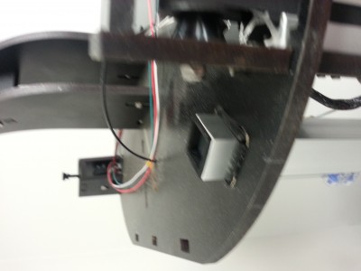

When I rebuilt my Rostock Max, I did something similar to what Eagle says, but instead of using plastic tubings I've used aluminum.
I really like using this hollow bars for all the wiring. The only thing that runs though the T-slots is the endstops wiring.
Aesthetically is a bit different than a Rostock Max v2, but you can still do the same. Just make some holes and check that the cheapskates can run freely.
Here are some pics:
2 aluminum hollow bars connect the the top plate with the rambo section. Make sure to smooth the edge, if not it will cut the cables when installing them. Believe me

An M3 bolt prevents the bars from moving.

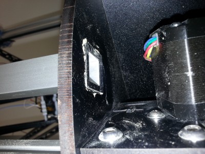

What's that iron-looking bolted plate surrounding the upper tower mounts?

Tincho redid a large amount of the laser cutting for his Max V1, so that plate is a reinforcing spar for his upper plate. It's just painted laser cut MDF.DeltaCon wrote:What's that iron-looking bolted plate surrounding the upper tower mounts?

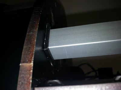

Well I finished installing some extra wiring channels this weekend. I used Tincho85's idea (thanks) and added a couple of things.
Used 3/4" (19mm) square aluminium tubes to give me LOTS of extra space. As I mentioned before I moved them to behind the X and Y towers since the Max V2 seems to have a lot of vent holes beside the Z tower.
I knew I could never cut the holes as nicely as Tincho85 had done so I printed up some square "grommets" to finish around the holes. The bottom ones have a lip on the lower inside to prevent the tube from sliding through. This does away with the need for the cap screw on the top side. The lip also helps protect the wiring from rubbing on the metal tube edge, but I filed aluminium edges with a smooth bevel anyway.
The top grommets were done a little different. They have no inner lip. This allows the tube to slide completely through enough to let it swing into place and seat into the bottom grommet. They do have a lip on the exterior to let them snap into place and stay up.
The upper holes are bit more ragged. I didn't notice how much until I saw the pictures. I may touch-up the edges with some magic-maker. The grommets are only 1mm bigger each side to cover the edges so I probably should have made them a bit bigger.
The insert in the top of the tube is just some more wire protection.
The tubes do clash a bit with the cooling fan.
I could move the fan to the Z tower side but I want to add the other two anyway so this clash will still be an issue. Right now I will just reduce the print diameter. Eventually I will try to design some fan shrouds that move the fans closer to the print head.
