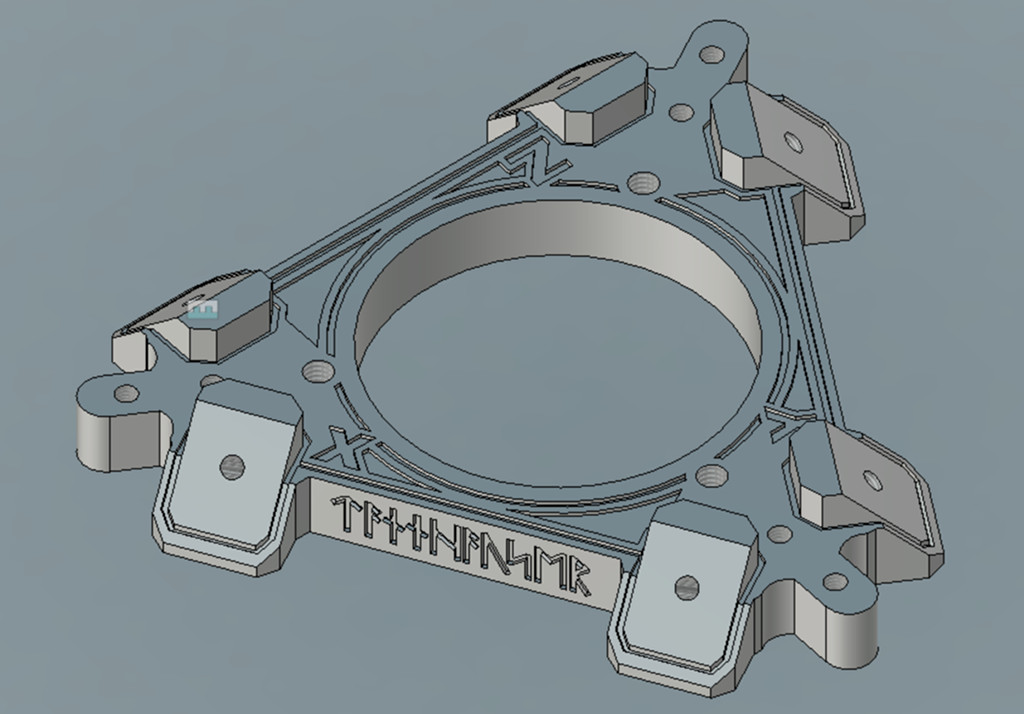

In September of 2016, I bought a laptop with a 17" display, and installed Autodesk Fusion 360. I had thought to import all my SketchUp stuff into it, and go from there, as there is an importer. However, what gets imported is meshes, not F360's abstract breps.
If you create a cube in SketchUp, you get a solid object with eight vertices and six faces. If you then import that cube into F360, you don't get a solid object. Instead, you get twelve triangles that happen to look like they form six faces. Most of F360's tools are designed to work specifically with breps, not meshes, so what you import isn't very useful right off the bat.
F360 has what I guess is a curve-fitting algorithm for trying to convert that mesh into a cohesive object, but it isn't perfect, and is more likely to fail the more vertices are involved. There is also the question of the quality of what comes out of that algorithm. If the vertices are off even a tiny amount (because SketchUp stored them like that, or because F360's algorithm didn't quite figure them out right), your geometry will have errors. For anything complex, or that has to be dead accurate, I wouldn't bother.
When I decided to transition my magnetic arm effector and carriages from SketchUp to F360, I found it more useful to take measurements (something SketchUp is very good at, and arguably easier than F360), and translate those measurements directly into sketches in F360. The result was quite nice:
It took longer to design this effector in F360 than it had in SketchUp. However, in exchange for this, I got geometry that was guaranteed to be exactly perfect, with no vertices being moved around or any other funny business. Because F360 is a timeline-based modeler, if I wanted to change something, all I had to do was rewind the timeline to the right place, make a change, and watch that change propagate forward. Occasionally, a change would break some dependency further down the line, but these were easy to resolve.
The basic unit of construction is as 2D sketch. Lines and arcs can be drawn and subject to linear and angular constraints. If you constrain one line to another, and move the one line, the other will follow. Constraints can be literal numbers, or they can be set to variables. If you change the value of a variable, it gets updated in all sketches where it's referenced, and then any 3D objects extruded from the sketch are also updated. Variables can also be used with 3D objects and operations such as chamfers and fillets, so you can change many of them at the same time, in a single step. I did a custom object for a friend of someone who uses these forums, and that object had about 30 different variables tied to various constraints. If she wanted an angle or length changed, I'd type in a new value, and the entire object would change instantly. It was quite amazing to watch. SketchUp has nothing like this.
Because importing to F360 is problematic, I decided to use SketchUp to maintain old designs, and F360 for anything new or that requires serious modification.
Things that stand out for me in F360:
- Timeline-based editing
- Never tweaks my geometry
- STL output is flawless
- CAM simulation & G-code output available for various 3+ axis CNC mills, including the 5-axis Pocket NC
- You can loft (morph) smoothly between two arbitrary 2D shapes; so if you want a handle that starts as a chamfered square and ends as a circle, it'll do that
- More primitive types, including spheres
- Ability to easily do repeating linear or circular patterns, and mirroring, at the sketch and object level
- Many, many more tools, which always work exactly as advertised, and without ruining the geometry
- Ability to counterbore and thread holes, although threading doesn't work right on holes that pass through multiple objects (last I checked). You can also do this in SketchUp, but threading is about as fun as a root canal.
- Directly imports and exports STEP and IGES files, so you can edit stuff made in commercial modelers (including all SeeMeCNC open-source CAD files)
- Allows physical modeling of hinges, springs, etc. - you can actually move assemblies relative to each other about their joints, as they would in real life
- Finite element analysis and other fancy stuff for engineering
- Pretty good ray-traced rendering system built-in
- The community support is awesome. Autodesk has a downloadable screen recorder that can upload a video of you trying something in F360 directly to their support forums, where others can tell you what to do, or send you screen recordings of how to do it the right way. I asked a few questions, and they were all answered within a day or two, sometimes with videos.
- You get all this for free as long as you're making under a hundred thousand a year.
