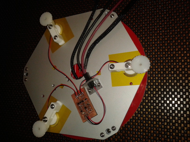

A late edit: Piezo disks, or at least my implementation, may need a sub frame if there is no space under the lower platform of the printer.
Photo shows view on bottom with 3 parallel mechanisms and an amplifier. Note the big Nylon nuts - made stiff to keep them from unwinding.

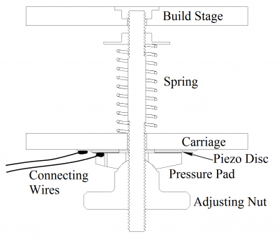

A quick update to the progress with using cheap piezo disks as Z contact sensors for automatic bed leveling. As hoped for, the Rostock printer has not suffered from the cross-talk from X and Y movement that needed a reduction in sensitivity on my Cartesian printer. The trip point on the comparator is now set to 0.1N, about 10 grams and bed mapping achieved a flatness of 0.05mm with a repeatability of better than 0.01mm. Reliability has been exceptional with only a single false triggering event in over 30 bed mappings (750 Z detections)
Xenocrates said that he liked to reduce complexity of systems. The parallel mechanism which I use can be eliminated if the piezo disk has a hole in it so allowing it to be mounted under any bed mounting springs. I tried drilling holes in some piezo disks and they seem very usable: The output is clean and capacity in line with the remaining piezo ceramic. Care needs to be taken and a very sharp drill used to make the holes. Photo below shows a 27mm piezoelectric disk which has been drilled 4mm and the piezo ceramic and top electrode removed with a flat drill bit.
Drawing showing how I see a drilled piezo disk being used

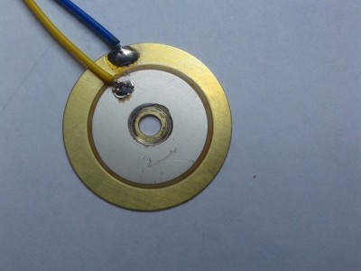

Posts: 5358
Re: Piezo disk bed leveling
It still blows my mind that you can bore a hole through the middle of the poor thing and have it still work.

Drilling the hole in them is definitely the trickiest part of the process. It seems I killed 3 or 4 of them and got one good one. (They work, but lost a lot of their sensitivity)

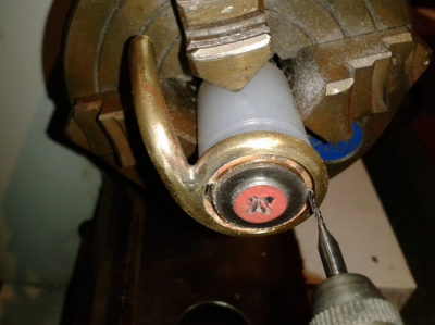

The brass with its ceramic coating seems to blunt ordinary drills after only a couple of tries. Tungsten carbide drills are much better but 4.5mm carbide drill bits are quite expensive. The best method I found was to mount them on a bit of plastic in a lathe and use a small end mill bit in a rotary tool to machine them out. I haven't taken any pictures of discs being machined but the picture below shows the same operation on a slotted Berd type air tube.
The rotary tool is a Proxxon clamped http://www.thingiverse.com/thing:949748 in the lathe and the bit is a 1mm end mill £3.95 for 10 from China.
Edit: I have now put some pictures of the piezo disk being cut in a jig - on http://forums.reprap.org/read.php?1,635 ... msg-753999
