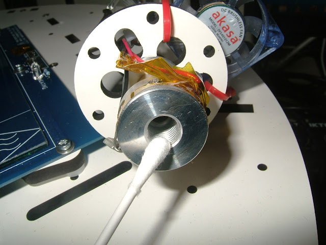

I had to heat the nozzle several times, to pick this last bit out. Cotton buds helped to grab the plastic and finally pull it out.
Cotton buds also proved to be a helpful tool to clean the inner part of the heating block as well as the threads:
[img]https://lh6.googleusercontent.com/-PvrP ... CF0510.JPG[/img]
I heated the block and used a dry cotton bud as well as soaking the cotton bud in acetone but only using it on the cold heating block, to prevent unwanted fire accidents.

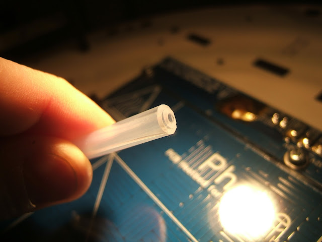

After disassembling and cleaning, it became clear, why the material was able to squeeze out of the tubes:
[img]https://lh4.googleusercontent.com/-BfNE ... CF0512.JPG[/img]
The inner tube was slightly dent at the tip. If this was caused by me, screwing the nozzle in a little bit too much, or if it was the sheer force of the filament, pressing against the nozzle, I don't know. I also noticed, that both, the inner and outer PTFE tubes are at the same length, where as the bottom of the nozzle is slightly gradient due to the drilling.
To solve this and to prevent the inner tube from being squeezed again, I took the following precautions: First, I pushed both tubes down into the nozzle, leading the inner tube to stick out of the outer tube for about 1/2 mm. Then, I cut off the part of the outer tube overlapping the inner tube at the other end of the assembly:

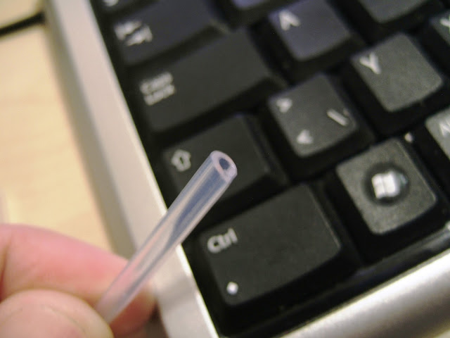

Then, I slightly beveled both tubes, hoping that more surface of the tubes ends will touch the bottom of the nozzle and the inner rim of the inner tube will seal the tube and the nozzle:
[img]https://lh6.googleusercontent.com/-uvfx ... CF0519.JPG[/img]
When assembling the hot-end back together, I had to find out, that there is still a bit of PLA stuck in the thread of the heating block, not willing to be cleaned out. So, I was forced to assemble as the hot-end was heated again. To get a better feeling for the torque applied to the nozzle, I used tweezers, turning them with my wrist, preventing to cause a leverage effect.
The first try ended with the filament stopping to extrude after the first two layers again. That's when I decided to stop experimenting for yesterday. Before shutting down the system, I recognised that I configured a drop in temperature of 10°C between the first and the following layers from 200°C to 190°C. I made this change right before trying out the reassembled hot-end. Therefore, this has nothing to do with prior jamming but could have caused the filament to interrupt extruding due to temperature related shrinkage. We will see tonight. I'll keep you posted.

By the way, my solution...I exchanged the relatively short inner tube with some spare tube which is 1.5mm longer than the outer tube now. So I am shure, the inner tube seals on both ends and it's not the outer tube which takes the force. Anoter change I made, was the fan position. I atached it with some cable ties first, causing it to have a slight angle downwards. I guess, this already caused temperature misreads.

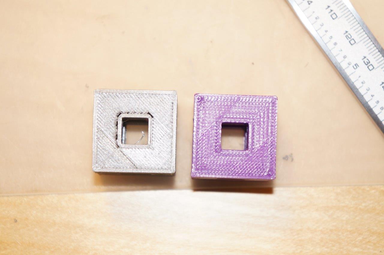

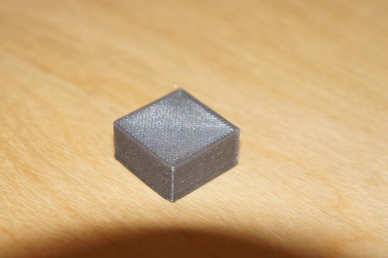

I got the standard 0.5mm nozzle and am printing 0.4mm layers.
Here my next prints @10 mm/s and 15mm/s for infill (half the speed than the prior print):
[img]https://lh6.googleusercontent.com/-8Zrc ... CF0525.JPG[/img]
[img]https://lh4.googleusercontent.com/-tviX ... CF0524.JPG[/img]
not exactely masterpieces and it is clearly visible on the fan bracket, that the carriage is not moving as accurately as it should, but its at least it is useable already.
Posts: 2417
Location: Redmond WA
Re: Highcooley's Rostock Max
Post by Polygonhell »
I'd drop the layer height to at least 0.3 and recommend 0.2, 0.4 ought to be OK for a 0.5 tip, if you can get a reliable extrusion width of 0.6mm, but I think the nozzle is fairly long and that reduces die swell.
How tight are you'r belts, infill not reaching the perimeter can be caused by loose belts.
I'm currently running PLA at 210C, 30mm/s for every print move, though I could certainly increase that, but I need to do some more tests.

It looks like your running too hot

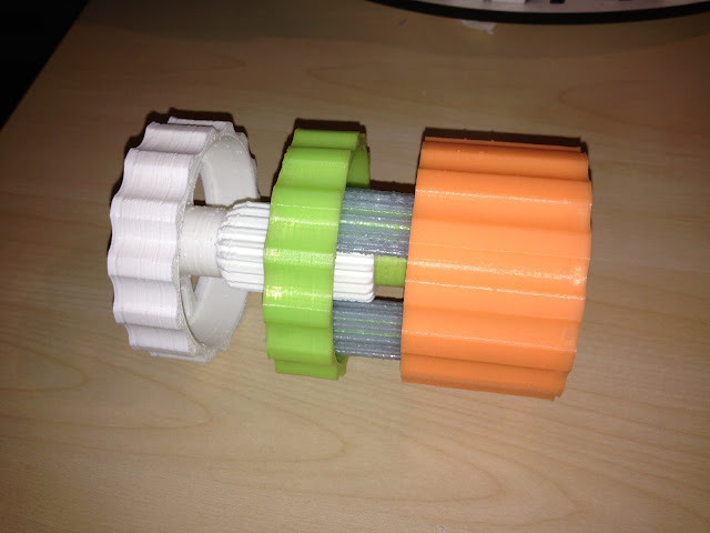

I finished the exploded planetary gear and am pretty happy with the result:
[img]https://lh4.googleusercontent.com/-KcPQ ... %25201.JPG[/img]
Despite the blue planet crimpers, all surfaces turned out pretty smooth.

Here is, what I was constantly working at since Saturday: http://www.thingiverse.com/thing:43983
[img]https://lh3.googleusercontent.com/-viJ4 ... CF0597.JPG[/img]
A pity, it came off the print bed, before the last couple of layers where printed. There should be a ring around the nozzle to distribute the airflow elegantly around the nozzle tip. However, the fan duct should still work good enough for the moment. I am looking forward to see, what effects the cooling air has to print quality and if the design works well enough and does not cool the nozzle too much. The mouth is still 1.5mm above the nozzle tip, to prevent crashes with the print. However, the inner ring should deflect the air stream from directly hitting the nozzle tip.
barnett
Posts: 215
Post by barnett »
I have not noticed problems with dimensions. The one thing that could have revealed a problem is a custom stand for part of my espresso machine. There are sections that I carefully measured before designing it and it came out great... by my standards, at least.
In KISSlicer, the infill extrusion width is a separate value from regular extrusion width, which I still have set to 0.5. So I'm thinking as long as the perimeters are correct, the fill is just a little more dense.
I'm intrigued by this cooling fan duct. So the purpose is to cool the plastic as it comes out of the nozzle so it will harden faster and span better without support? So do you have 2 fans going now?
If you're there when your duct starts coming off the bed, I might suggest taping it down. I did that yesterday on a tall print that was starting to wobble and it worked for me.

Yesterday, I took an approach to solve the infill not touching perimeter / backlash problem. As I already tensioned the timing belts quite a lot, I now went for loosening the too tight joints. As mentioned earlier, I suspected, that the rods first get bent during movement, before they actually move the carriage.
So, I sanded all of the rods as well as a couple of the mounting brackets to just make the joints sit tight enough, in order not to allow clearance but move almost completely free.
My first print after this measures still showed the same gap between infill and perimeter. I might reconfigure the correct esteps once more. What settings do you guys use? Mine was about 10% smaller than the Firmware preset.
Another thing I noticed is, that I get timing belt abrasion in the form of black dust collecting at the base of the driving compartment. On a closer inspection, I noticed, that this is caused by the timing belts grinding at the idler mounts as well as the aluminium rails. I tried to center the belts more precisely on the ball bearings, but without luck. Does anybody know this problem and has a solution?
Inspect your belts! I had that same dust collecting and it turned out a sharp set of gears was eating the belts!
I don't know that it's backlash. The belts on my machine are tight enough to play Jazz Bass on. :) There's no binding going on either. I'm at my wits end at this point. :(
