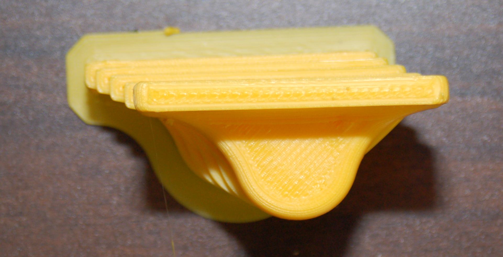

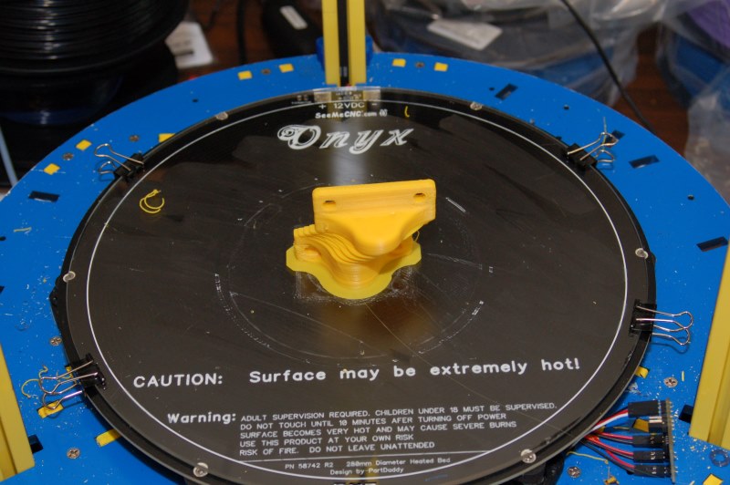

So I've got this weird layer issue going on with my Duet based v1 machines (both of them!).
After some period of time (the failure point varies with the size and complexity of the model.), the layers become diagonally offset.
Here's an example:
Top view of the same failure - this shows the diagonal nature of the shift.
Any suggestions as to what could cause this? It's almost as if there's a MOSFET overheating and resetting. I do have a fan blowing on the back of the Duet in Blue MAX, but not with Red Sonja, but the problem happens with both...

A much too high current on the steppers caused my x motor to be disabled short periodes where after it enabled again with a serious offset, due to overheating driver chip. In your case the offset is much smaller, so we might be talking about a slightly too much current perhaps? It was a rambo, but I guess that makes no difference.

Have you pulled the g-code back into a viewer just to confirm the problem isn't in g-code generation?
Posts: 5359
Re: Weird offset error...
I've got the current on the motors set to 1200 (1.2A). The slicer I'm using for this is S3D. Scrolling through the layers doesn't show any issues.

dc42
Posts: 454
Post by dc42 »
It could be that you have your acceleration set too high and it is trying to do a fast travel move that needs more torque than the motor is providing. What do you have the acceleration set to (M201 command in config.g), and what is the specification of your stepper motors?
