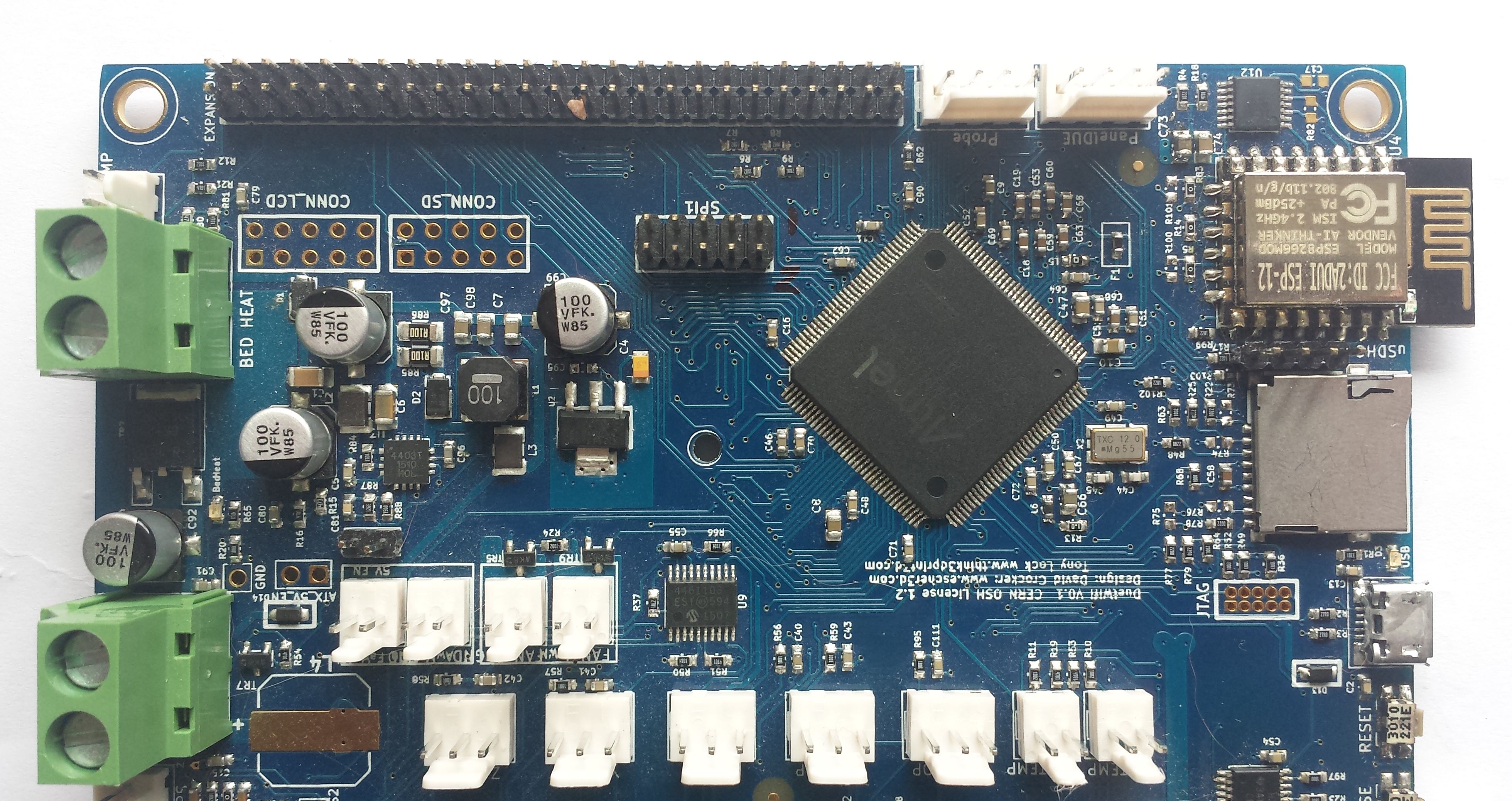

by dc42
Details of the Duet WiFi have now been published at http://www.duet3d.com. Yes, it does have new stepper drivers supporting higher microstepping - up to 256x in fact. Enjoy!
[img]https://dl.dropboxusercontent.com/u/193 ... .27.56.jpg[/img]

by U.S. Water Rockets
dc42 wrote: To replicate what the ESP8266 gives us (i.e. web server running on a separate processor), we'd also need an Ethernet-capable processor, flash memory chip, at least one crystal and a pile of support components. So not quite as simple and cheap as that. Nevertheless, we're looking into it. Atmel doesn't make any inexpensive low pin-count but Ethernet-capable processors - the smallest/cheapest suitable processor they do is the ATSAM3X4C, which has 84 pins and is way overkill. Perhaps another manufacturer has a more suitable chip.
According to your website, the new Duet uses an Atmel SAM4E8E.
The SAM4E8E is only available in a 144 Pin package (LFBGA or LQFP)
The image you posted of the new Duet confirms that you are using the SAM4E8E. I can read the part number and the pin count is 144 on your board.
SAM4E8E LQFP144 on Board
I find it odd that you would say an 84 pin CPU is "way overkill", while using a 144 pin CPU on your board.
I also find it a bit unnerving that you suggest that it was necessary to omit wired Ethernet because it would have forced you to pick an Ethernet Enabled MCU that you imply would negatively impact the cost or size of the board, but you fail to mention that the CPU that you are currently using on your boards IS already Ethernet Enabled.
That's right. The ATSAM4E8E on the Duet indeed has an Ethernet MAC built in.
All you need to add Wired Ethernet to the current board is a PHY (about $1.00) a crystal or oscillator ($0.50), an RJ45 with integrated magnetics ($1.50), and a handful of discrete resistors/capacitors totaling no more than $0.05 in cost.
I don't know what you're paying for those ESP8266 WiFi modules, but you show one with FCC certs in the image (I assume that you're not going to ship product with the certified modules, since you show it) and those cost about $5.00 each.
In conclusion, there is no price or hardware advantage to making a WiFi version over a Wired Ethernet version, as you insist in your post. Most everything you mention against Wired Ethernet is just plain factually incorrect. That does not give me warm fuzzies about the product in general.

One more thing:
People who clamor for WiFi can easily add Wifi to a Wired Ethernet device, but NOT the other way around.
Adding a Wireless Bridge to a Wired Ethernet device to allow someone to put it on a Wifi network can be done inexpensively. You can find wireless bridge devices for $15 to $20 (US). You can also use many Wireless Access Points as a bridge, and those are dirt cheap as well.
There is no easy way to add wired Ethernet to a WiFi only device. It can only be used with WiFi networks, and places where that is not allowed will not be able to use the device.

U.S. Water Rockets wrote:I find it odd that you would say an 84 pin CPU is "way overkill", while using a 144 pin CPU on your board.
That CPU is static, it has to be there its what is running the show. An extra 84 pin CPU for one extra function is way overkill because thats a lot of extra board space.
Also it seems you missed this:
dc42 wrote:To replicate what the ESP8266 gives us (i.e. web server running on a separate processor), we'd also need an Ethernet-capable processor,
The web server is on a separate processor in a package smaller than what is available for ethernet. The 84 pin CPU (what they found from Atmel) would be necessary to emulate the functionality they are getting from the wifi module, in addition to the current CPU on board. A lot of extra board space it seems.
From my point of view, they haven't lied about anything. They aren't using that interface because they don't want to tax the CPU with the web server load too.

I didn't miss anything. I dispute the need for a dedicated CPU for a Webserver, especially considering that the host CPU has Wired Ethernet built in that is going totally unused.
Web Servers are not complicated, and they are not huge consumers of bandwidth. If you need an extra CPU to host a web server, then you're not doing something right.
Besides, who said a 3D printer needs a web server? You could write a simple FTP server and FTP the files in that way, if porting one of the Open Source Webservers to the printer is too difficult.
It's a shame that an expensive feature of the core CPU is going unused, and an extra $5.00 is added to the BOM as a workaround, simply because it is lacking software.
