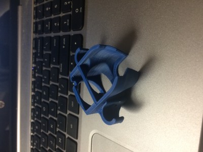

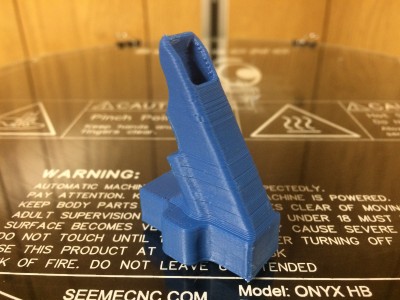

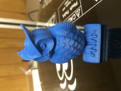

Hello, I finished building my max yesterday and printed out the peek and layer fan shrouds and a test/benchmark print (the owl). The max is stock except for astrosyn dampers.
I want to optimize the printer now, and will need a bit of guidance doing so. I do have a bit of experience with the makerbot replicator 2 and 2x, (and associated software) but that is it. I will need help interpreting print problems and coming up with solutions since this is my first delta.
I do want to do several upgrades, the main one being the e3d all metal hot end, but I want to get the printer dialed in as-is first.
Also, one question: I have a sneaking suspicion that pla will produce a much better quality print than abs will at this point. Am I correct?

What quality issue do you have with the prints you are showing here?

Each print is great, except for resolution. I think that it greatly needs a smaller nozzle.

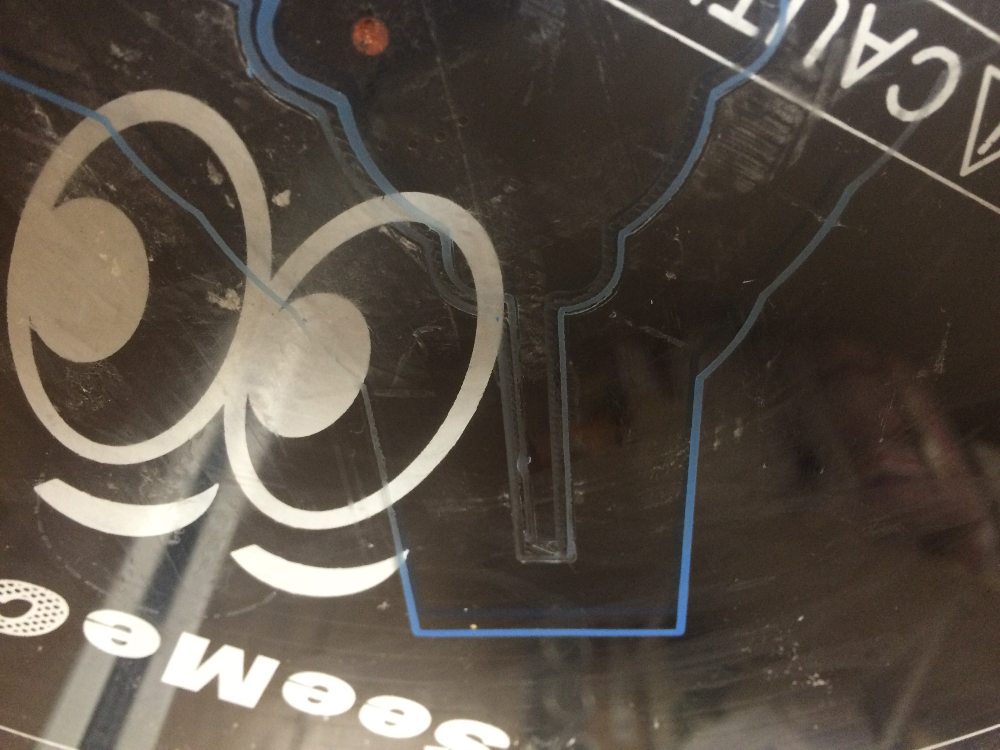

So an interesting issue has come up...
I tried to print a small millennium falcon model earlier today and noticed that at about the fifth layer it shifted directly over away from the Z axis and continued the rest of the print above that. I also noticed that in the layers view of mattercontrol the layer that started the shift was missing entirely. I immediately attributed that to a software problem.
I went and printed a test part to see if I could get it to repeat and it didn't.

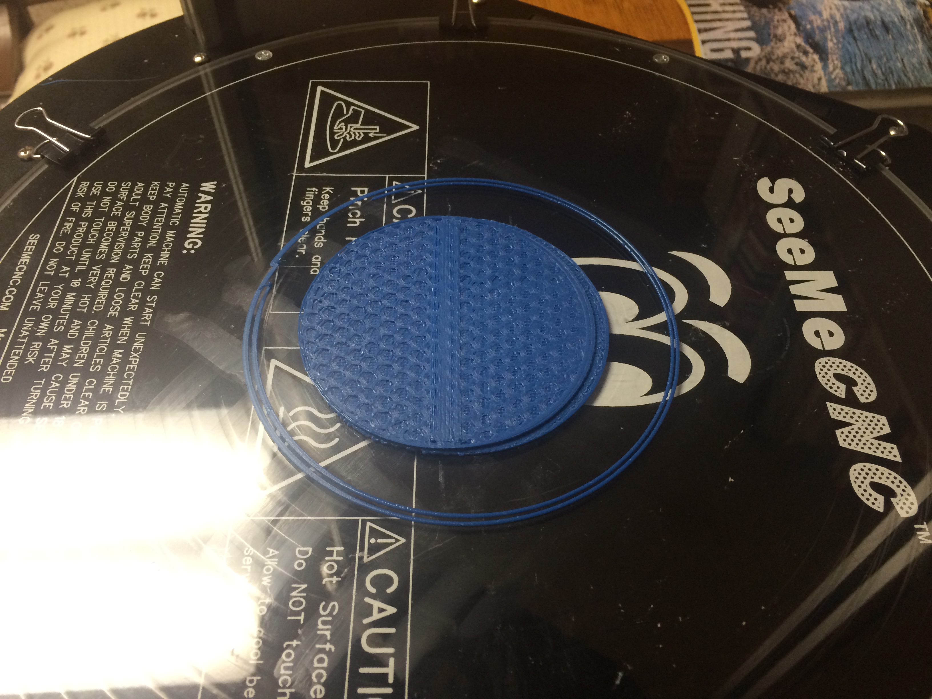

I then tried to print just a straight 20mm cylinder, which then proceeded to shift about a mm the same direction each layer.
I then tried just a straight cube. It printed fine.
Is the problem software? As I mentioned I am using mattercontrol with mostly stock settings.

I just stopped another print because of the shifting problem. This is getting frustrating. I can't get it to repeat the problem, which leads me to believe that it is a software issue. I will try deleting and reinstalling mattercontrol.
Suggestions?

Almost unheard-of for that to be a software issue. It typically happens when the part curls up and the nozzle snags causing the motors to lose steps, slicer travel speed too high causing missed steps, motor currents set too high or too low, causing overheating or insufficient torque and thus missed steps, loose grub screws on the pulleys allowing slip, incorrect belt tension causing overload or slip, or binding or interference somewhere in the mechanics.

Also I just noticed that it seems like my print bed is slightly bowed. It extrudes fine at the edges of the print but pinches off any filament towards the center. How can I fix that problem? Is there a way to account for a bow?

It's just a matter of eliminating possibilities. Check belt tension in accordance with the videos and for evenness. Move the effector around by hand and check for binding. Check the firmware for the current setting you're using. Check if the motors get uncomfortably hot during use. Watch or tape a print and see if the nozzle hits the print.
Being high or low in the middle is adjusted by the procedure in the build manual (paging geneb to the white courtesy phone).

Ok, time for me to give y'all some actual information:
My belts are tensioned as per the directions, if y'all have any way to put a numerical value to it I'll adjust accordingly.
I went back and and found a video on calibration. It was immensely helpful, as I didn't know that I had to calibrate the z height each iteration. I then calibrated the end stops and noticed that I had to raise the z axis screw by 3mm more than the x and y.
I think that that has something to do with my problem as the print tends to lean away from the Z axis.
Also when I tried another test print it worked well on every side but the Z, where it was too close to the bed and extruded very little.
Also the motors were all very warm, they became uncomfortable after a second or two.
And here's a picture of the underside of the print to show the shift:

I recommend you double check your motor current settings. Your motors should not be uncomfortably warm.Fearoflightning wrote:Ok, time for me to give y'all some actual information:

Also, verify your X, Y, Z aluminum extrusions are perfectly set in the base/top and all the way seated to the stop screw. I would also disassemble the heated bed assembly make sure all is clean and it remounts perfectly. (3mm or more difference on your end stops is substantial)
Perform another calibration after your axis and heated bed is verified/adjusted, you may have to perform this multiple times (at least I did)

I did a thorough check of the printers construction today and found the problem. The gear on the Z stepper was slightly loose. I must have missed the flat spot on the shaft.
After a good bit of recalibration (screw problem fixed) print quality improved greatly, however the steppers still get pretty warm.....
How do I check the stepper current?

Stepper current is usually set in the firmware. you're looking for the line
I have mine set at 155,155,155,165. Reducing the numbers should lower your temperature. However, this reduces your available torque (And thus your available jerk/acceleration) somewhat. I would dial it back enough that you're comfortable, however it seems that the issue wasn't related to motor current at all. Steppers will get somewhat warm. You have two options from what I can see. Either cool them better (Heatsink, fan, waterblock. Doesn't matter much which), or reduce the power which reduces torque/performance. You don't need the utmost out of them though. So if you're not going to try for maximum speeds, you don't need to worry about it much.#define MOTOR_CURRENT
