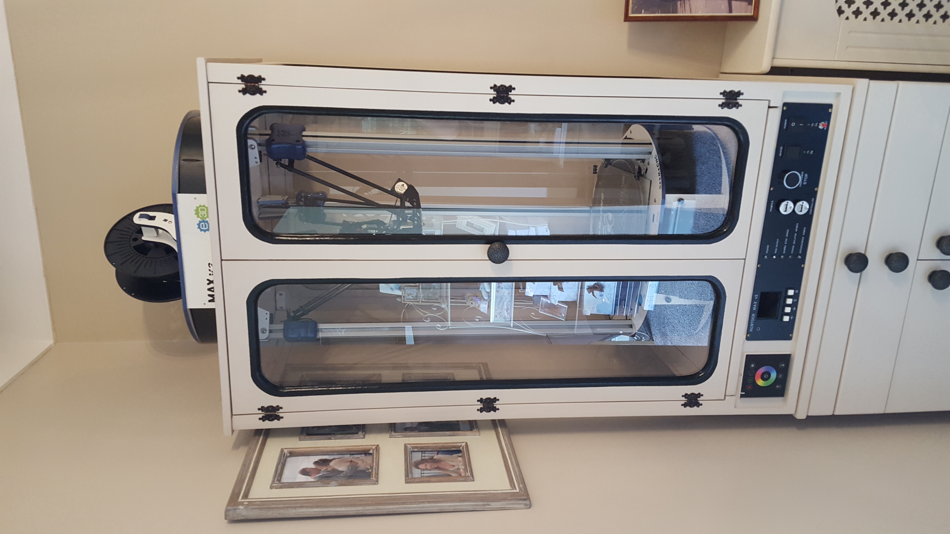

				Finally got around to starting the heated enclosure for the printer.
Coming along nicely.
Written some Arduino code that will control the temps with lots of sensors options etc.
Also adding a spool weight monitor (because I found a spare weight load cell in the workshop!), a fire system, safety power cutout etc.
RGB leds in the chassis, cabinet and on the printer also controlled by the Arduino.
All good fun

				Few more pics (they seem to turn the correct way around when you view them).
Trial fitting.  Seems to fit very well
I made a base unit for it as well, so I can store my filament etc in the bottom, along with a shallow 'tools' draw and a deeper one for the dedicated laptop.
Pretty easy to lift it in and out.  I am going to fit some guides for the printer to sit in, and then you just clip the top panel in place.
Probably put a rubber seal around the top to stop heat escaping out of the 3mm gap around the top of the printer.
I wanted the spool outside the cabinet for easy changing and future mods.
Polycarbonate 4mm windows. Good for well over 100 deg, and I don't plan to go anywhere near that.
Once all the electronics are installed, I will update all of that.
Perhaps I should sell these babies!

				Nicely done, but my concern is about having the electronics and the stepper motors inside the heated area.
Your thoughts?

				Re: Max V2 heated enclosure
				Posted: Fri Jun 24, 2016 10:28 am
				by Stevolution
				Heat rises is my hope!
I have a pretty powerful 12cm fan pushing clean air from outside up directly through the ventilation grille on the bottom of the printer (see the grille in the base).   I will probably add a ring of foam to seal the fan to the base of the printer while its sitting in the cabinet.
Then, the air is extracted through the side of the printer base by a second fan (right hand side of the printer base) and out through a different grille.
I am going to print a duct to direct that air (designed, but not yet printed).  So it does have a nice flow of air.
Plus, the upgraded PSU has its own cooling fan.
Anyway, I am not heating it up to silly degrees.
There will be a temperature sensor top, middle and bottom... plus I added one to the RGB ring on the hotend when I installed that.
So, I can select any one of the sensors, or an average of them all to monitor the temps.
The control software runs the heater to keep it at my required temperature.   I can set the amount of 'drop' in temp before it re-activates the heater to stop the heater oscillating on and off too much.
I can set a 'beep at temperature, and an alarm at temperature (local beep or much louder sounder).
Also it has an emergency system at a presettable temperature or upon pressing the STOP button on the front.
Either of these trigger methods can be set to stop the Rambo, turn off all power (until you manually reset it) or operate a fire extinguisher.  Or any combination of the above.
The STOP button will probably  be left set to just stop the Rambo, and the rapid increase to a set temperature alarm (say 90 degrees) will kill the power and possibly set off the remote extinguisher (which you can also set the duration of).
There is also a built in timer for the heater. 0-99 hours.
I also added a weight function.  What I will do with this I am not sure yet. I can connect to the Arduino with the front panel USB port for future upgrades etc.
I designed a spool holder that incorporates a load cell, so I can weigh the amount of filament left on a drum.
I might add a facility to 'store' the weight of the different filaments and therefore have an idea of the amount remaining.  I know we have the 'amount used' function on the Rambo, but I thought it was worth playing around with.
Just finishing the RGB led control software in the Arduino, and then I can get on with installing the electronics.
For the RGB leds, I have an IR remote control, a touch controller (left hand side of the control panel) and a selection of 'preset' modes.
For example, fading from one colour to another depending on the temp (start at blue and fade to red as it approaches the required temp)
All good fun

				It looks really great. How much did you spend in parts do you think?
				Posted: Sat Jun 25, 2016 6:10 am
				by Stevolution
				I think we are currently around £150.
Off the top of my head....
£40 MDF. £10 hinges.
£40 Polycarbonate (custom cut online and delivered)
£8 for an Arduino 2560
£2 for the panel mount USB outlets (they are £1 shop car USB cigarette chargers adapted) - much cheaper way
£6 for the 2.2" TFT screen
£2 for the push buttons
£6 for the 12cm fan
£2 for misc electronic parts (like the MPC9700 temp sensors)
£16 for 2x pairs of draw runners
£9 for a touch RGB led controller
Already had the paint, panel leds and the handles + other fixtures (like the fan grille)
I have a huge stock of electronic parts in my workshop, so lots of bits I already had.
If you bought all the parts, I expect we would be over £200

				Well finally got time today to install the heater modules.   Its works better than I could have hoped to be honest
I bought a pair of 500w ceramic heater modules from RS. At £8 each I thought they were pretty good.
Built a reflector and support arrangement with a mesh cover.  Each heater pulls around 2A, so a 13A Euro style plug worked great as a connector through the cabinet top.
I can simply unplug the modules and take them out.
I can heat the chamber to 50 deg in about 4 minutes.  What has surprised me the most is how long it retains that heat before it needs to switch the modules back on for a top up - its a good 10 minutes.
