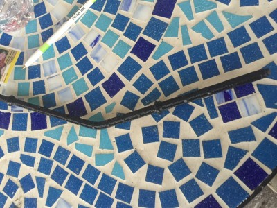

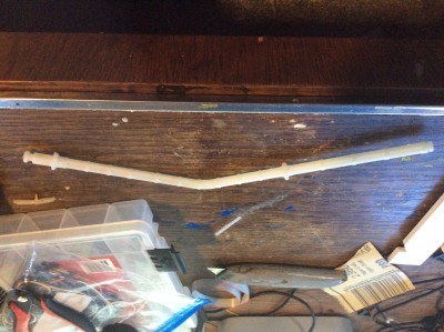

White abs
First paid print in the Romax. ROI: .018 :D

Qdeathstar , do you have any idea what these would be used for?

He asked me to keister them in. I'm assuming they are either for a shiv or as he put it "post apocalyptic steampunk spider helmet"

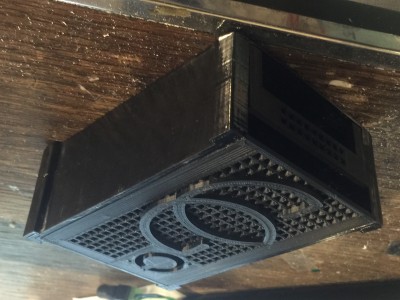

Case for a raspberry pi and hard drive...

^while I wait for my enclosure, there were a few small cracks in this on the corners. I used an 3D pen to fill in the cracks, sanded it down and abs'd it. Looks nice, imo.

Try this as well " http://forum.seemecnc.com/viewtopic.php?f=36&t=5524 " I have always had good luck doing it this way.

Nice idea... Sanding the abs back flat was a process.

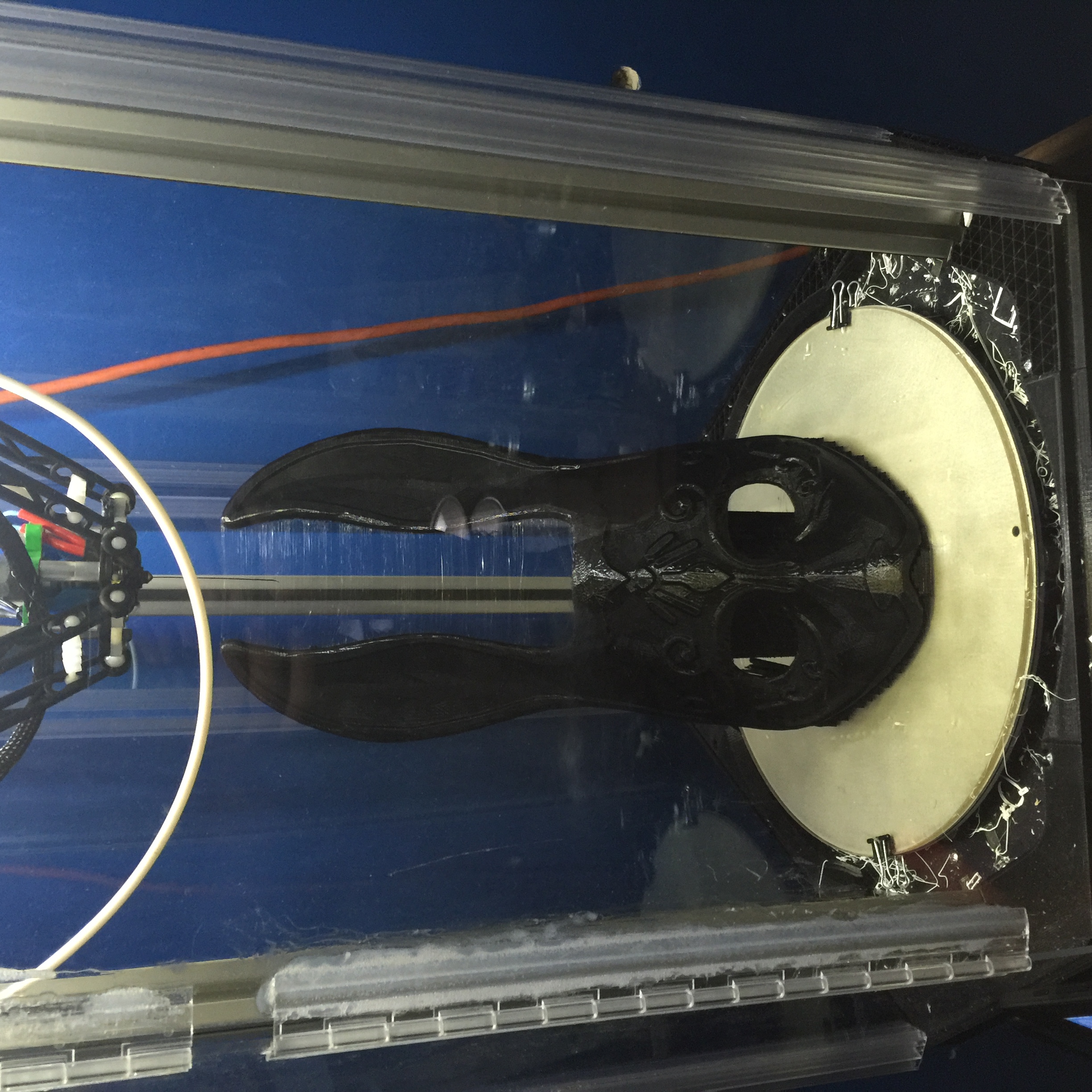

I got another print ordered for $68 for a single print... It's almost the full tallness of the printer.

So far the big print is going good, but I'm dangerously low on the filament. And I gotta go
I can't get filament delivered until tomorrow... So I'm debating on whether to risk it and keep printing or pause it and hope it can restart after a 24-36hr pause

It is unlikely you can restart after 36 hours. I would scrap it and plan better next time. Keep whatever filament you have on the roll for a smaller print.

Well, there ain't nothing on the roll and the print isn't finished... I'm going to give it a go and see what happens... I'm printing off an SD card so maybe that improves my chances...

Well... It didn't work. It would have, but then hotend and heat bed automatically shut off after 30 minutes.. But, I thought that if I pressed "resume" the printer would know it was too cold to print and reheat the extruder/bed.
But nope, just started moving about and smacked the model off the bed. If I had of used the menus to increase the bed/hot end temp first I'm sure it would have been fine
So... Another 16 hrs it is.. At least pla is easy to print. After printing exclusively with abs for the past few months and having to constantly check on it (I think that has been fixed now since I increased the bed temp from 85 to 105) pla is relaxing.

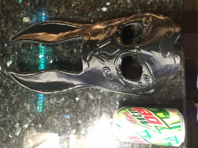

68 bucks delivered :)
As an aside, you see all that "stingy stuff" between the ears? Well, when I ball it up it sorta looks like cotton or lint... But that roll of PLA is brand new out of the package, so... What gives?

You're not the first here to get that as a 3dhubs job. It took several tries for the other person's to get that good. The stringing might mean your retraction could stand a little tuning.

I would have only taken me one try but I ran out of filament :angry:
So twice :)

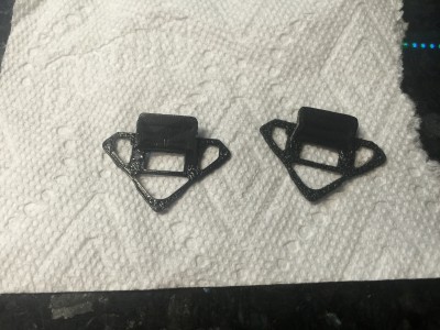

nother $4.97
Super small prints... With super thin walls...Couldn't get it perfect...

The one on the right fell into the acetone :( ... Only needed to print one...

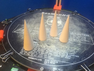

Woo hoo
9.17

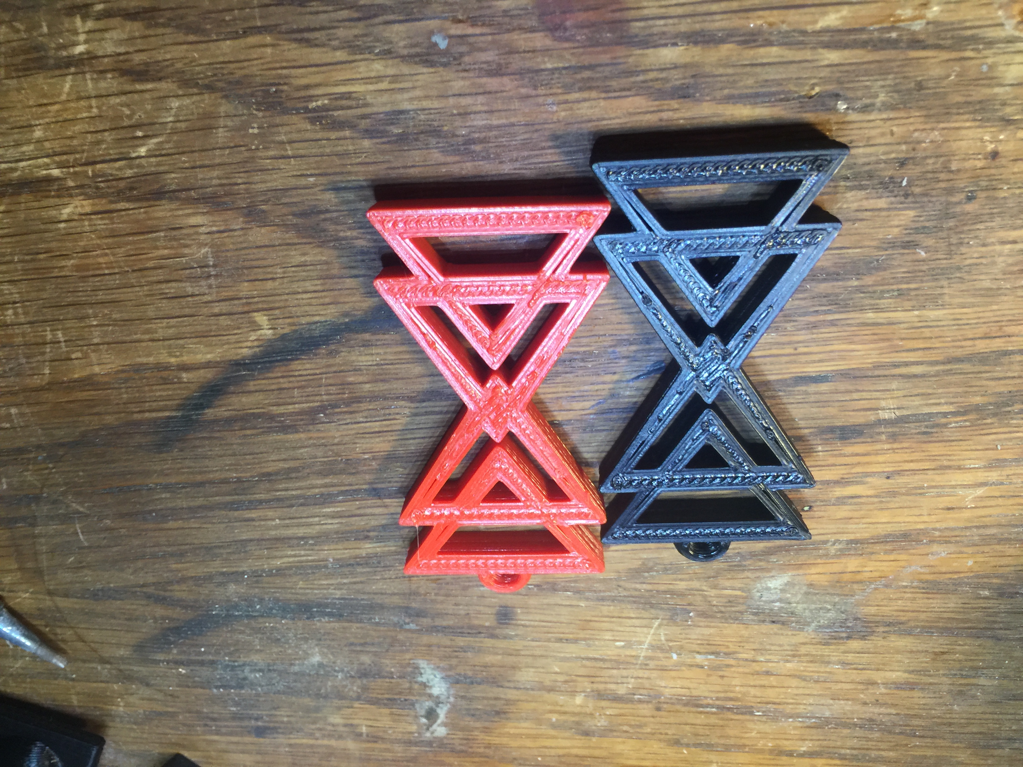

55.00 even
Some kind of alchemists neckless... I made 20 of them, 10 in red and 10 in black

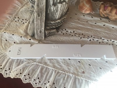

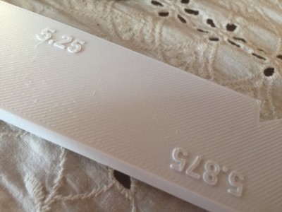

I had one for $20 the other day but it had a lot of flat surface features and I couldn't get the surface right for him so I gave him a refund. I think once I get the berdair up and running I'll reprint it for fun and see how it turns out... I had issues with pillowing, resulting in a rough surface
