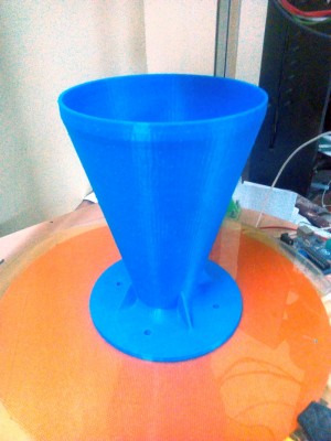

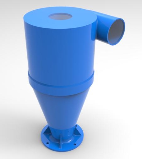

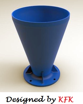

Its time to print cyclone separator for my CNC router.

Khalid Khattak
- Posts: 276
Re: Cyclone seperator for my CNC
Mr. Captain, You are lucky to buy from ebay..unfortunately i don't have paypal to purchase from ebay
.. here is the completed half portion took around 8hours...
