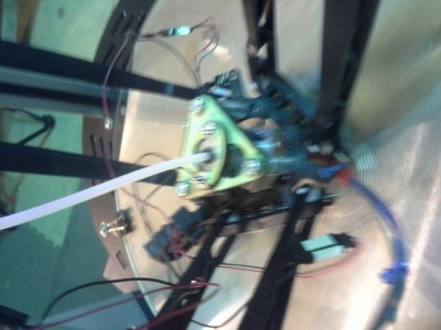

How you can see EZ Groove Adapter have a 4 screws.
I'm use 2 and don't know what to do with 2 others

Re: EZ Groove Adapter for Groove Mount Hot Ends
I don't think that these holes do anything anymore, and I can't remember what they were for on the original design...
[img]http://i.imgur.com/SlAaNJF.jpg?1[/img]
The important screw holes are the 3 for mounting, and the 2 with the longer screws for clamping the hotend in place.
Looks like a mount for a fan duct to me.
