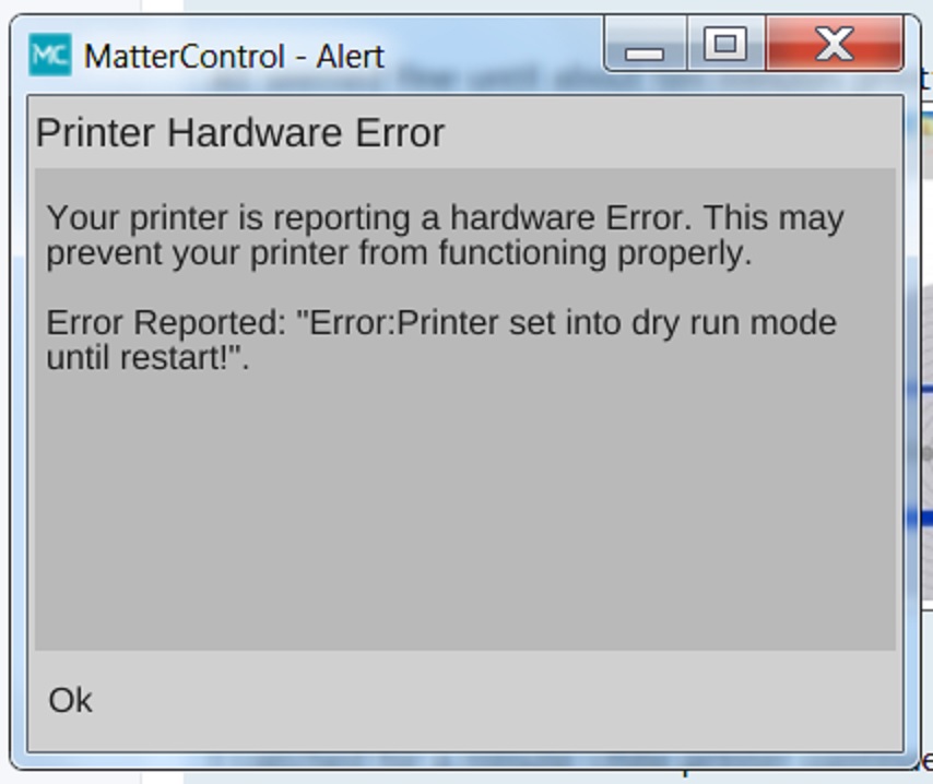

I turned it on, all seemed good. Loaded a file to print:
I am using MatterControl 1.5 (on a Rostock MAX v2).
Did all the necessary functions and started. The bed and extruder heated up to preordained temps and the machine began printing.
All seemed fine until about ten minutes printing when the window popped up (see picture for screenshot).
I watched for a minute while printer continued, and noticed no ABS coming from the tip. Dry Run, I guess.
And this also: I don't even know where to begin to hunt for the reason/problem.
Any help is greatly appreciated.

I'd say pull the board out and see what the resistance is on the thermistor circuits. Most likely, they're either shorted or open somewhere or the firmware has forgotten its settings.

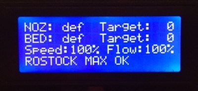

After writing that original inquiry I turned off the puter and printer. Just back home now I fired both up. The printer reads:
I'll keep it on for a while and see if it goes on the fritz.

Probably not the firmware at this point. Your short or open is intermittent. Trace the thermistor leads. Insulate anything that has any chance of touching metal and clean and secure all the joints.

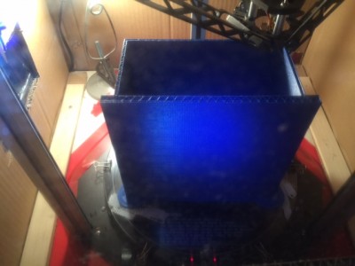

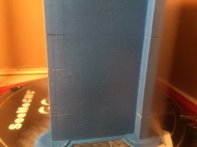

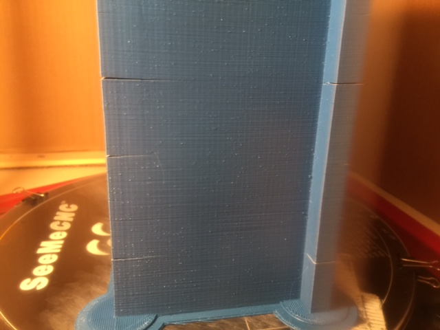

So...I printed (still printing, will be finished in an hour) my VERY large print. All was near-perfect last night. But this morning I checked on the progress and see the delamination. So bummed. All seemed to be going so well. I expected a few small cracks but they continue to grow.
I'll post again under "show us what you printed" when complete.
Q: should I increase the squish?
scooter it.
- Posts: 1407
Re: printer continues in "dry run" after hardware failure notice
ABS? You may have to go slower, or increase the temperature of the hotend. Just like welding metals,,, you have to bring the base material, in this case the previous layer, up to temperature to fuse with the new layer.

I printed a test calibration cube 2 days ago with no issues, now I've come to do another print today and am getting the same error and NOZ: def BED: def shown on the LCD display.
I've unplugged both the thermistor plugs from the Rambo board and they both meter out at around 145k ohms so I'd say they are fine, plugged them back in and still the error exists, to me this seems like a fault on the Rambo rather than the thermistors because I am still able to perform a PID autotune which proves the hotend thermistor is ok.
I'm out of ideas, bit disappointed really as I've only printed the peek fan shroud, a whistle and 1 test calibration cube
