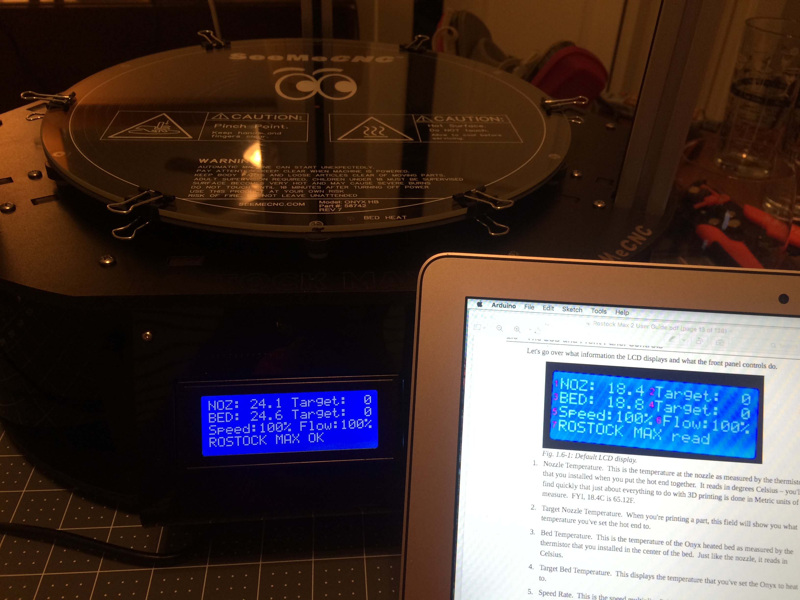

Thanks all! I actually remembered that I had a small marble game that needed some soldering so I used that as practice. Wasn't too difficult once I got the hang of it. Glad I had it as it gave me some confidence before launching into soldering for the Rostock. Good news is that everything is now built!!! And it was working great...was starting on the calibration last night when it shut down on me. Described that issue in another post and seems like I may have blown a fuse. Hopefully I can get that sorted out soon so I can start printing!

I do hope that you have this problem resolved with the fuse, this can happen if a wire touches something that it should not, check your connections, especially at the hotend.

Thanks. I ordered some new fuses yesterday and they were shipped today. So I can tackle this again next week after our company leaves. But I think the issue was with the fan wires that I didn't tie down or cover up the ends. The hotend had no issues with the auto tune process - it was only when I started setting the Z height that it went out. So I'm thinking those fan wires moved a bit and either hit each other or something else which caused the problem. So I'm going to make sure to take care of those before turning on again to hopefully avoid a similar issue.

Good news!!! I'm back up and running - so must have just been those lose wires for the fans that caused the issue. I replaced the two small fuses F2 and F3 and we are back up. So now on to calibration so I can start printing. Thanks everyone for the help!
