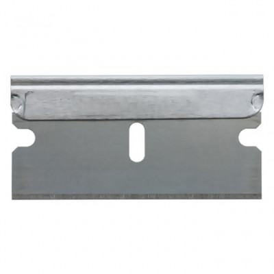

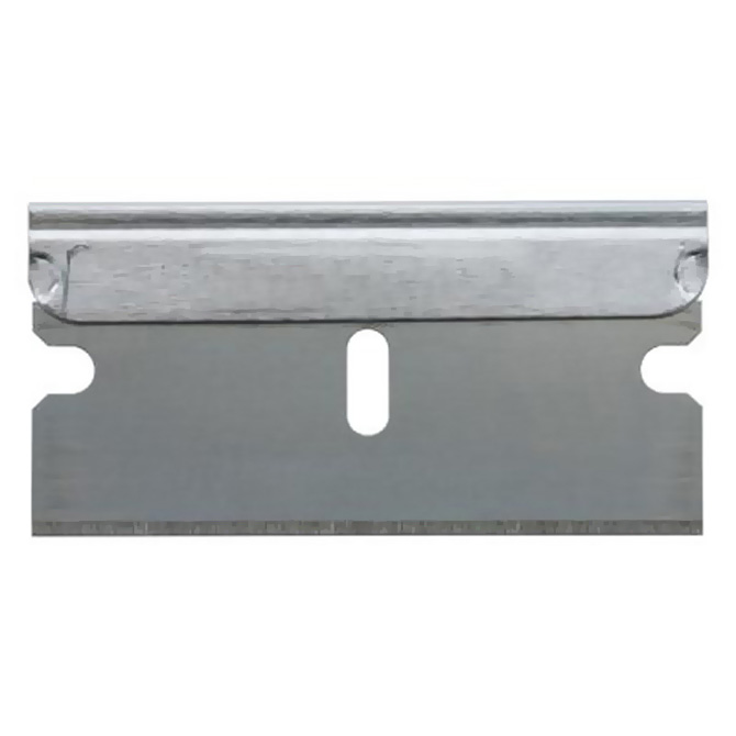

Re: Holding down the bed after mods?
What do you clean it with? I was trying to use my print removal tool, but it seems like it wants to stick into the pei and I'm afraid of gouging it...
Would one of those green scrubbies be ok on it?
- Tincho85
- Posts: 659
Hi, when something sticks really well, with this little guy.
It's great for removing brims.
Martín S.
- Posts: 622
I would think that would damage the pei, off to the hardware store
