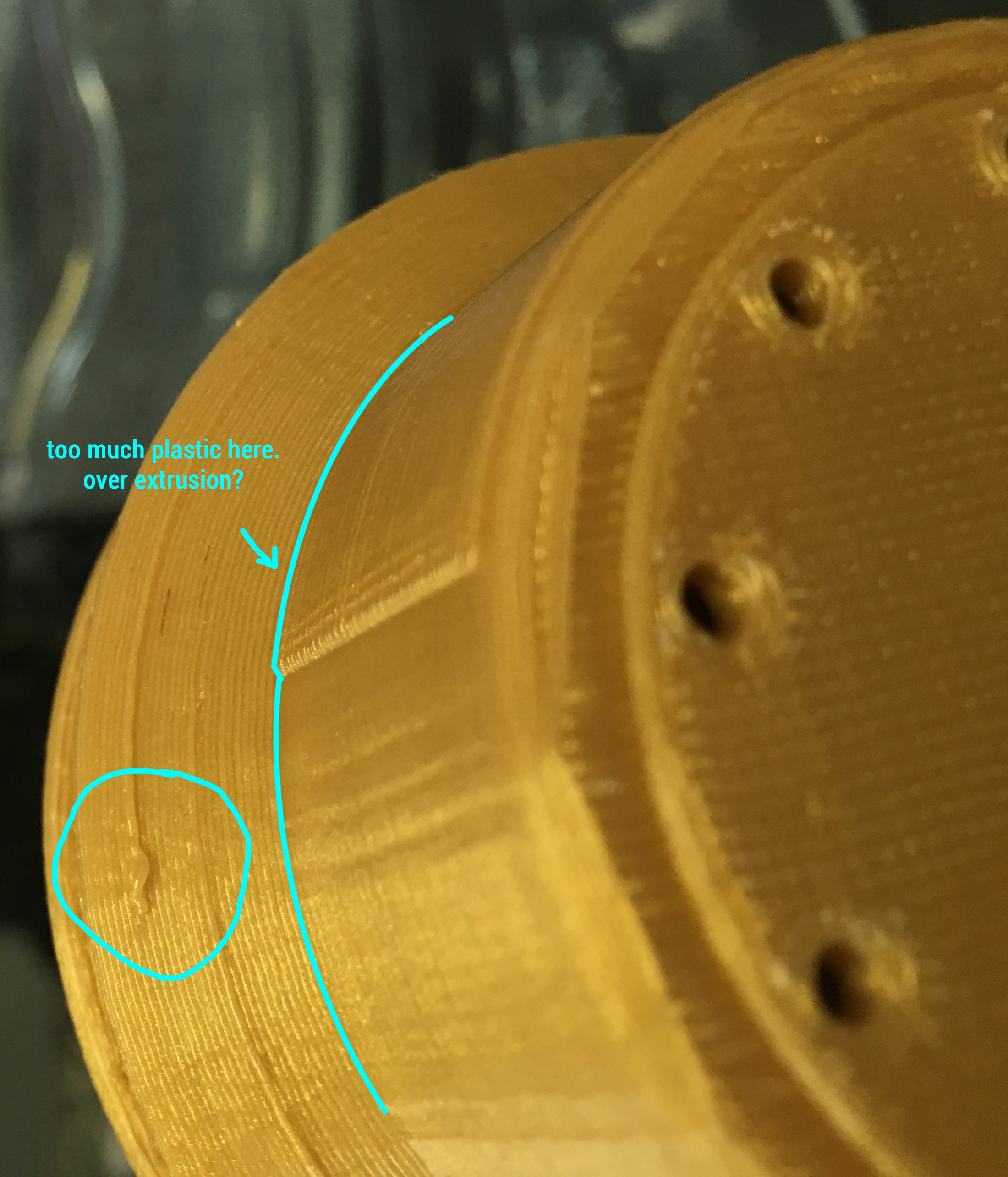

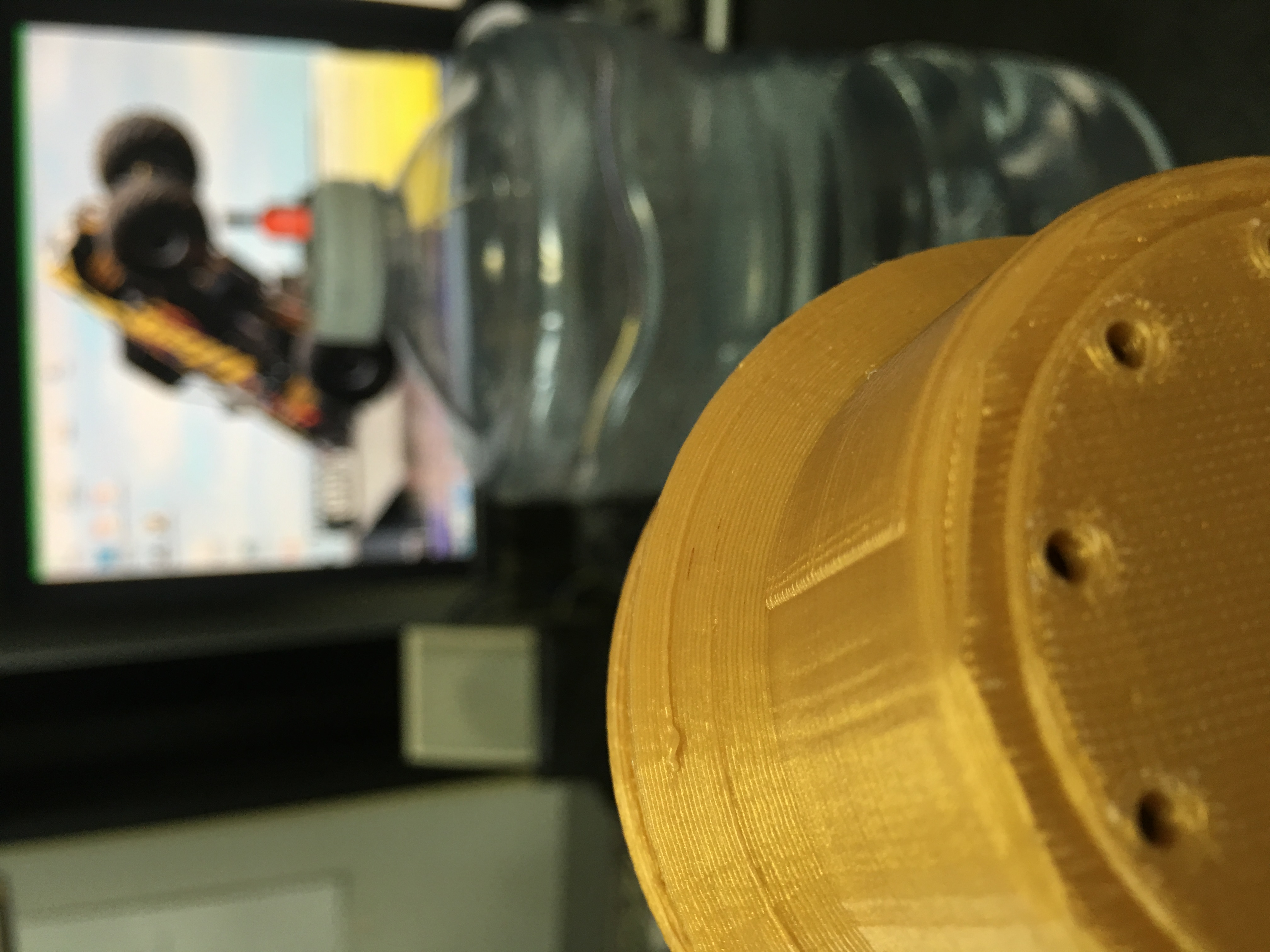

Hey new here with my 1st issue I've had and I'm pretty baffled i make custom RC wheels for monster trucks. My issue is that all of a sudden my Rostock v2 started printing like weird. It's printing this weird step on the inside and out side of the wheel only for this area same spot every time. What I've done so far resliced the part, check my z height and adjusted tightened everything down and checked everything so far any suggestion would really help thank you.

It almost looks like a polygon with multiple flat sides. Look at it with a program like NetFabb that will show you the facets to be sure.
Did you design the part, can you crank up the resolution that the program outputs? Most will let you define how many segments a circle is made up of.

Re: Printing out of round all of a sudden
Hello, for the blob check the "Blobs and Zits" section here:
https://www.simplify3d.com/support/prin ... s-and-zits
Great guide by the way, even if you don't use S3D.
The other scar seems to be where the print starts and finish the perimeter. Try adjusting your retraction speed and amount.
20mm/s is a safe value. Print a simple cilinder and see how it goes.
But... it could be a lot of things actually
Extruder not calibrated.
Over-extruding.
The motor is skipping steps when doing a retract.
Incorrect filament diameter.
Pressure built up within the nozzle, very normal with bowden setups.
EDIT> added picture

So quick update this was an update to wheel so I made the edge a little thicker than the previous ones I made. Also I went back and printed an early version which is the same but not at thick in the same area surprise surprise it didn't happen.

You won't get rid of the delta segmentation moire without going to something like a Duet board but it's not what OP is complaining about.
OP is complaining about the big (~.7mm) step in the periphery of the cylinder. It's so astoundingly consistent I can't help but think it has to be binding in the arms causing an offset only when that point is approached from that particular side.
Is this at the start/stop point for the perimeter extrusion?
If you're on a stock manual mechanical calibration you can move all the motor and endstop connections one position clockwise or counterclockwise (making each tower act like the adjacent one) and see if the defect moves. You can also move some or all of the mechanical parts among the arms.

You had it right with your diagram. Jim was talking about something else.
Is the outside diameter of the print that works the same as the outside diameter of the one that doesn't?

It was not the one that had the step was slightly thicker, I made a new model also adjusted solid works to a higher image making the circles less square and am re doing print now.

I was looking at this part of the object for my comment.IMBoring25 wrote:You won't get rid of the delta segmentation moire without going to something like a Duet board but it's not what OP is complaining about.
I think Tincho nailed the other part of it with his picture. Looks like overextrusion for those parts.

So after a couple of changes it was a simple fix instead of 3 perimeters I only did 2 this seems to have cured the issue. By the way doesn't anyone else hate the 1.5 update to matter control they got rid of one of the support material options and it drives me nuts! Glad I still had 1.3 uploaded
