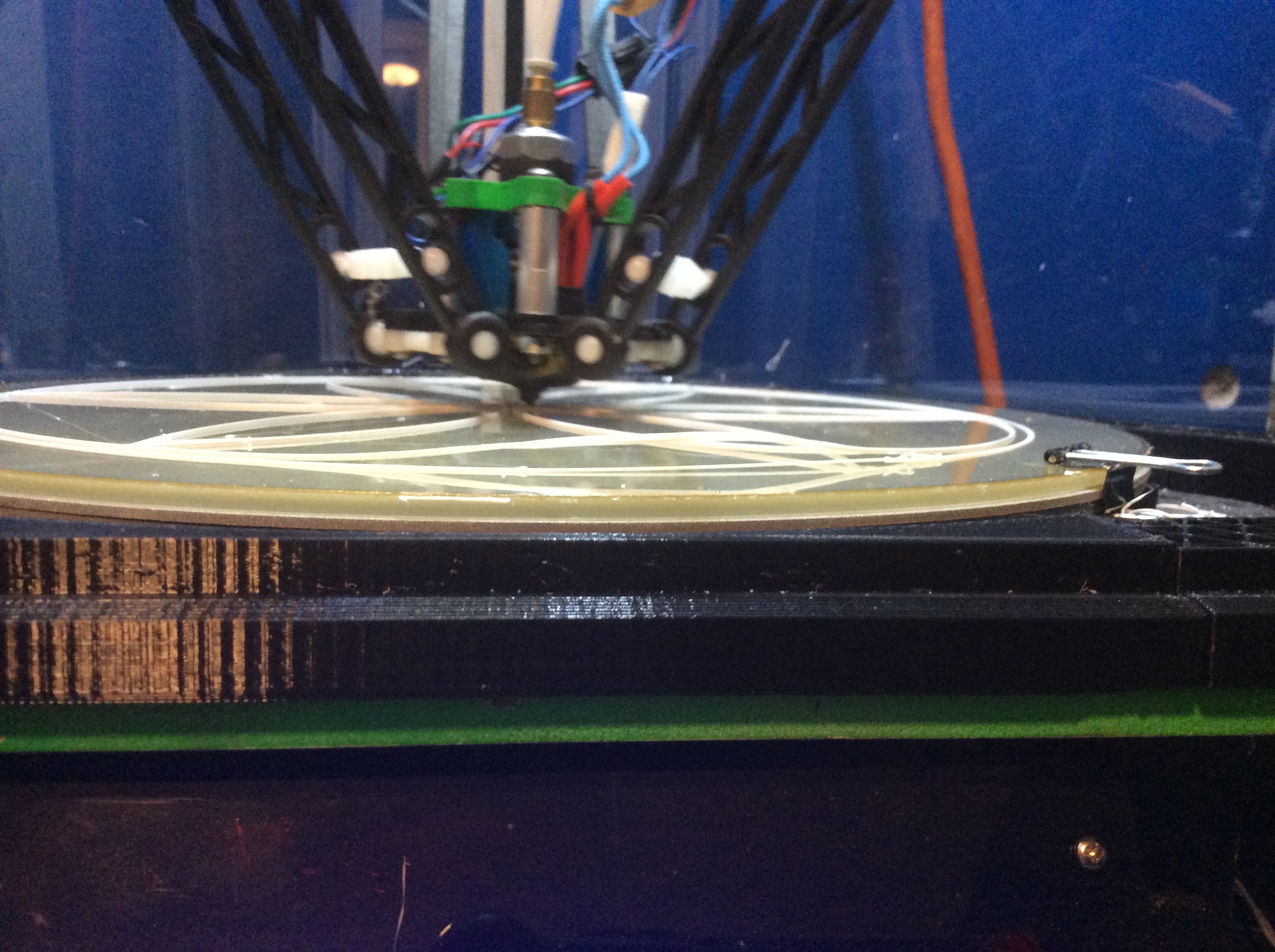

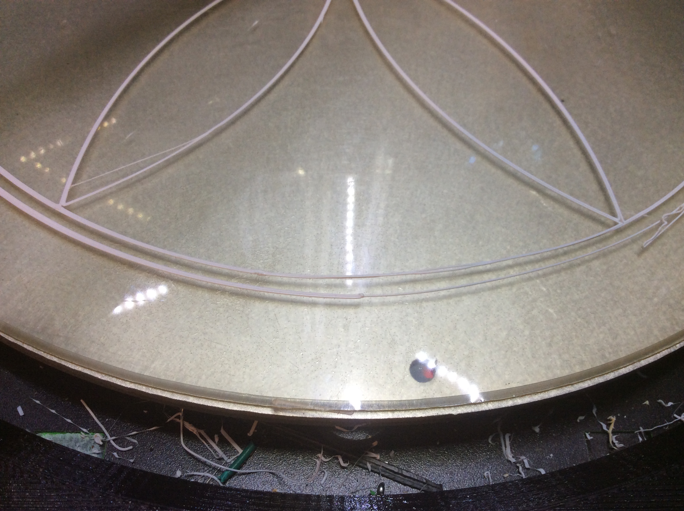

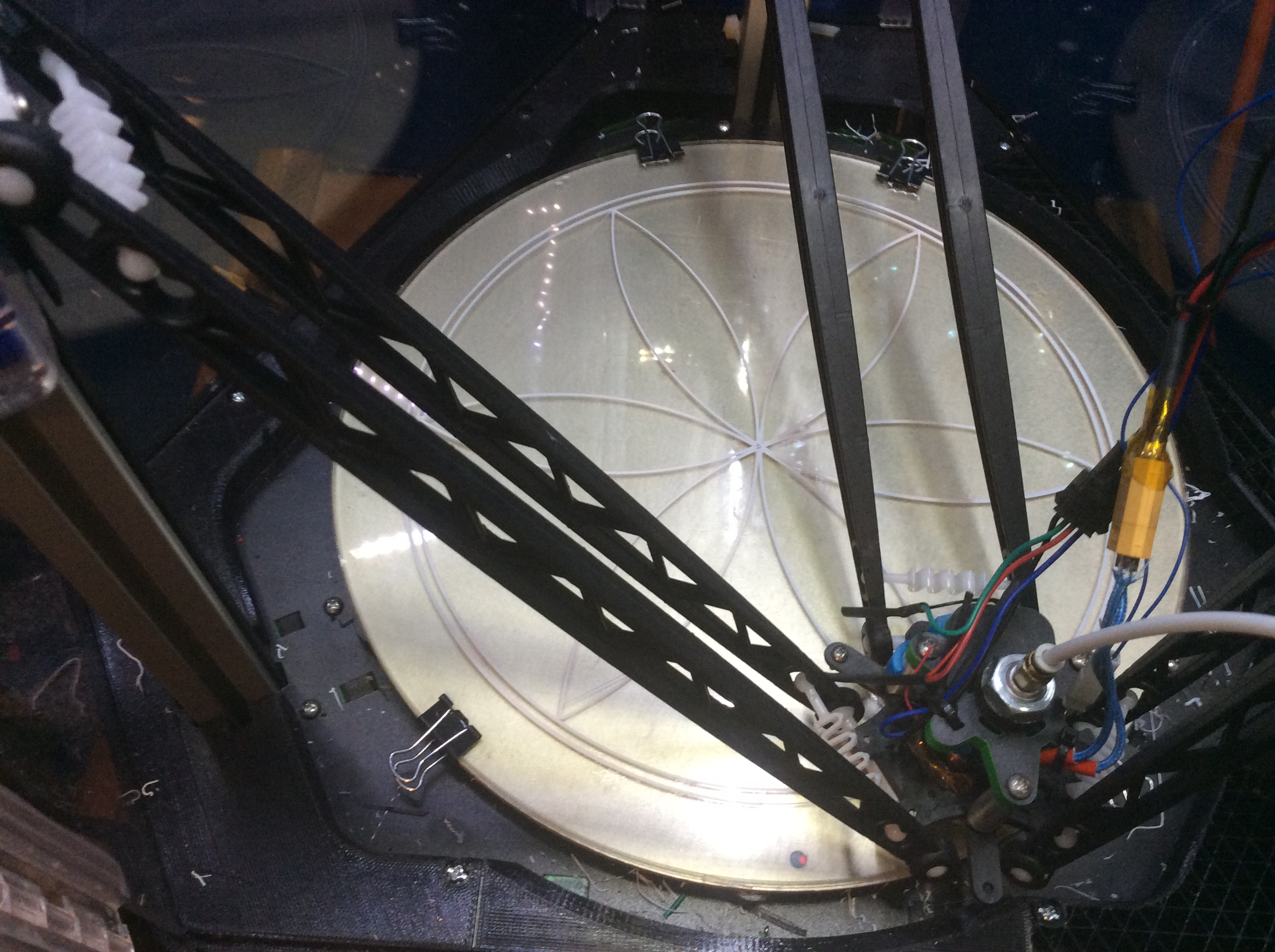

hello,
I am calibrating my printer without the screws, and I have been able to get a good test pattern print, however at the last 2-3" of the bed for about a 30 degree arc the extruded position is too high.
I'm not sure what to adjust because the height is fine at the x, y, and z towers....
pics included

I rechecked the squareness of my arms and everything looks square... my build plate doesnt look bent... its glass...

No one has ever experienced this before??? It's kinda what I would expect if the z axis was too far leaned back, but I've checked and it's at a 90..

Some suggestions:
1. From your photo it looks like the Bowden tube is going off in the direction where you have the problem. Is there any play in the joints? If so then the sideways force from the Bowden tube may be reversing in that area, taking up the play in the opposite direction, which causes the effector to tilt and the calibration to go out. The solution is to eliminate play in the joints, however supporting the Bowden tube from the top of the frame with a piece of elastic helps.
2. Try my online delta calibration calculator at http://www.escher3d.com/pages/wizards/wizarddelta.php.

Hi. Someone esle had mentioned your calibration tool before. I had some issues in figuring out where to put the tower angle corrections, but once I figured that everything looks flat on the first layer.
Still having some issues, but the first layer ain't one :)
