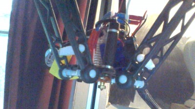

why is your nozzle so low down? It looks like almost a third of the nozzle length is exposed, which either means you have the heater block threaded too high up the heatbreak (where it necks down should be at the top of the block), which might explain why it has such trouble heating up, the nozzle too low, which would prevent reliable extrusion as there is a gap to fill with molten plastic, or too long a nozzle (Which is rather inexplicable, unless you bought Volcano nozzles with your V6 hotend)
Would you mind taking a picture of the hotend assembly as it stands?

This is the best I can do, I screwed it in as much as possible. I have only used the parts the were sent to me with the e3d. Im going to attempt to get it screwed in further. I am considering upgrading to the pt100 sensor. I am not using a volcano.

OK. I see at least two problems there. Firstly, your fan duct is not installed flush, meaning it's directing a large amount of extra air flow onto the heater block. Secondly, your heater block is up too high on the heatbreak. Go ahead and remove the hotend for the moment (Unscrew the lower set of screws right now, leave it on the mount so you have an idea as to clearances).
Then go ahead and get it warm enough to remove your nozzle. Then let it cool down again. lower the heater block until the entire narrow portion of the heatbreak is visible, then warm it back up, and insert your nozzle. Let it warm up the nozzle, and then make sure it's tight. The nozzle should have minimal length visible, and no threads. Then make sure your fan is on and in place properly, with the duct entirely seated. It should look about like so when you're done.
