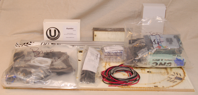

This is what the kit looks like when you get it. There may be some small packaging differences, but by and large, the image is representative of what you'll receive.
People that have built earlier versions of the Rostock MAX will be happy to know that there's no more RTV! The HE280 hot end has been updated to use a heater cartridge and that means no RTV is required on the hot end. As a safety feature, the HE280 has a low-temp thermal fuse attached to the heat sink. If there's ever a runaway heating condition, the thermal fuse will pop and kill power to the heater cartridge - it's wired inline.
No more running piles of wire through the towers! Because the v3 contains all the "brains" and motors in the top, there's only five wires to run now! 1 12awg black wire goes in the X tower, 1 12awg black wire and two 26ga white wires run in the Y tower, and 1 12awg red wire runs in the Z tower. One black & red go "up" to the RAMBo and one black goes "down" to the Onyx. The + terminal of the Onyx is directly connected to the power supply via a 700mm 12awg red wire. That amount of wire should make it very easy to work on the Onyx or power supply if necessary.
