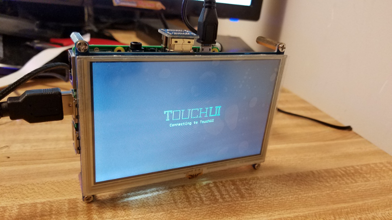

How-to: Set up a RasPi 3 with 800x480 touchscreen and Touch UI
Posted: Sat Aug 27, 2016 7:00 am
The point of this exercise is to get this up and running:

If that works, you're good to go with the touchscreen setup! The only thing left to do is to get the Pi set up to automatically launch a browser when it starts, and to load OctoPrint in that browser.

After this, you should see the same bootup screen from the screenshot above (with four raspberries at the top). After about ten seconds, the screen should go blank, as X starts and loads Chromium. Ten seconds after that, you should see this:
About twenty seconds later, you should see OctoPrint's status screen (machine status, file, timelapse, etc.) The tabs and menu are all at the top of the screen. Scrolling is done by dragging a fingertip or stylus up/down on the screen. You won't need to scroll much, if ever. If you use the on-screen terminal, be advised that the terminal screen itself is scrollable, and it can be a little tricky to scroll back to the top of the screen and access the different tabs.
