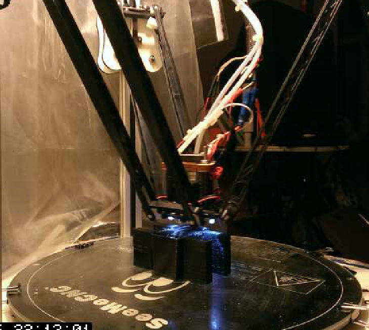

Here is a screenshot of my webcam stream, 18.3%

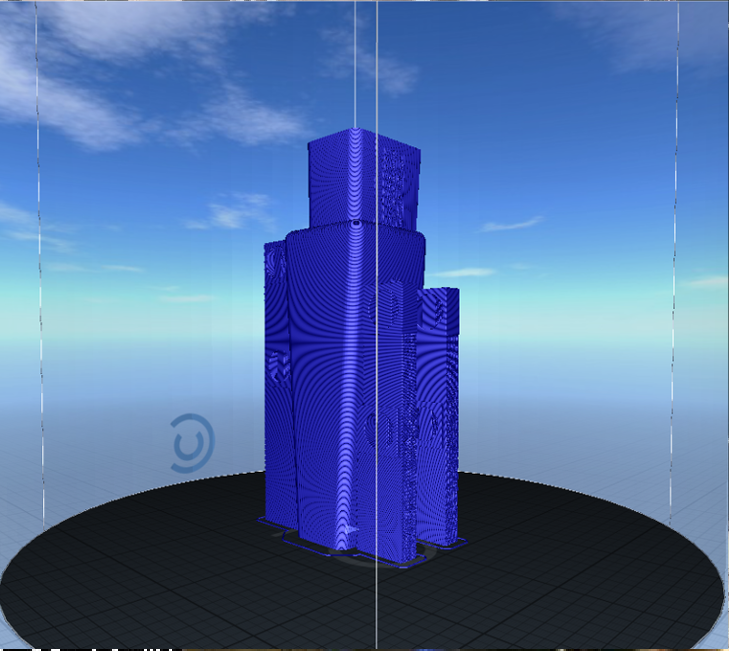

Here is the fully sliced file

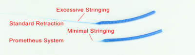

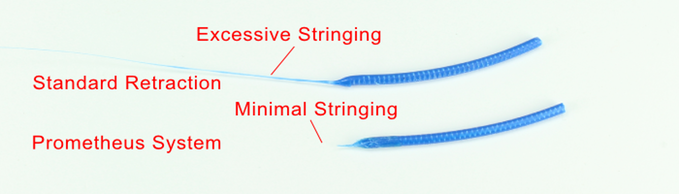

Wonder if your have debris in the nozzle. I can pull the filament completely out and shove it back in without jamming. Even the new Prometheus System relies on pulling the filament like 30-40mm to switch extruders(still uses the v2 hotend).
For the heck of it, heat to your printing temp and pull the filament out. What does it look like?
The goal is something like this.
